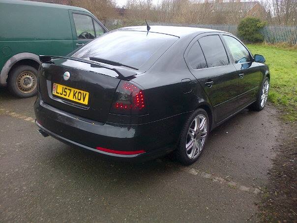

Octavia Hatch LED tail lights - now fitted
Anything is possible, to get all the LEDs to light up you would need an extra mini PWM and a little re-wiring, that way you could choose the brightness of the tail lights and then just apply the full 13v on brake or fog.
I could do it but this was just easier and still maintains the C, is there enough difference between tail and brake on your superb Chineese ones?

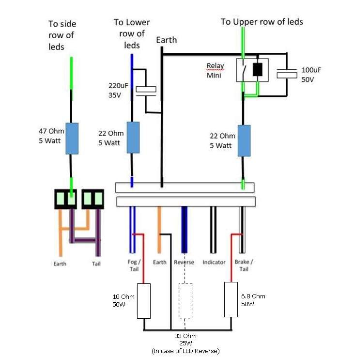

Hi there,
Below is version of this mod that I did in my car.
In case of stop lights there must be relay as capacitor and resistor - as I did for fog lights - do not disable all 4 diodes. Two diodes goes completely off but another two are still on, with less light but anyway.
To avoid to buzz by relay there's electrolytic capacitor in palarell.
Serial 5 Watt resistors are added to control brightness of tail lights vs stop lights and fog lights. In other words the reason why the resistors are there is to increase contrast and limit the current for LED's to extend their life time.

This is a little wrong if you ask me.
1) The relay as I have used - yes
2) The capacitor to stop the relay buzzing as you have used - yes (although if you get the right relay with a good internal spring strength the buzzing is almost unnoticeable)
3) The resistors in series - no
This would just reduce the brightness of BOTH tail and brake light brightness ultimately meaning the brakelights wouldn't be as bright as they used to be without the mods

I understand you don't like the resistors in series but really, they do not reduce the brightness dramatically.
And having capacitors in PWM circuit it is rather recommended to have resistors in series - this is simple averaging of PWM voltage...

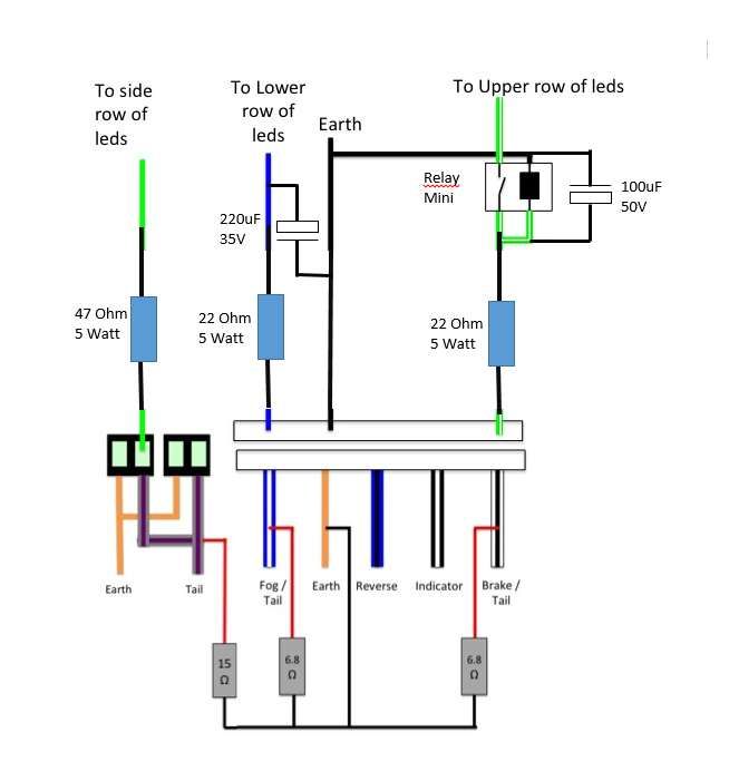

Final O2FL working condition with bit different CAN-BUS cancellers:
