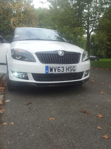

Heres my LED light in action, makes a huge diffrence! looks so much better than the yellowish previous bulb!
