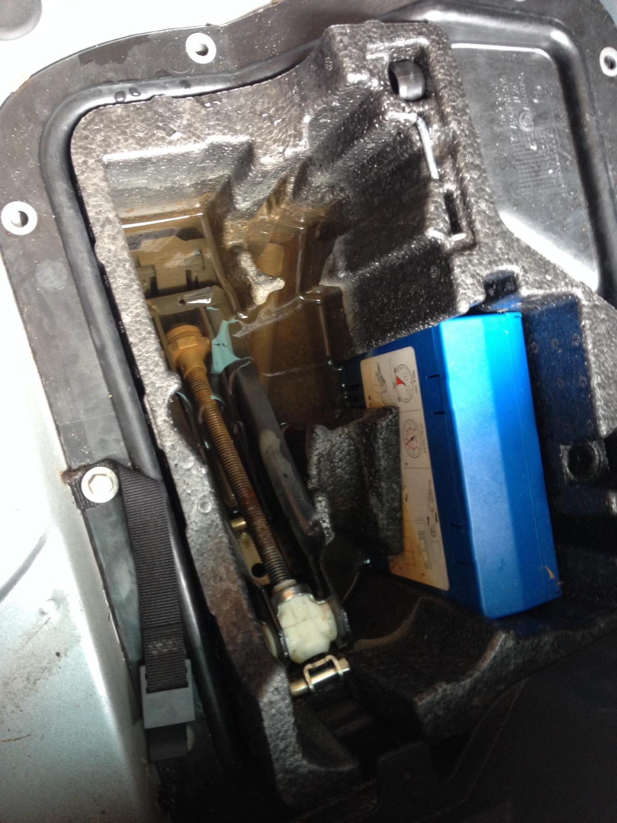

Argh. Ventured into my lowest boot floor yesterday - a place I hardly ever go to. And what did I find? Three to four inches of water with a third of the jack and compressor submerged and the tow hook and wheel spanner totally submerged.
Hmmmm. Ideas? Sunroof? I checked the teets above the hatch door and they were open with no water coming out bar a few drops.

The box mounts into a flange, and the rim is a couple of mm high, so I cannot see how water could flow over the floor and then into it. There is also a gap all around it. As said I checked the floor area around it very carefully, and could see no trace of any water at all, and my floor was quite dusty.
I haven't worked out what is below this box; (Tim have you got an exploded view?) If it is straight to the outside I wonder whether the seal around the rim might be weeping a little, especially as there appears to be spare "holes" around the rim. If it is "external" it is in the right place to be "blasted" by the rear wheel.

If its contained in that box then its come from above.. (obvious, I know...) so naturally id think sunroof or wash wipe pipe. If it was wash wipe fluid related it'd smell of wash wipe fluid, right? And why would the sunroof leak into the boot? In fact how could it leak directly into that box and leave the surrounding boot area and the boot floor carpet dry? (if im reading the post right?) Weird one and very intrigued as to the cause.

Odd it's leaked into the polystyrene thing, as you think a leak from a wash pipe or sunroof gutter would go along the side of the car, along the floor and go under that jack tray.

Most all the water was INSIDE the polystyrene box though some outside it too - I had to scoop this out with a cup.  Carpets and next level totally dry...  Peculiar.  And honestly about 3 to 4" so a good fair few litres of water!

Ditto, most of mine was inside the plastic moulding, but there was some in the bottom of the box; overspill perhaps?
And like Johann, nothing else in the area is wet or marked!
