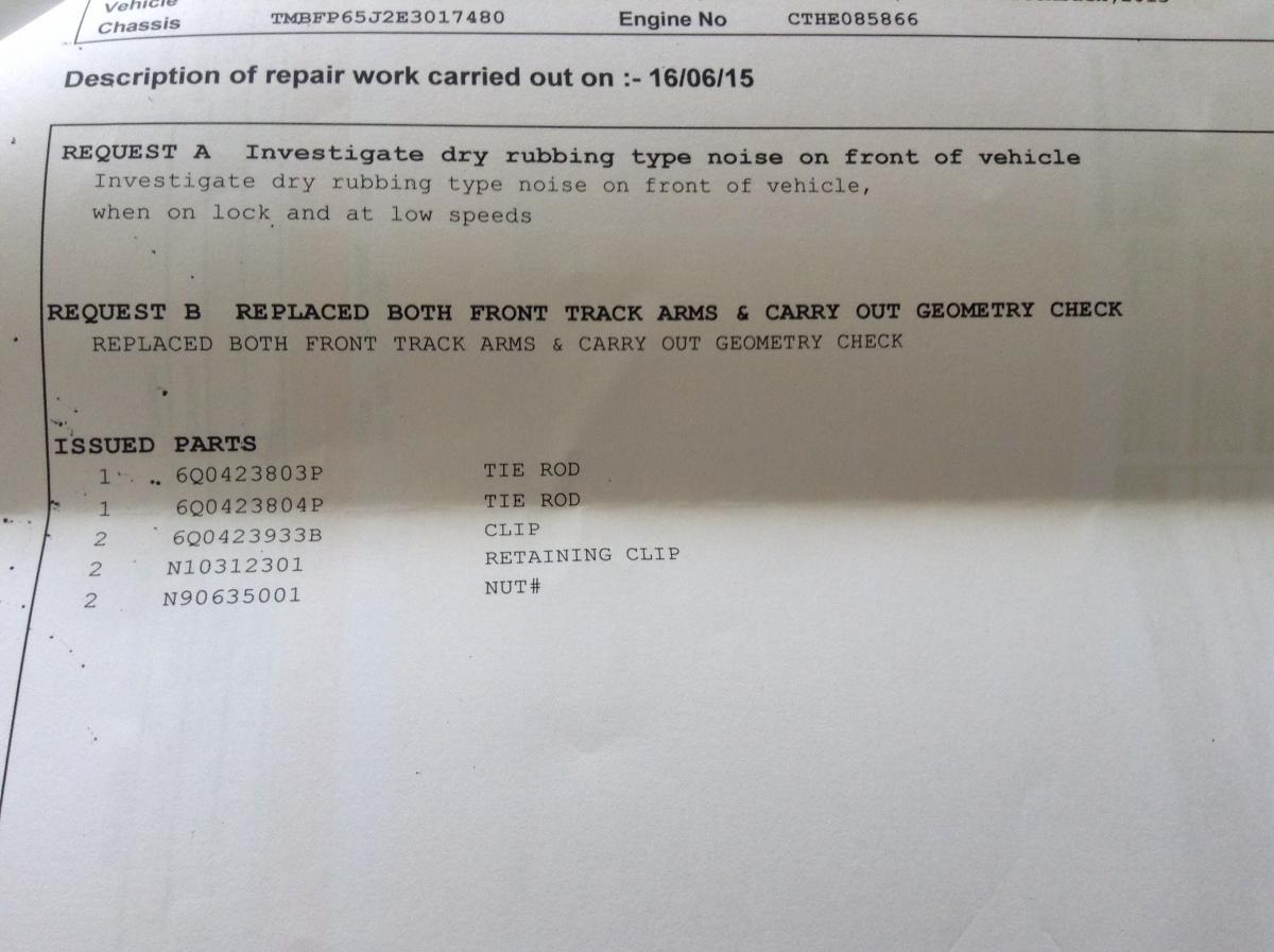

    Hi Guys   Thought Id bring this up as its turned out to be a serious (ish) issue. Had the Monte in for its first service last week and pointed this out to the technician. He said it was the inner st
  • A copy of the receipt of the work carried out
  • Just had my 13 plate montecarlo in for first service creaking from steering when turning right. They are going to fit new steering drumsticks this is the inside steering joints.
Update, skoda kept the car over night, needs track rod ends. Parts need ordering over night.

So lil update after a bit of driving, the car has had new track rod ends and new bushes. As far as my son mentioned, the service guy behind the desk showed my son a PDF that highlighted the issue as known by skoda on the mk2 fabia.

Did anyone get written proof that this work was done when they collected their car? My local Skoda dealer told me that because I didn't pay for the work (warranty did) then I didn't receive any written proof. Was just to put in the service history, but the dealer could look it up with the VIN number on a computer system.
Your car, your responsibility so ask the Warranty Provider that paid for the work to send a copy of the Invoice for Parts & Labour,
It is not a Data Protection Issue, you can see the Data they hold on you and your car.

Had my track rod ends done on Weds this week - noise from 3,500 or thereabouts and work done at 6,000.  They (Blade Bristol) gave me paperwork for the work carried out without me requesting it.
