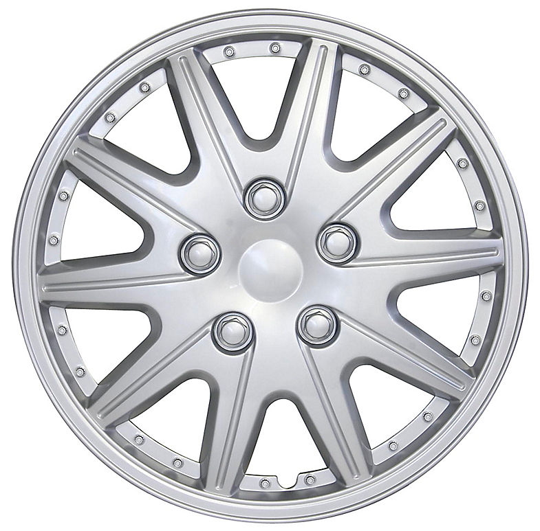

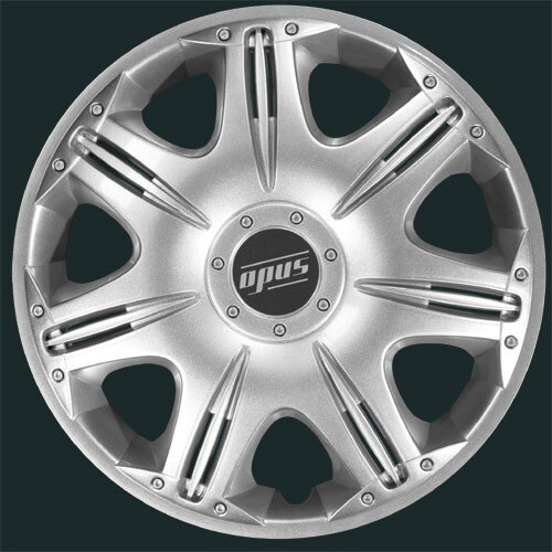

I just need to decide on what wheel trim I want! Thoughts on these 2?
