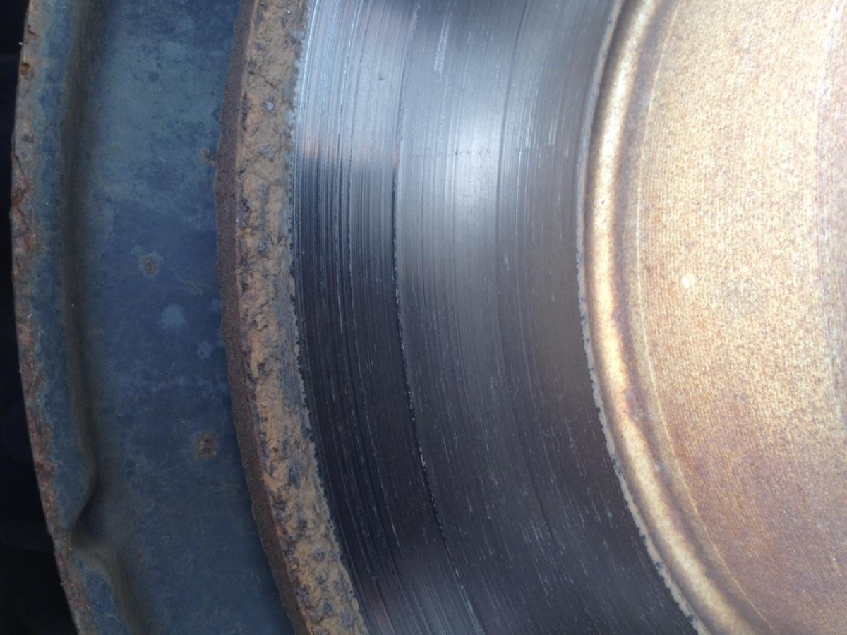

I know I am resurrecting an old thread, but I have a similar issue and am not clear on the exact problem despite having read a dozen threads about it on this forum.
I have about 12 mm of rust around the outer edge of my rear discs (Bosch callipers) despite the pads actually covering the full width (to within 1 mm or so) of the metal. They passed the last MOT in April like this so not concerned about that, but am concerned that it will only get worse if I do nothing about it.
Does this mean that the callipers are sticking and that I should strip them down, clean and regrease them?
I've no issue with doing this as I have done so on my Octavia, but want to make sure that this is the problem before I go about taking them apart on the Yeti.
Whilst the calliper and pads are off the vehicle, should I look at getting the discs skimmed to remove the rust or will this disappear fairly quickly once the callipers are sliding properly (assuming that this is the problem?

The callipers will hold the pads in relation to the centre of the hub so as long as they are sliding OK it will not make ant difference to the pads position on the disk.
If cleaning the carrier to help the calliper to slide do not use any grease as it will attract grit and you will have more wear than leaving it clean and dry.
The bit that does the sliding where the calliper is bolted on should not want re-greasing if the bellows seals are OK.
I do think that the pads are sweeping a few mm towards the centre though, but if the pads are correct and fitted OK the only thing that can change that is calliper or carrier.
Its safer and probably cheaper to fit new disks rather than have them skimmed, or gently tapping at 45 degrees to the edge of the disc with a lump hammer will remove most of that rust then just clean it up with a file and wire brush to reuse if within service limits that should be stamped on the disk..
Thanks for the advice.
The discs are well within limits of thickness and I believe the pads are as well although am not certain.
The outer pads, the ones I can see through the wheel, are within a millimetre or two of the edge of the disc, so are in the correct position, but are obviously not pressing hard enough on the discs to clear the rust or to grip.
I have noticed the rust spreading slowly inwards so I think I'll strip down the calipers and see what's what.
