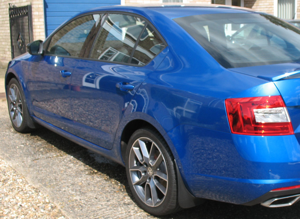

I would like to put mudflaps on my white hatch (especially in the rear, lots of spray there) but the (un)looks of them still outweight the functionality :D
They have been on my Vrs estate for months now. Only really remember I have them when I wash the car. And they are essential now that I work at a large steel complex where water drains are non existent.
I concur, they do a good job of keeping the crud off, and I don't think they look out of place, I don't even notice them.
