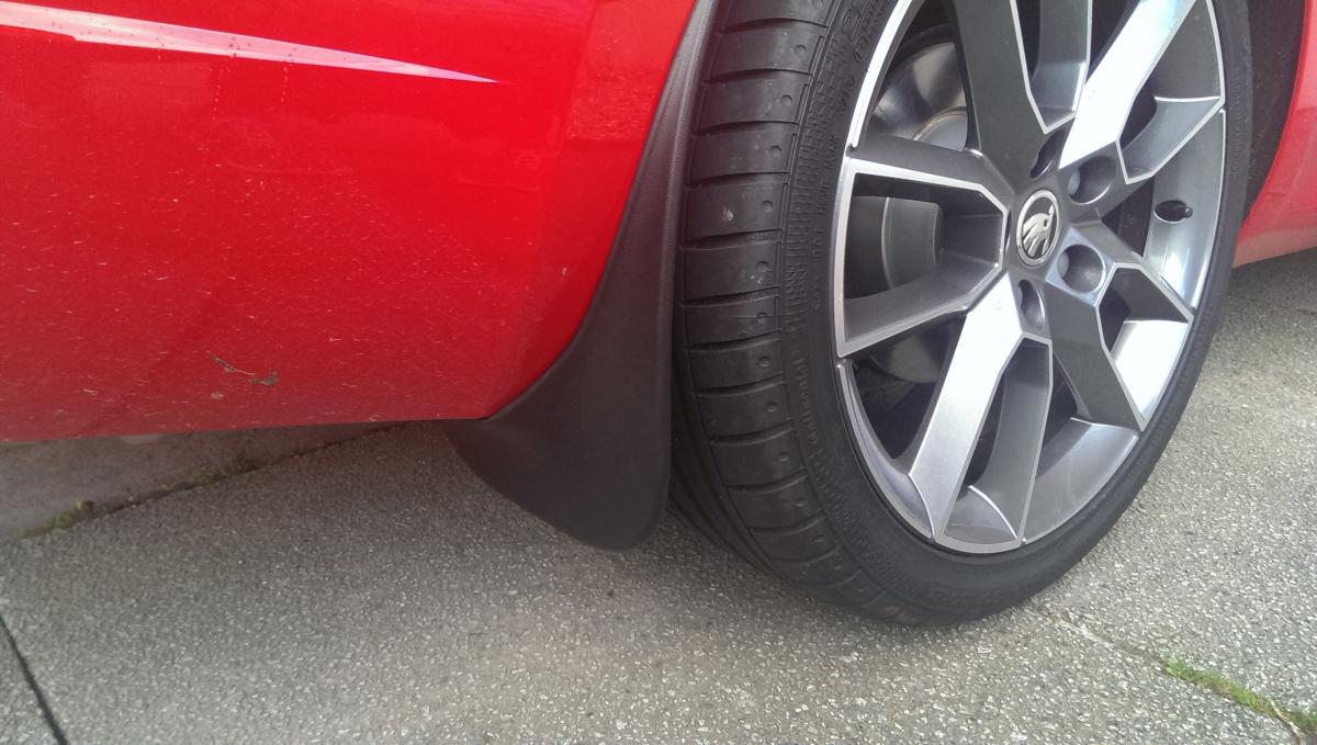

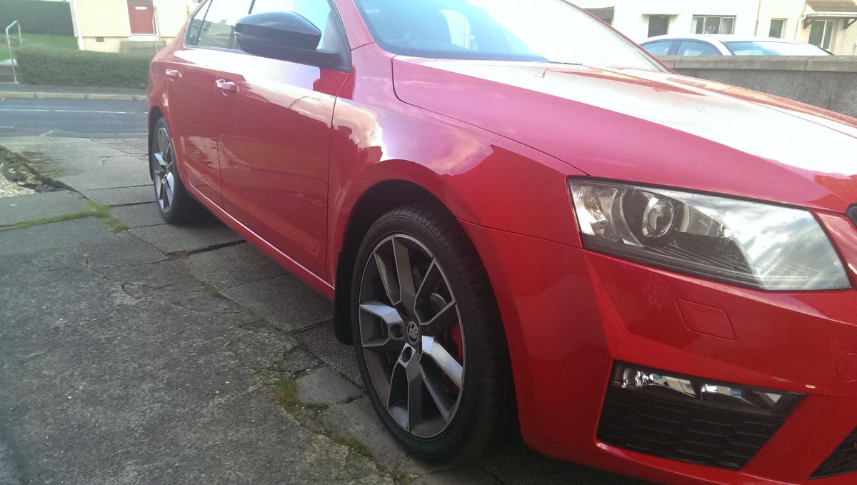

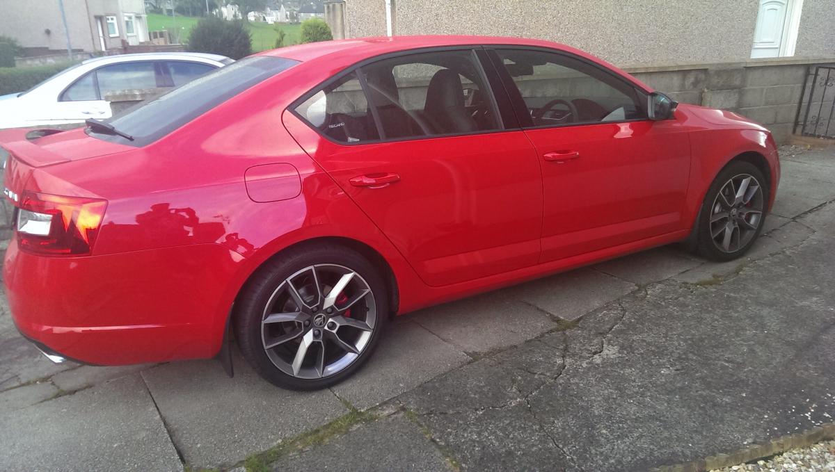

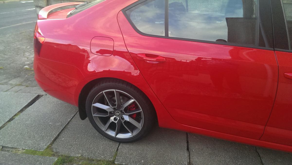

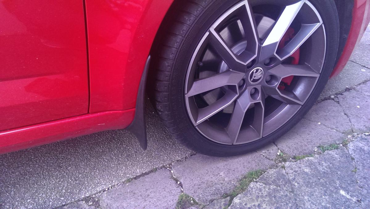

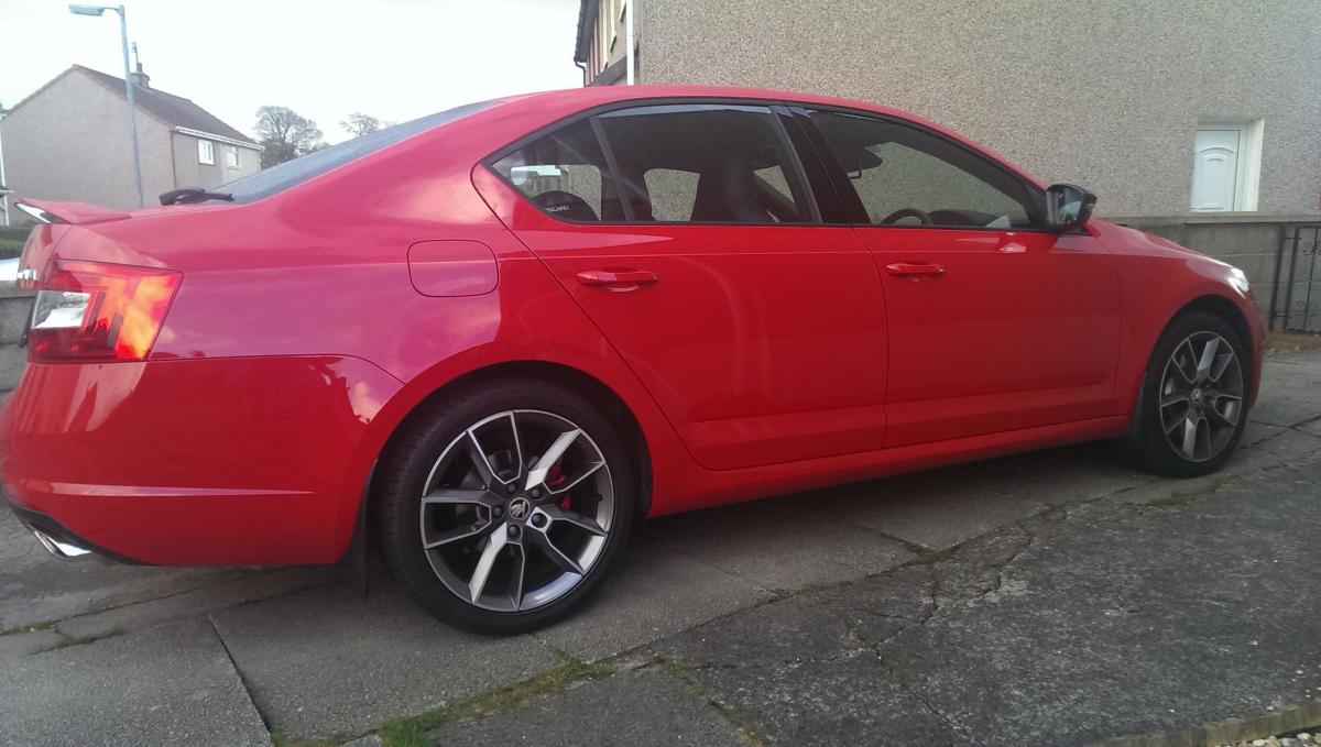

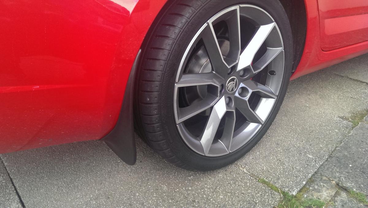

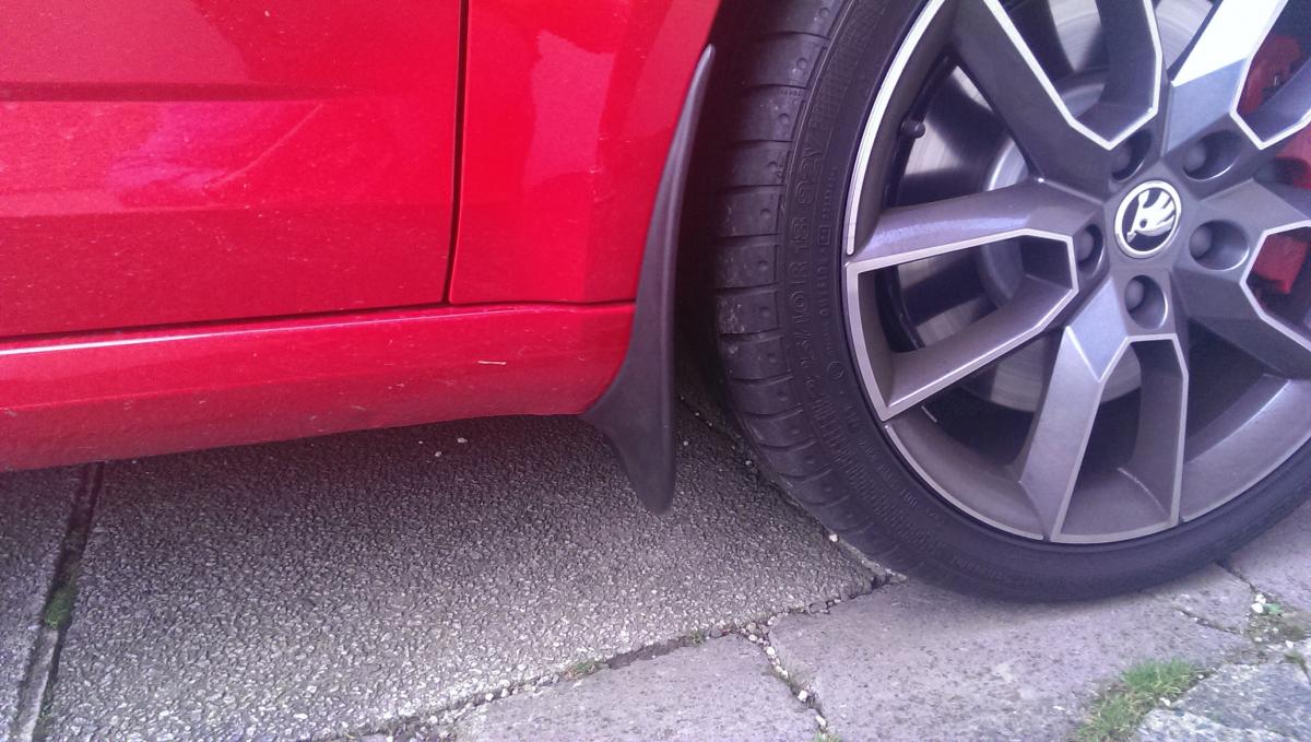

Here's some pics, not the best (taken on phone) but gives an idea of what they look like............don't worry about the splashes of dirt etc on the sills and rear bumper, that was before the flaps were fitted, I'll get her washed tomorrow!
Cheers Ricey. Look well on the red, not sure how well they would look on my blue one.

Here's some pics, not the best (taken on phone) but gives an idea of what they look like ...
Pictures are good - thank you.  Car looks great in red - I can see why you would want to protect it!.  And mudflaps look fine; best compliment is to say that you don't really notice them.
