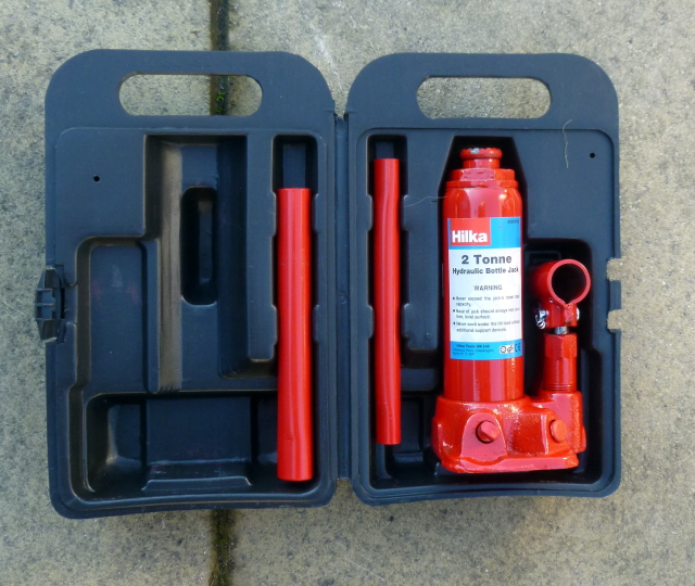

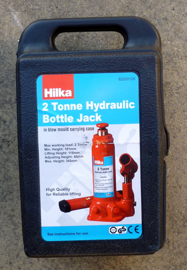

I have now adopted Dan 's suggestion & bought the Screwfix jack. I was a bit apprehensive at first as the cross sectional are of the the part of the jack that makes contact with the jacking point of the car seems small. In practice, it wasn't a problem. Neat little package in its plastic case & no problem to stow. Amazing value @ £12.95
