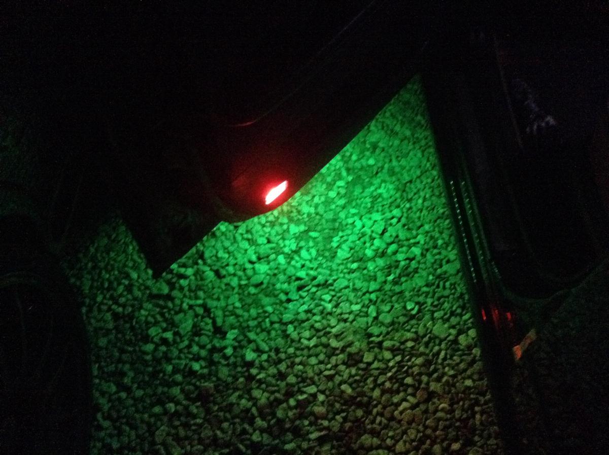

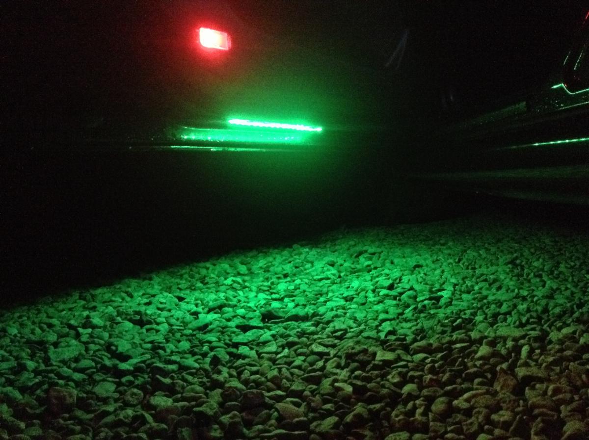

bought some white led strips off ebay for a couple of quid after deciding to tap into to red lights in the door card to make 'puddle' lights.
parked in a multistorey to test them this morning after fitting.

they are mounted on the bottom of the door pockets on the little lip they are held on with double sided tape so il have to see how long they stick or i might use a bit of silicone to hold them on. they cost about £4 on fleabay for the pair.

took about 5 min to wire up each side, drilled tiny (3mm) hole in bottom of door card to feed wires through then tapped into the existing light wiring.

I just popped out the red light thats already there to access wiring then drilled a 3mm hole under door card so u cant see it and thread the wires through.
