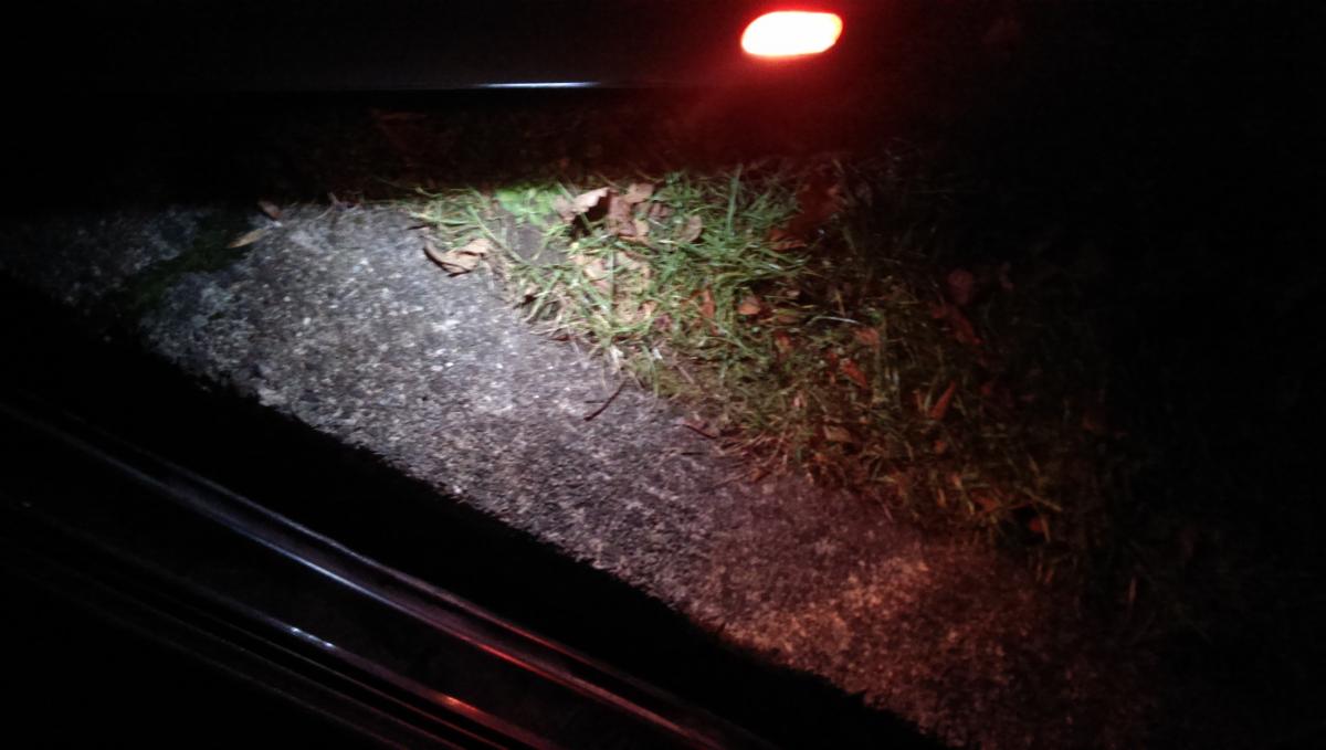

LED 'puddle' lights
Great mod! Well worth the £££ to ensure feet are kept dry this winter :)
Would this be the same for the rear passenger doors too? I can't (off the top of my head) remember if the rear doors get the same light in the door card. Also, could the wire be fed behind the door card easily too? If I can avoid drilling any holes in anything I'd rather go down that route.
Although the rear door don't have lights, no reason that you could not take a feed from the wires in the door loom. I may do this as like the idea of all doors having puddle lights.

Right update.
Found my left rear door was triggering interior lights so how long the right has failed i have no idea.
I have recently replaced rear right door loom as remote was failing to lock/unlock so perhaps something happened then.
Ok so today I had a spare rear door mechanism so fitted that and hey presto the interior light is now working both sides. Dam door micro switches again.
With door doing what it supposed to do i set about seeing how to get puddle lights working.
And i managed it so well  chuffed.
Will post up some pics tomorrow and add to the diy guide I did in techi section...

Awesome - looks like a spaceship now :D
