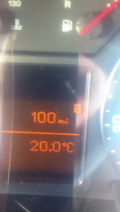

I always use supermarket diesel and I regularly see 60 mpg.
On a careful run a got 82.2 MPG from my 1.9 Superb, so I doubt supermarket diesel is the problem.
http://i36.photobucket.com/albums/e27/Alan16ac/8b0d2d18.mp4
