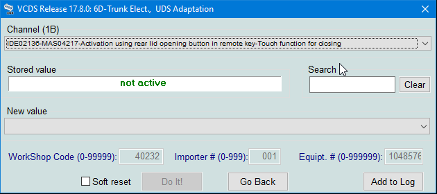

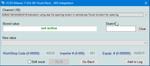

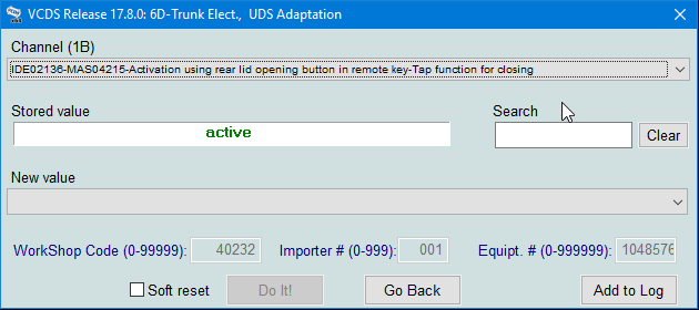

On 27/12/2013 at 16:33, andyvee said:
Tried this today, and it works on models with the automatic tailgate option.
This will enable the automatic boot closing from the interior button and the remote keyfob.
Go to Controller 6D - Trunk Electric
16 - Security Access - enter 12345
10 - Adaptations
Change as per the below screenshots

I tried this but that option wasn't the list, any ideas? Thanks in advance

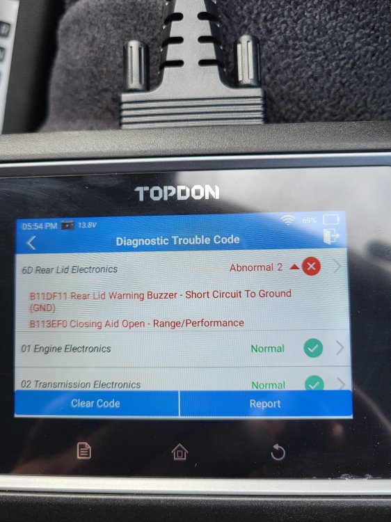

How to enable the auto closing in a skoda octavia estate MK3? What about these 2 error codes?

Your rear buzzer which produces the beeping sound for the parking sensors is wired incorrectly or damaged.
I see, thanks. Where is that buzzle located so I can check? An what about the Vlosing Aid "open"? Can it be the cause of the parasitic drain?
