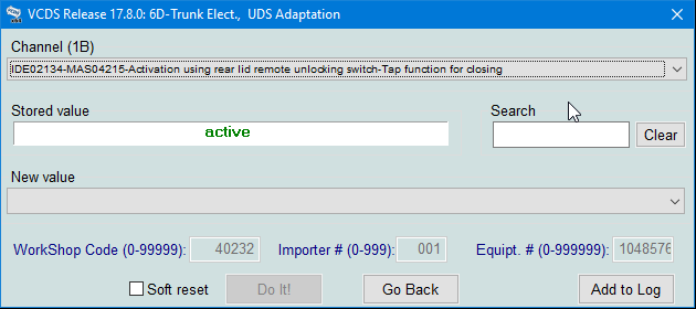

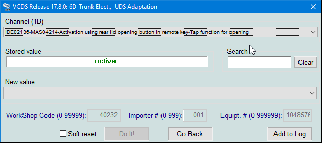

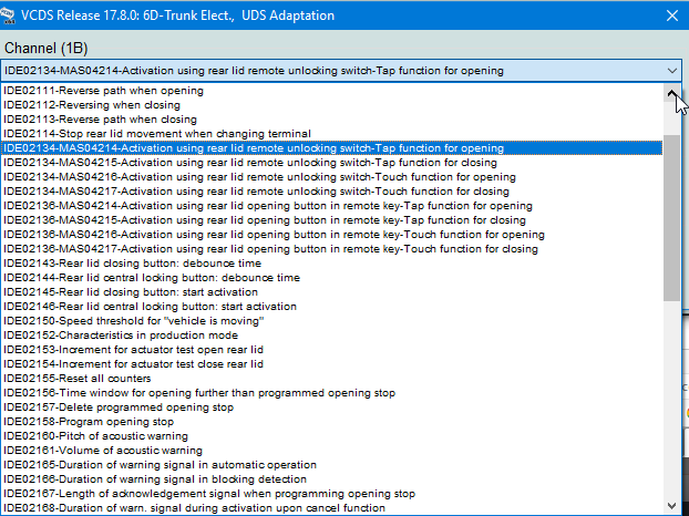

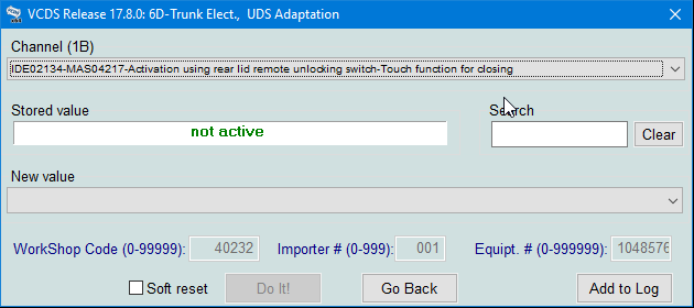

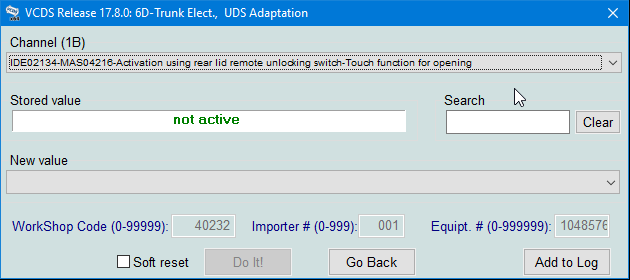

On 01/02/2017 at 20:39, Riolux said:
Yes.
1. After connecting, go to control units (green "hamburger menu" button)
2. Go to Deck Lid control unit (6D)
3. Go to Security Access, enter login: 12345 (check that it is accepted)
4. Go to adaptation
5. Select "Activation using rear lid opening button in remote key"
6. Set "Tap function for closing" to active
7 Click the green check icon and check that it is accepted.
8. Do steps 5-7 but for "Activation using rear lid remote unlocking switch".

On 07/02/2017 at 19:58, mpooleman said:
Forgive me being a beginner - I did steps 1 to 4 fine bit there was no option for "Activation using rear lid opening button in remote key" or remote unlocking switch.
Any ideas?? I have an SEL Exec with the power tailgate. I did manage to turn off the beeps though.
Closing the rear boot from keyfob and internal switch cannot yet be coded on the Superb Mk3.

With vcds 17.1.3 can not be performed on the Superb 3v ??? Only with VCP ??
Edited by YuRkLi
Correct VCDS cannot do this,
VCP needs to upload a new file to the controller.
If you look at the VCDS owners map in my signature there are a few of us who also have VCP.
The closest is from Barcelona that is of me at a distance of about 660km. Of home .... a shame that vcds can not .... for little more than to reset the oil changes will serve me xDD

Hello Team,
Today I've tried to configure the closing thru internal switch and remote key. Followed the provided screenshots as in this thread, but without luck.
It's now working with the internal switch, both opening and closing by short press on internal switch.
However by remote key, only closing is working, not opening.
Before the changes, I was able to open thru switch and remote key. Closing was not possible.
Anyone any idea what could be wrong?
Many thanks in advance,
John.

Hi I can’t find this on VCDS under these sub folders. I can get there and there’s a massive list but none of these.
Yes i I have vcds and electric tailgate.
Vcds 19.
