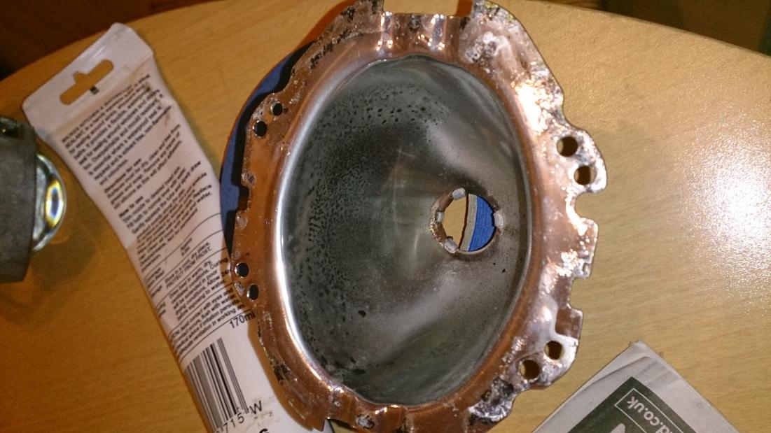

Hi,
I had a problem with SWMBO's Punto - while not a skoda, it does have xenon projectors.
We found the cause to be the bowls (silver back bit) of the projector lights to have corrosion and hazing, they almost looked burnt.
I had to replace the projector bits  - as I used to own a punto the same I had a couple of spares laying about (as you do) so not a problem.
This is what the insides looked like...

Hi,

Holy guacamole!  That's unfortunate  :S
Fortunately for me, mine aren't anything like that.  Shocking!
Glad you got it sorted, though.
