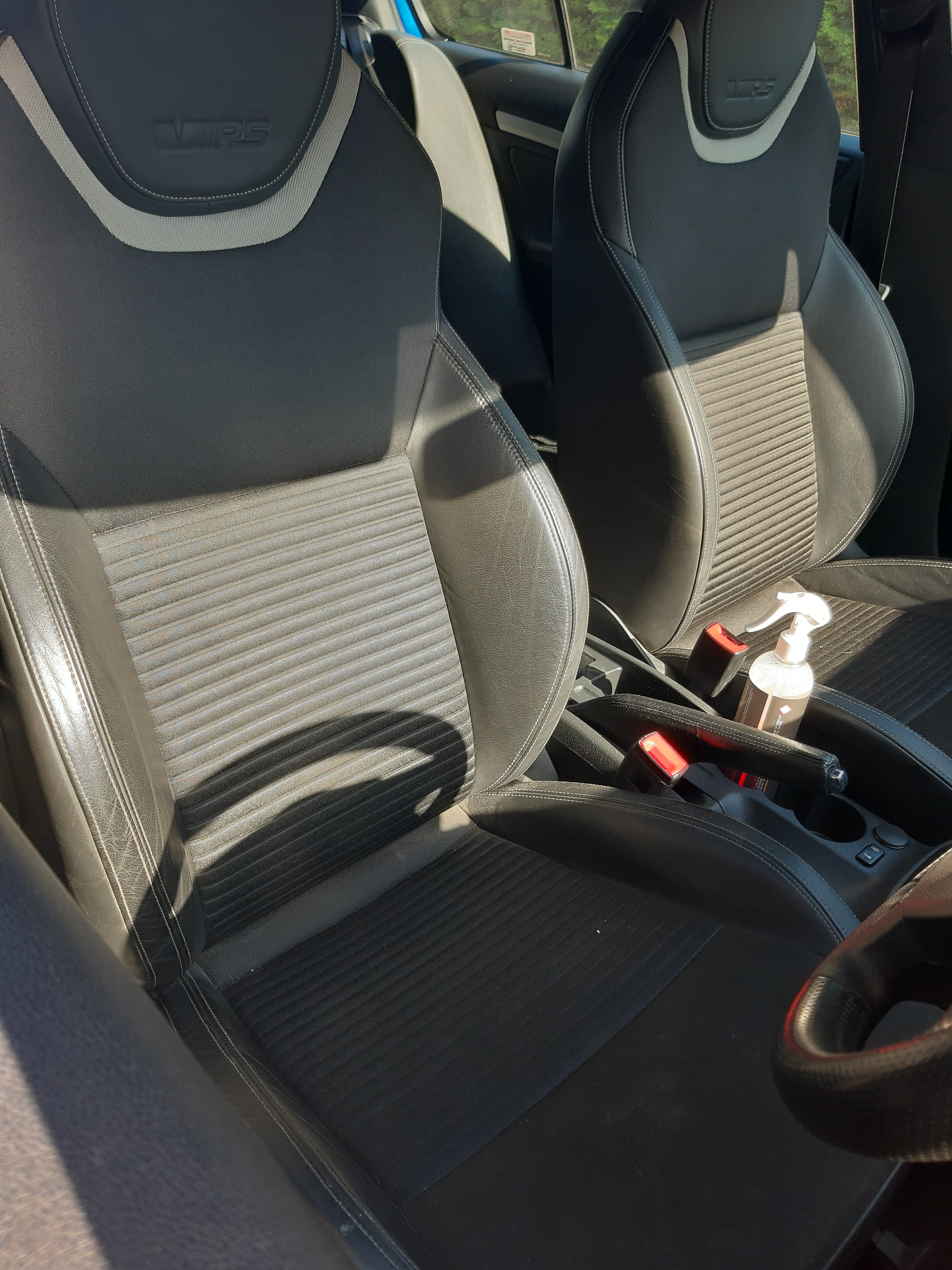

2013 vrs interior in my mk2 vrs.... Yummy! Pics inside!
Nice mod buddy looks very good the red trim on the seats goes well with the colour of your car. Not quite sure I'll be willing to invest what I imagine to be a small fortune on a new interior as I quite like the standard one in my mk2 pre FL. That said without people like you who are willing to try doing things like this the car modifying world would be a very dull place. There are too many people out there not willing to accept that people like different things. The way I see it is it your car, money and time so keep doing what your doing and I for one will be keen to see how your octy progresses

On 15/01/2014 at 22:41, _redders_ said:
So theses came up on ebay and I snapped them up, paid a small fortune for them, wasn't even sure they'd fit....
The front were a direct swap, I had to swap the air bag plug but that's it, the drivers seat belt indicator was the same, these are heated but ill need to find someone breaking a mk2 with heated seats and I'm confident I could have them working too.
The rears wern so easy, anyone who has removed the rear seats will know the uppers are mounted on a single pin, one at each side, and in the centre there are 2 rollers, the new seats mount exactly the same way but the peg is much thinner so I simply had to file the original pegs down, then the pretty much dropped straight it, and with a little swearing the side "cushions" went in too.
The base however does not fit at all. It's one piece and is around 4" thicker, I have 2 realistic options for this, fit a octy mk2 bench that is somewhat close looks wise, or take the new bench and the 60/40 old bench and have the new cover, "made to fit"
Anyway, here's some pics, enough talking, here's some pics...

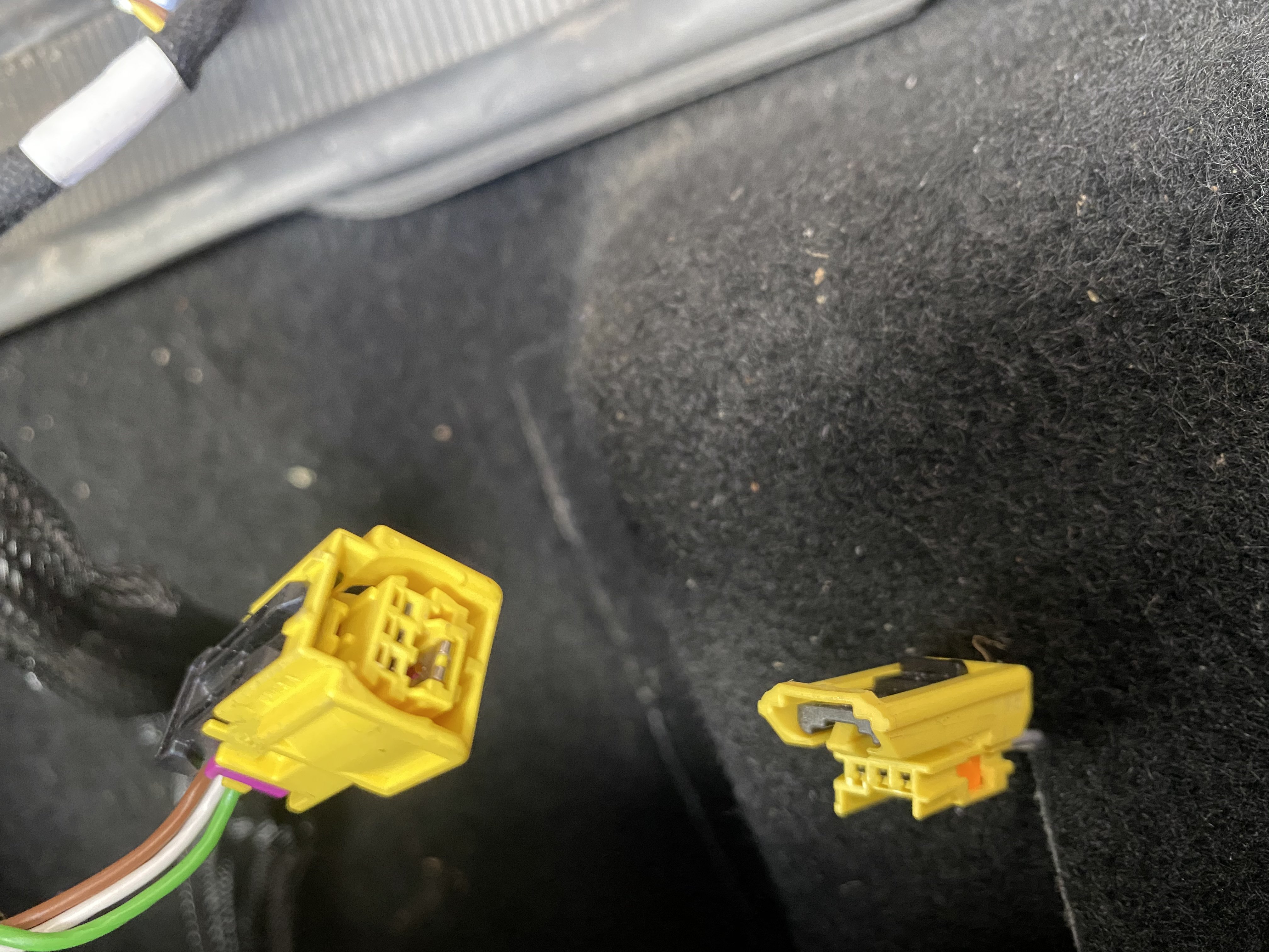

I appreciate this is an old thread but I'm looking to swap my cloth interior for a half leather from a 2016 which I got cheap. Yes I know I need to swap the plugs but the wires are different colours, does anyone know which goes to which
Mk 2 brown black yellow
Mk 3 brown green white
I'm presuming brown goes to brown but then what
