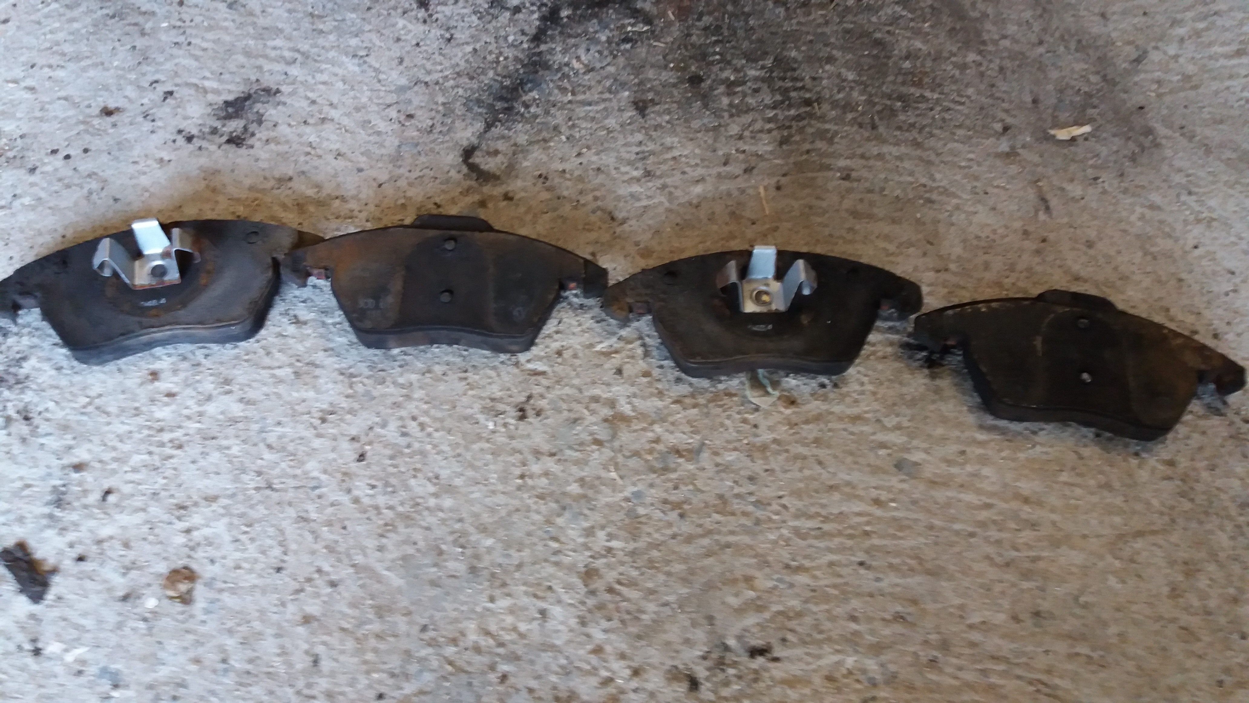

Just changing the front discs and pads on my 3t 2014 superb elegance hatch.
The new pads came with a single inner pad with a sensor, the pads I took off had no sensor - see pic.  The obvious answer is to snip off the flying lead on the new pad, but that doesn't sit right with me!
I've owned car from new, this is the first work done other than interval servicing.
Surprised there wasn't a sensor on originals, and can't understand how the warning light that flashes on at turn-on expects to trigger, given general consensus that there is no rear detector.
Don't need the car tonight so will leave it hanging to see what your thoughts are!
Cheers
Andrew
Could the worn pads you've removed have been replaced before i.e. they aren't the originals?
Sounds like it is common practice for mechanics to cut off wires and plugs.
Although there is no wire on the worn pads can you see a socket that it could plug into?
As has been mentioned there should be something there!
I've had he car from new, now 44k miles. Main dealers for servicing, this is the first thing other than tyres not done by main dealer. Am certain there hasn't been a previous pad change.
There is a bracket on the suspension strut that looks like it could hold a connector for this job but it is empty, and there is no sign of anything else in the wheel arch.
Is there a PR code on the boot sticker that denotes wear sensors? (Mind you according to that sticker there are no front brakes...)
Edited by andycowuk
