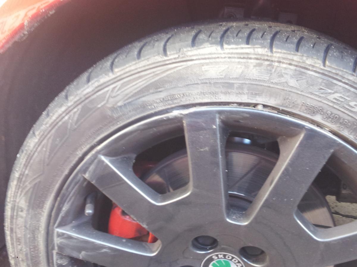

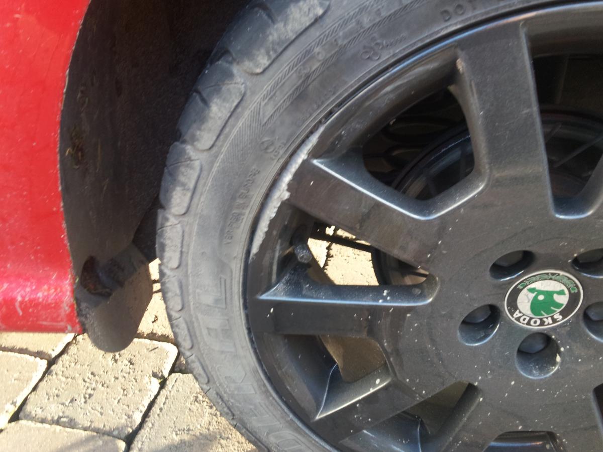

I was taking my mate to b&q to get some jubilee clips to finish fixing his radiator. as we came off a roundabout we lost the back end of the car without warning, fishtailed and spun into the curb.
after a quick check to make sure all my bits and my mates bits were in the right places we limped the car home with a strong smell of burning and began the task of checking the damage.
luckily the rear axle is not damaged and I have some very nice chunks missing from both my passenger side wheels but the worst damage is I have managed to buckle the rear wheel bearing and the disk brake and pads are shot on the rear passenger side.

not too sure why I lost control, a combination of factors change in camber as you come off the rounderbout, possibly oil/fuel grit/brine on the road as there is a motorway deppot on the roundabout, I know I was doing 30-35 so below the 40 limit but possibly still too fast for the greasy conditions.
not going to go through the insurance as it will probably cost me more in the longrun. Im glad I didnt hit any other cars as we ended up facing the wrong way on the central reservation.
im going to chalk it up as a learning experiance and take it easier in the future could have been a lot worse.

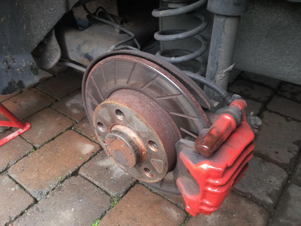

 I did jack the whole rear end up and gave it a good mooch underneath everything looks fine but I do susspect I may have bent the front passenger wishbone, my dad thinks I havent so ill get the hub sorted first and if it still doesnt drive right ill look at the front. and if it still isnt right then ill ask the garage to have a mooch.

you wont know if the rear axles bent without getting a full wheel alignment .... it might not look bent but could be enough to chew tyres

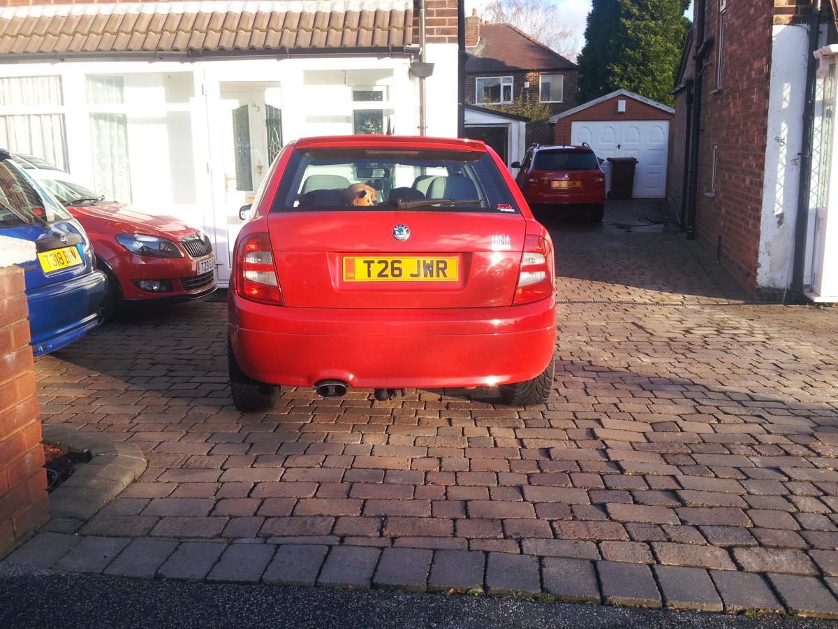

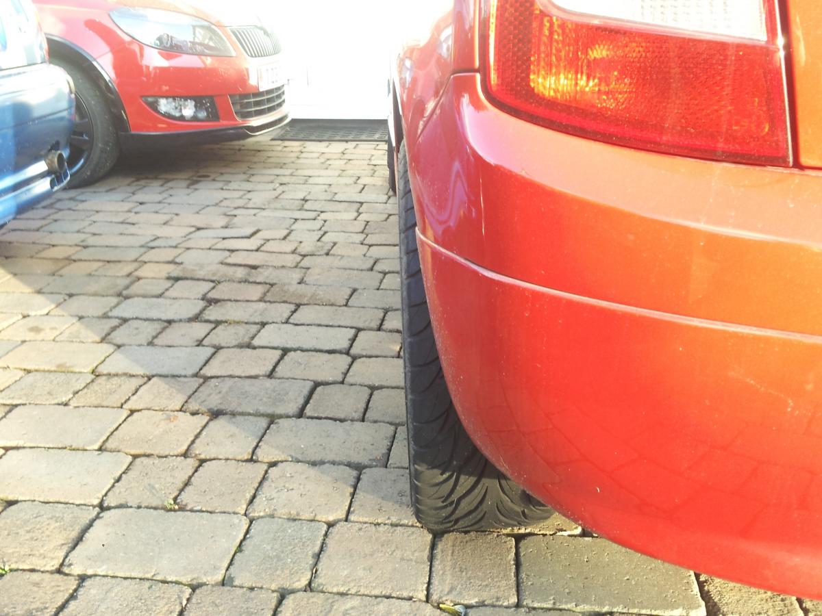

That rear beam looks a goner
Edited by BigJase88
Tuck it appart today and apart from a bent brake disk the hub is a couple of milimetres out so hopefully replacing the hub and bearing will fix the damage. At this point ive got noithing to loose.
Having done similar in a flimsier but lighter car, I concur.
@the OP, the sooner that wheel is facing the right way the better. Though it may be drivable with brakes etc fixed, it'll ruin that tyre in no time.
+2 by the looks of it.
The plan is to get it to the stage where i can drive it to a 4 wheel laser alignment place to get it checked so fingers crossed.
