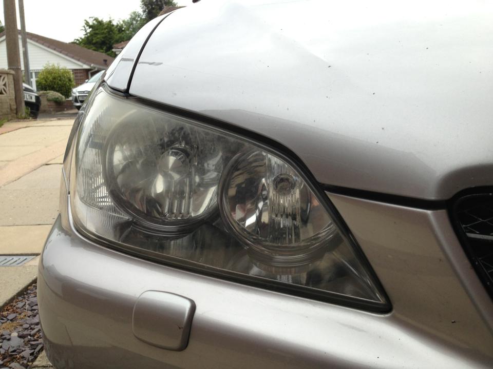

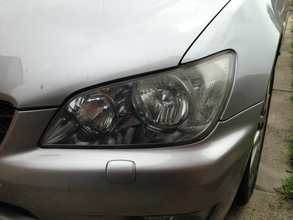

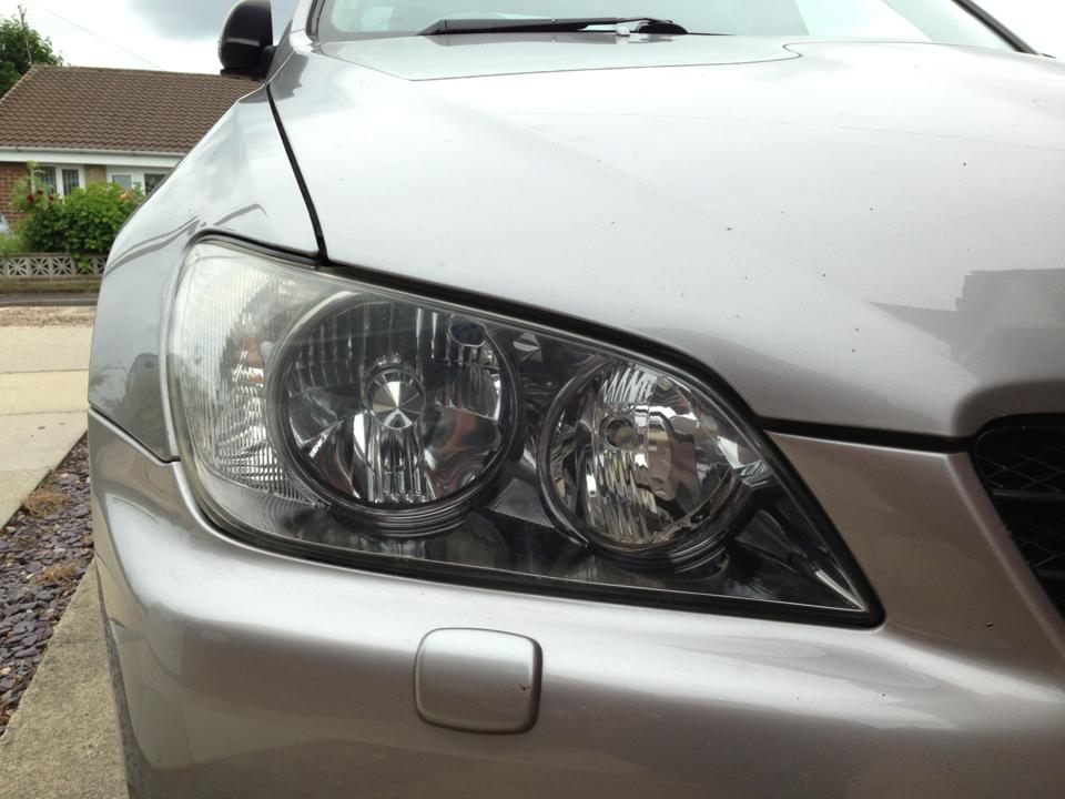

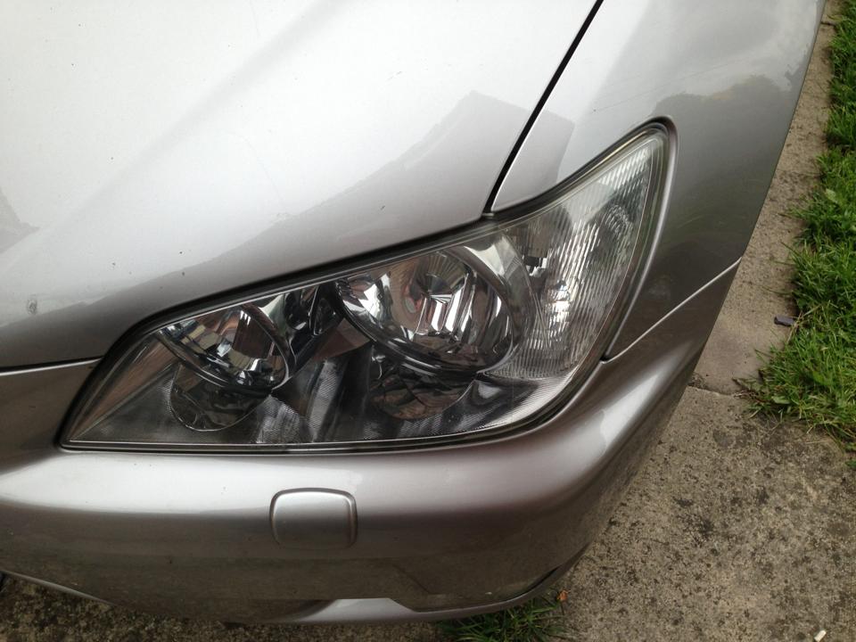

Used Plast-X by Megs on my pretty cloudy Lexus headlights and they look like new now. All done by hand too with no power tools. ;)  I'm at work at present but can post some before and after pics if required later.
And yes i've used smooth peanut butter on plastic trim for years works a treat. ;)

Here's my before and after pics from using Megs Plast-X applied and buffed off by hand......
Cheers
Dave.
