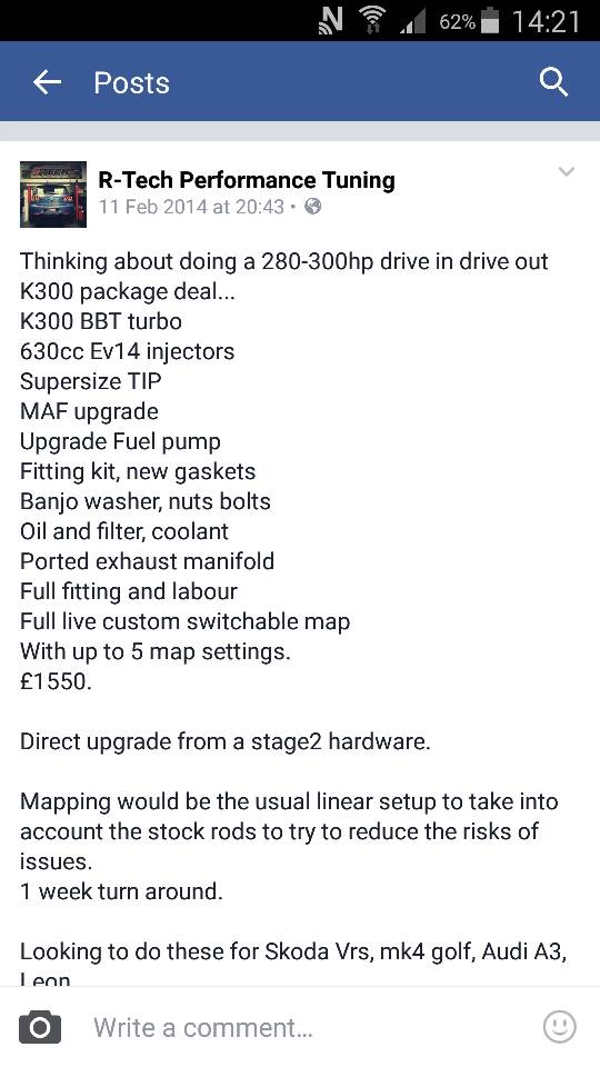

10502499_833707176675295_819783246058227
i havent seen this post on fb ? how much is it ?
Haha lap dance!! Most pointless way of spending money! I've got everything in place...just need injectors and turbo.
Sent from my SM-G900F using Tapatalk
That was it from a while ago
ID LOVE THAT LOL
Two years on and it still seems like a billy bargain.
It bloody does! If they still do it. All i would need for that is the maf, injectors and turbo. Then the fitting etc. Uprated fuel pump will be in next week. Bam injectors can be had for under 100 sheets. So all in all good cost for just shy of 300hp. But then once there will the temptation be for rods etc. I've read on rtech the k300 with rods can achieve just over 300hp, which i think will be ample enough anyway.
