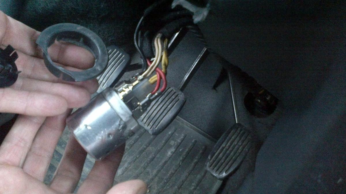

I just came in from taking a couple of pics. Noticed they tried prying off the plastic cover for the dashboard instrument panel but failed to do so. I suppose they were trying to get to the immobiliser maybe? Photos coming soon.
Here's two shotspost-102876-0-83795900-1392467252_thumb.jpgpost-102876-0-77496300-1392467272_thumb.jpg

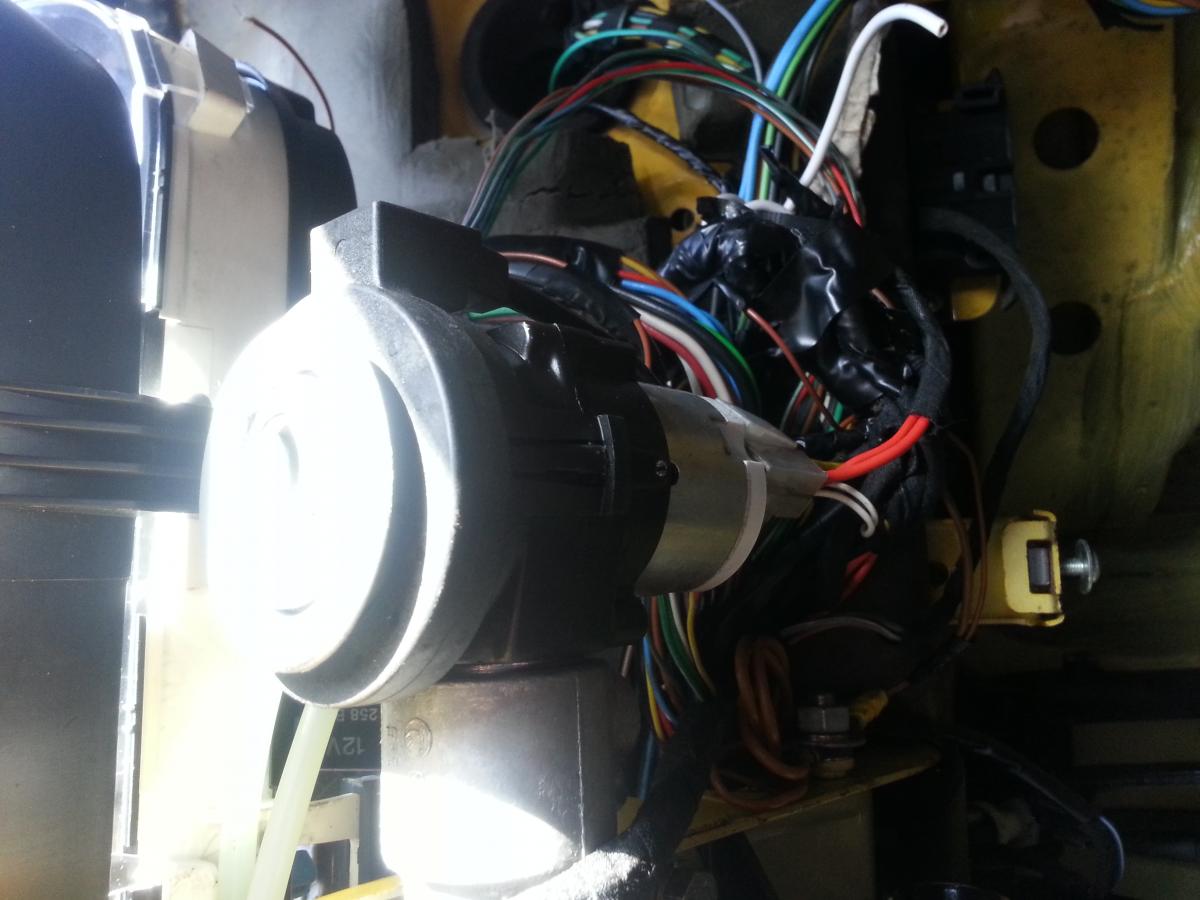

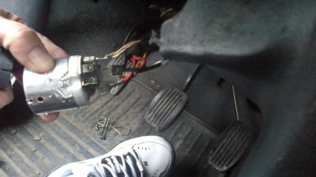

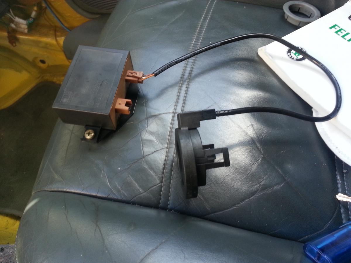

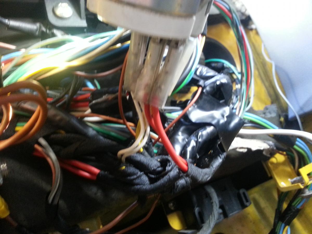

Is the transponder ring ok and wires ok if all wires are connected then I would say the transponder has been broken heres some picks to help
transponder ring round lock...
transponder ring and immobiliser
the switch and wires

No worries I have dash out for wireing works....
