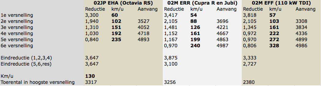

I've made some calculations based on 6000 rpm and 130 km/h

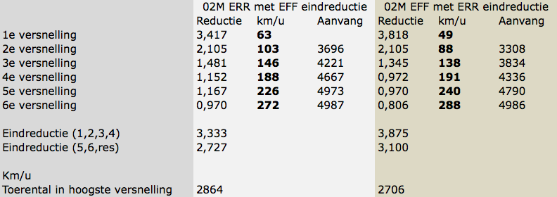

As we can see, the diesel is so long, the engine would probably be way off ideal rpm after a gearshift. Ideally speaking the 02M six speed of a petrol combined with a 02M diesel end reduction would be perfect. But I don't know if it is possible tom combine these internals
left is petrol with diesel ends, right is diesel with petrol ends:
