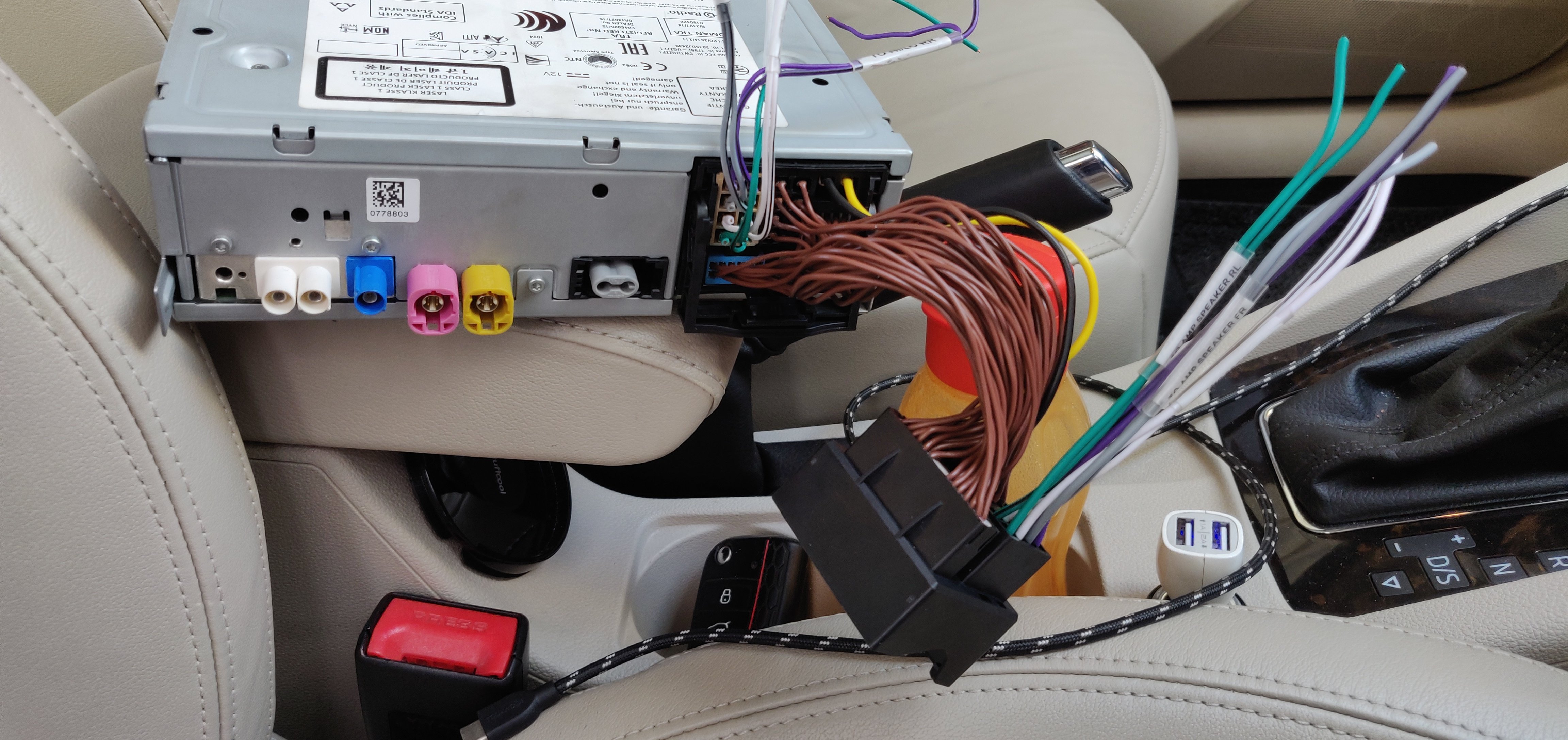

No hiss or any issue as such. Its not a direct plug and play. The direct fit harness has to be spliced (not the car one) and then fitted. There is no warranty issues in this as none of the wires of the original car are being spliced. See the thread where I have posted the pictures. They cannot void warranty for this as no wires have been spliced.
ok i see but it takes power and gnd from HU wiring ? So once we open and take out HU and from back connector/wiring we can pretty much install this thing from there ? right
do you have pic of wiring harness by any chance you took during install or any other pic of back of install ?
No picture of the harness.. Its a direct plug and play but the wires have to be spliced and tapped into of the harness. You can speak to the number provided.

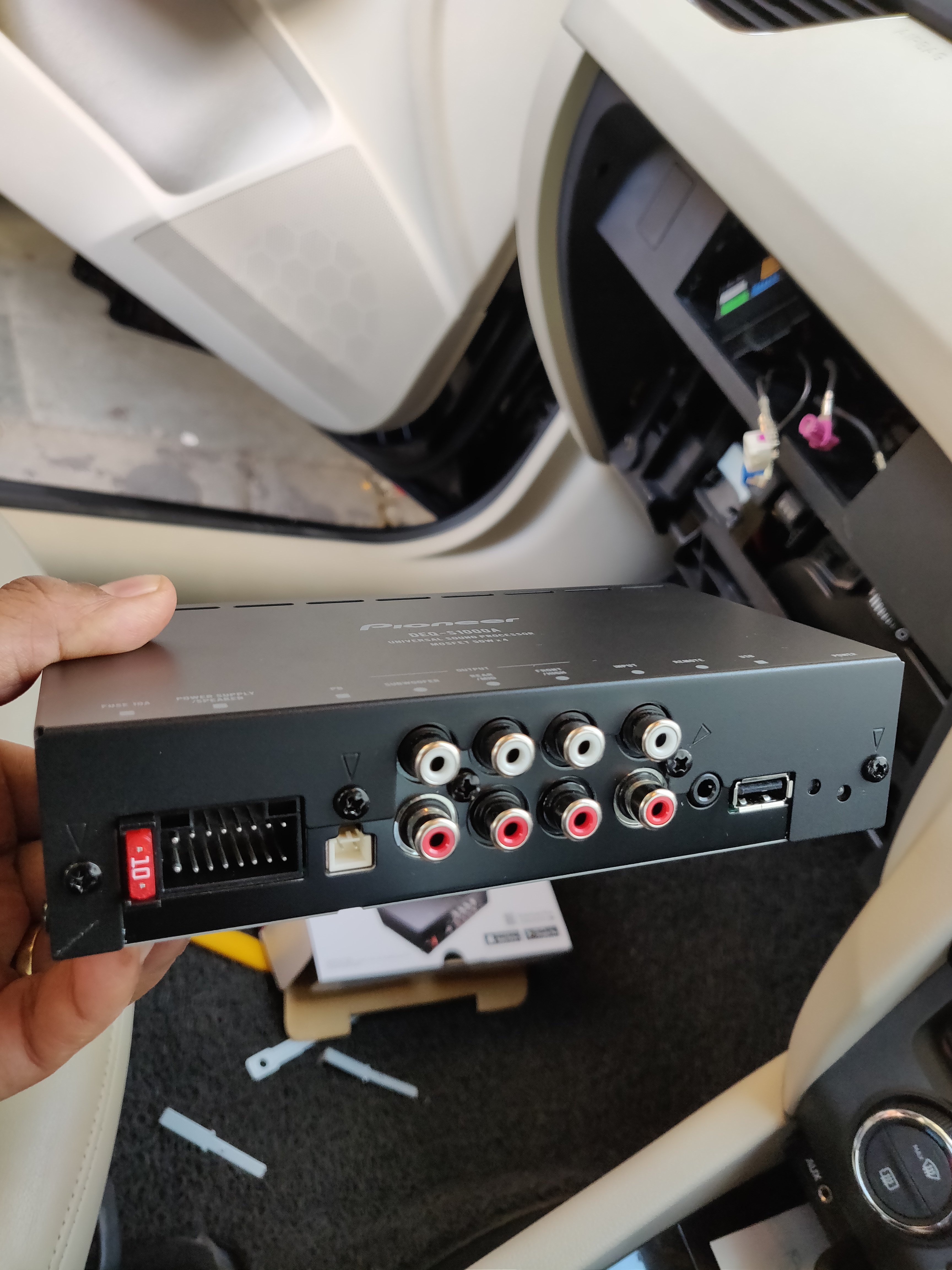

Hello Z klasse , i managed to get dap installed today(with some hint / help from Rammie on cabling but i found it in Bangalore and it is like an extension cable for qualdlock connector)
I didn't find time with my installer to fine tune and only install, it does show some improvements on vocals and harshness already ha...
I was wondering if you can share you sound processor settings ile as you suggested it can be shared, mostly for time alignment settings for centre imaging/staging
I wil find time only probably next week to of back tp installer hence checking/asking
Whoever you get some time do send me
Thanks and i took some pics which i can post next week in case people interested

you don't need to wire tap or splice anything. you need the correct harness this is what i've done. Then you can always put it back to stock if you want.
i've documented the harness required to piggyback the HU and connect to the DSP/high level to low level converter
don't cut splice into any of the harnesses you will regret it.
you need the speaker (high level) outputs from the HU and its easy to do with this harness

No we did the touch or splice any original wiring. It was a full 52 pin quadlock male female extension. Then we just connected wires to DSP . It is just that we didn't have right sockets so had to join them. I can always go back and take out this extension harness and reconnect back original socket harness and take out DSP from equation.
And connector on pioneer dap side is anyway different from iso plugs
is it a new dsp? it should have the correct connector
This is Pioneer dev-s100a same DSP made mostly with plugn play wiring for common cars in India/Asia which is Toyotas,Hondas but not available with quad lock wiring in India for VW/Skoda
