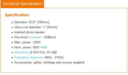

Look at the specs of focal component speakers RSE-160.  Focal suggest a nominal power of 60W RMS, but you only have 20W RMS. You need an amp to make these speakers perform correctly.
Edited by Guest
When a company like Focal recommends 60W - then I agree, it makes a lot of sense to follow those recommendations. I'd also err towards too much power available and turn gains lower rather than turning an amp up to 10 to "get the most out of it" - that's exactly when you start to fry voice coils.
