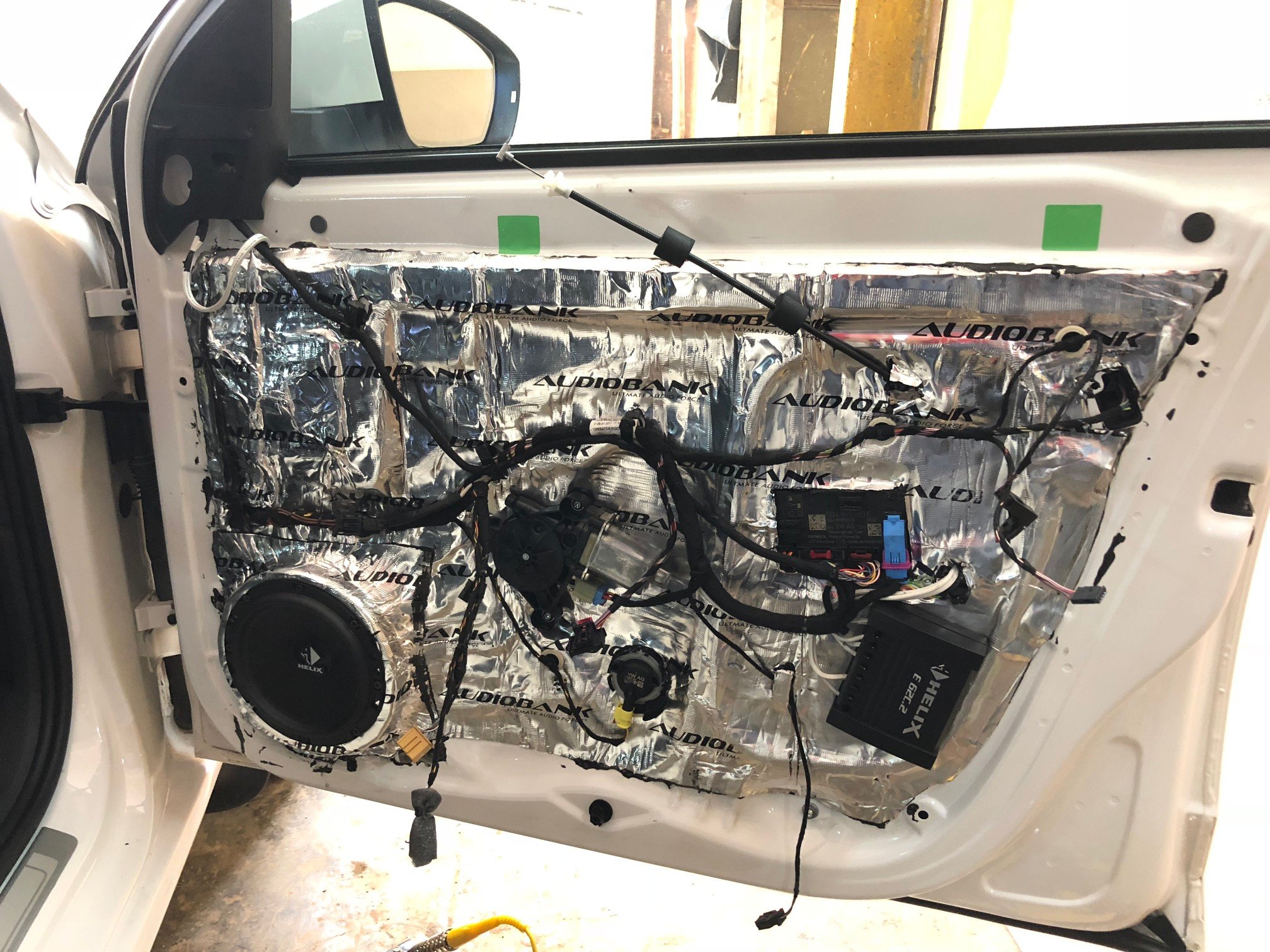

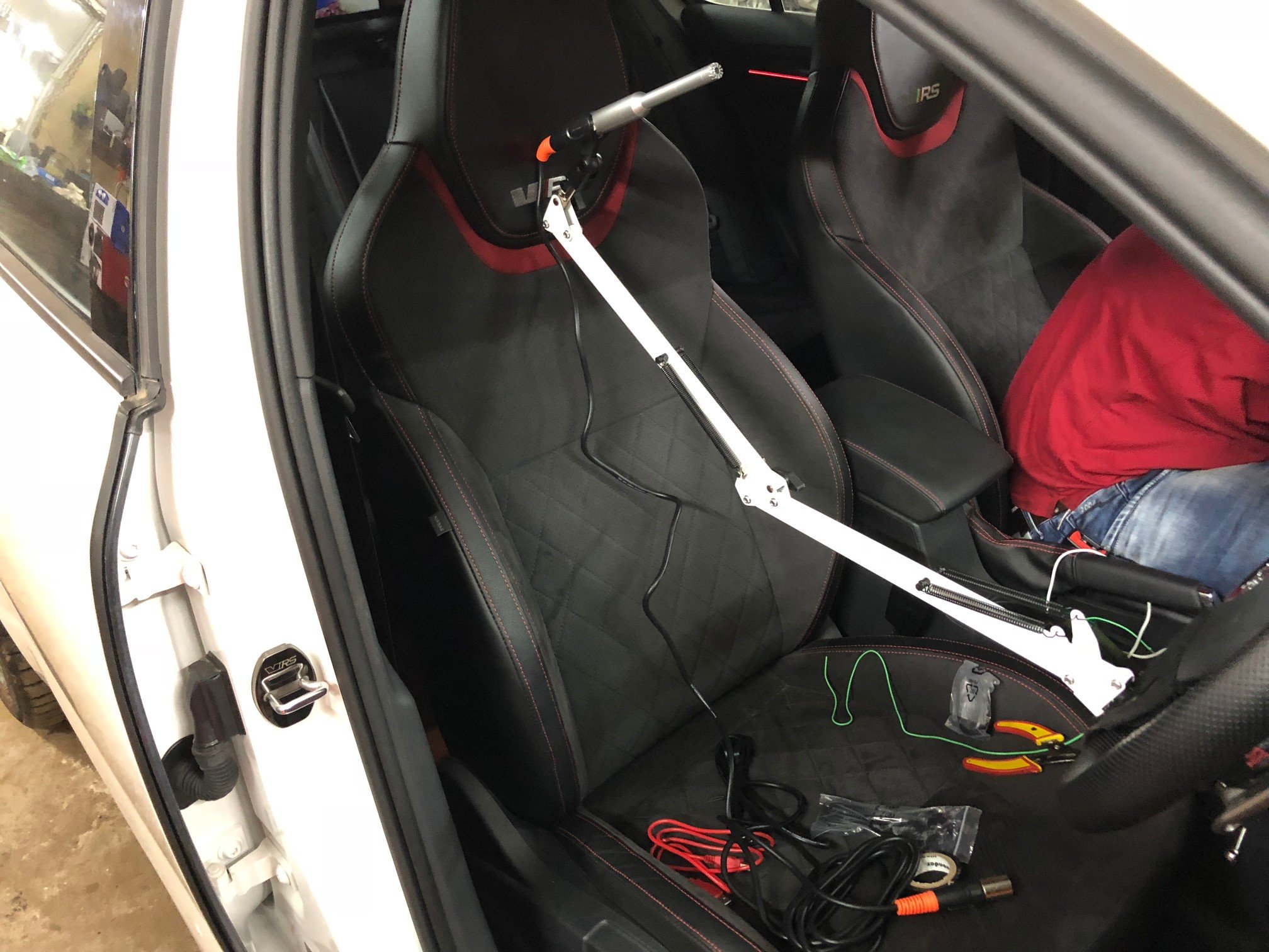

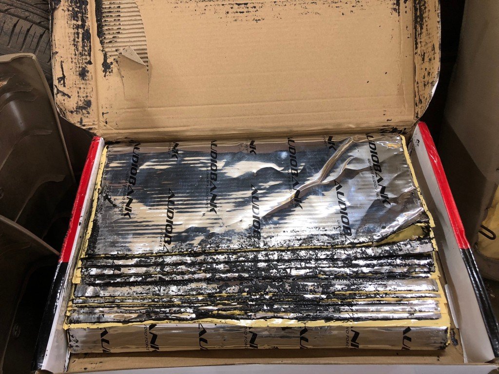

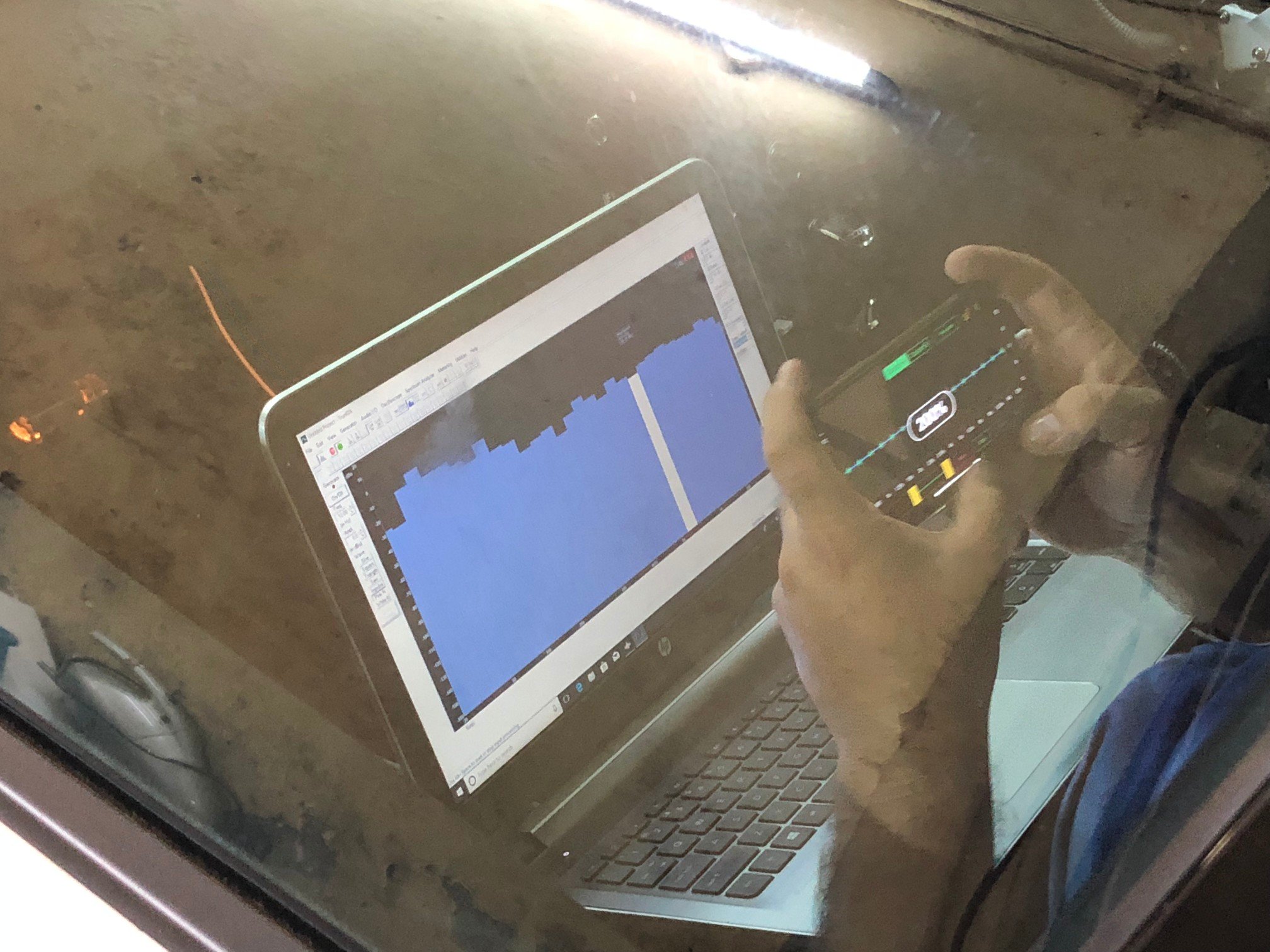

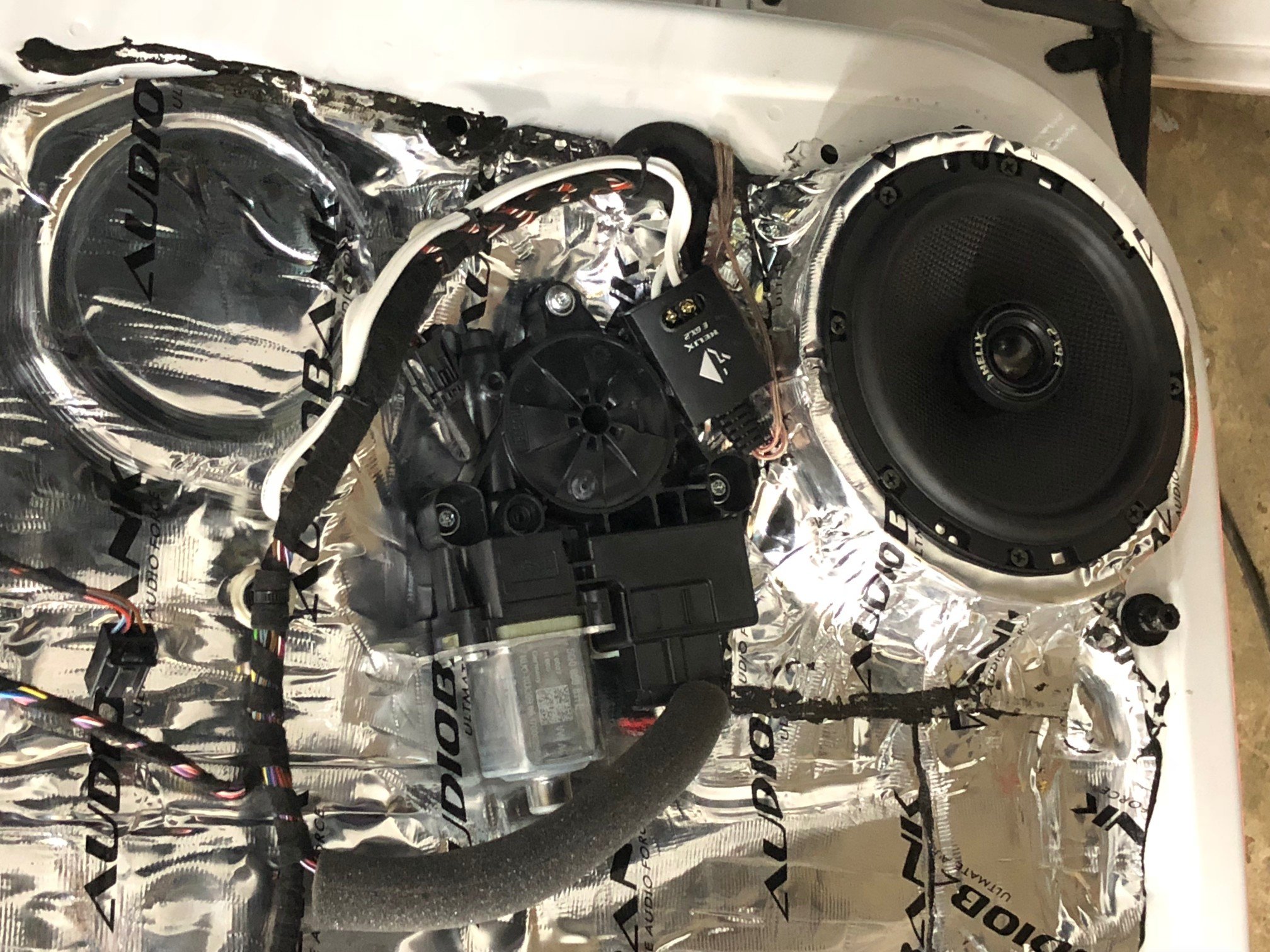

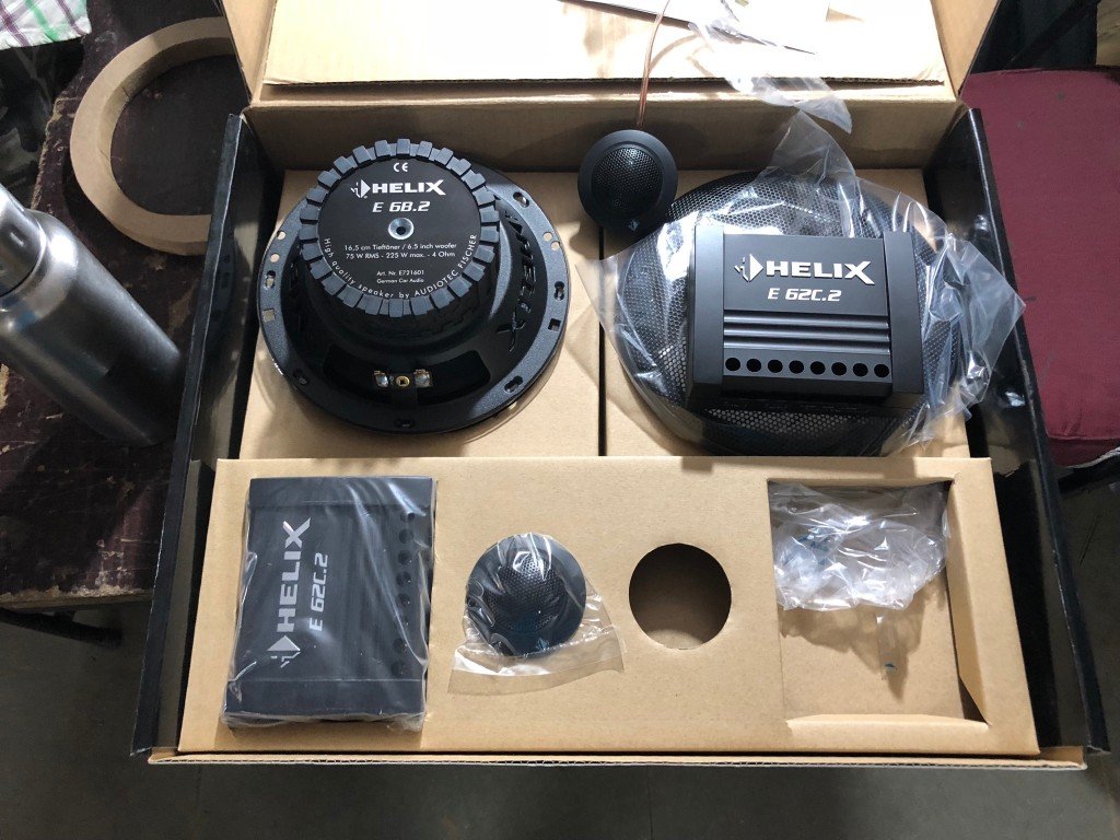

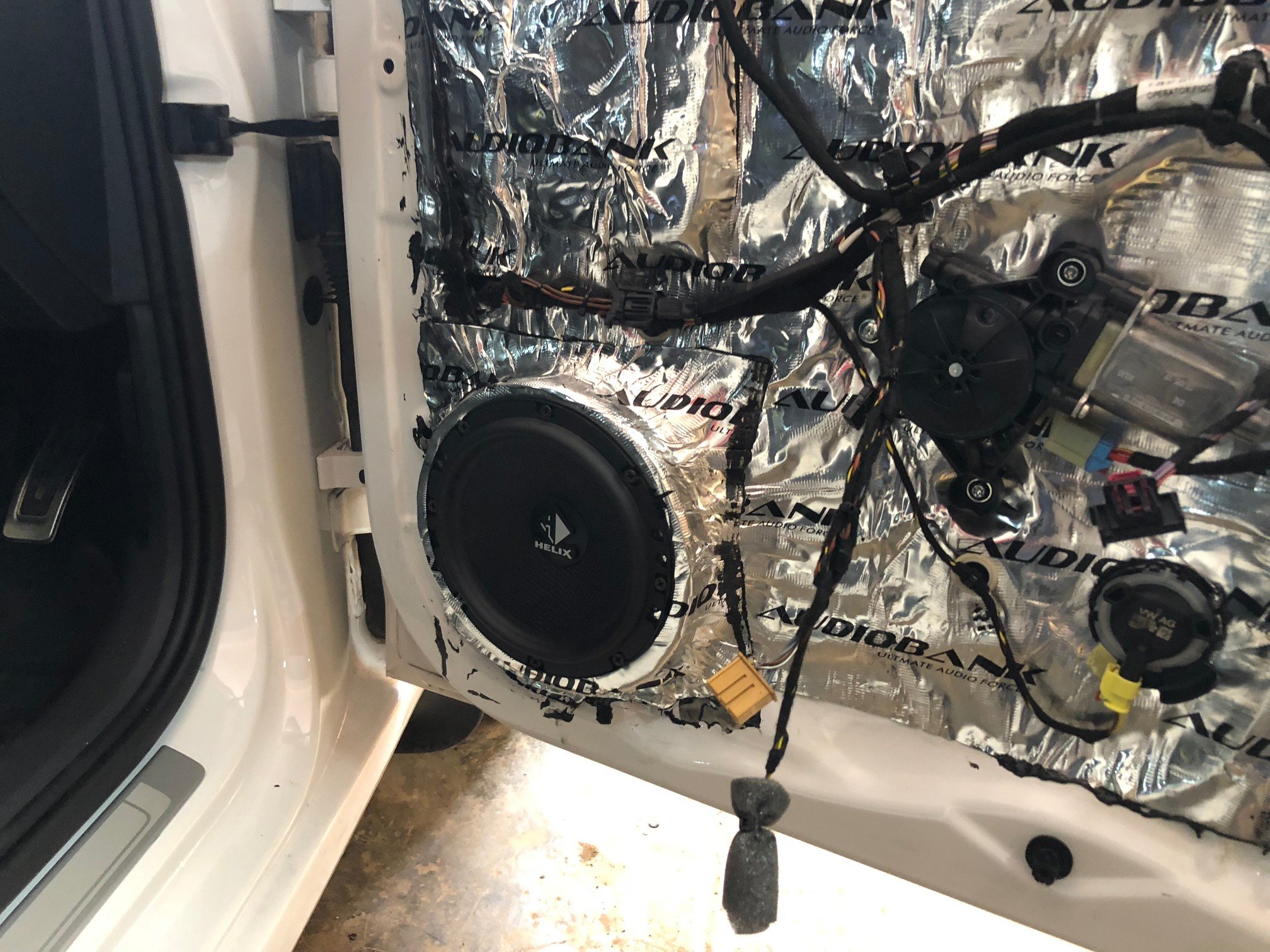

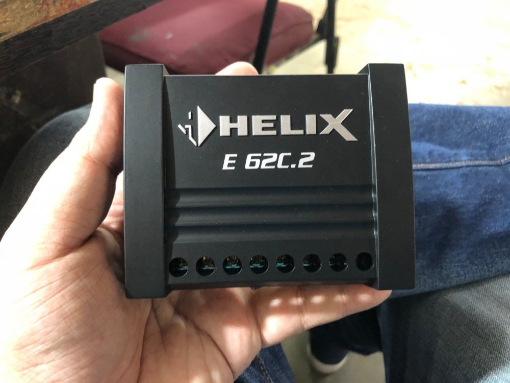

So I finally did the audio change.. Did the following with sound dampening

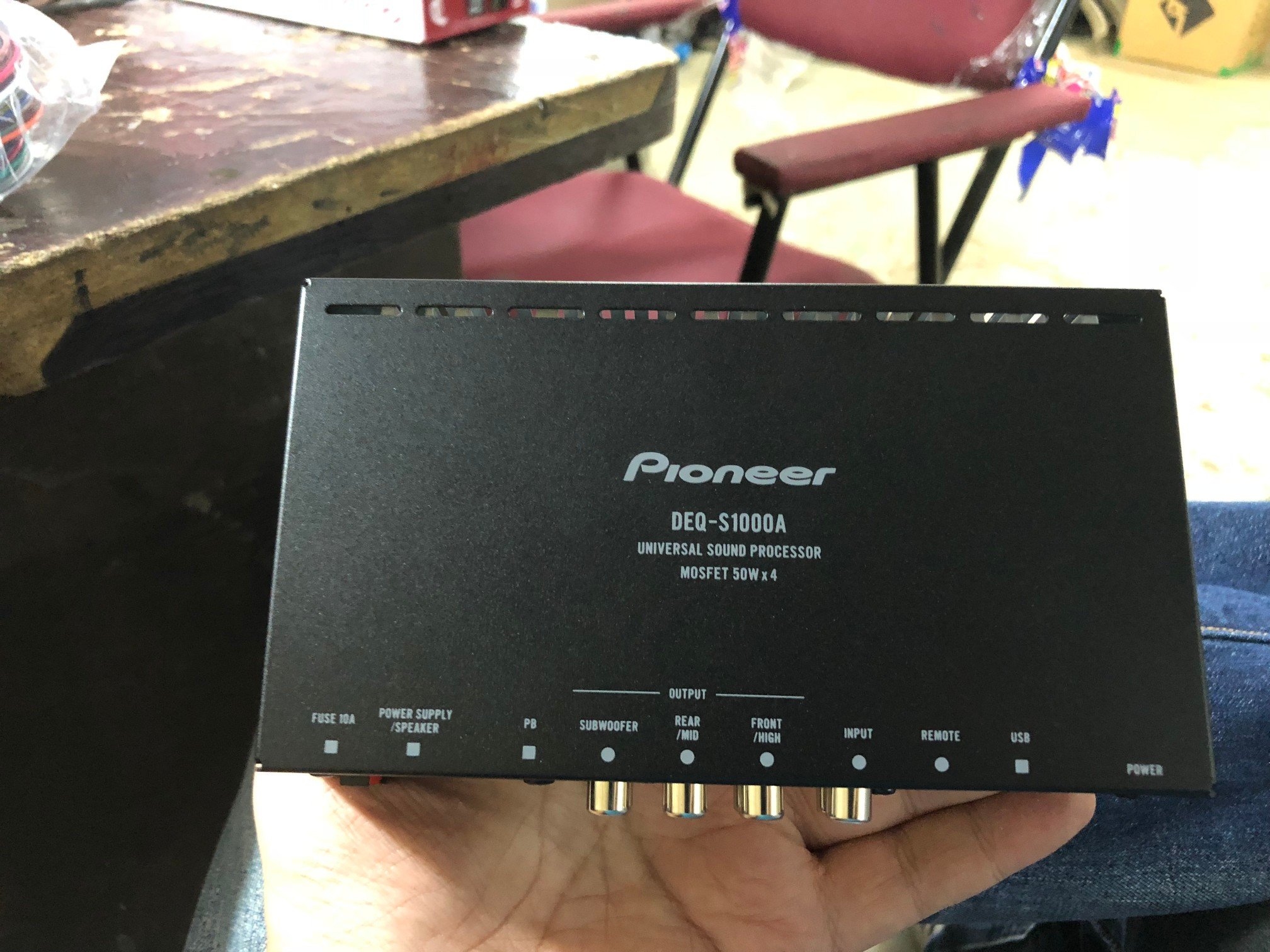

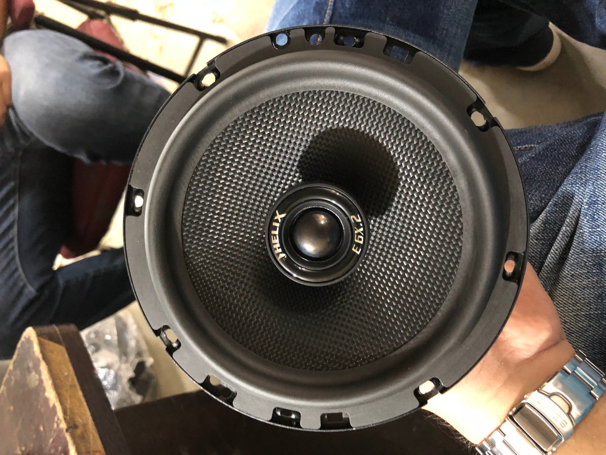

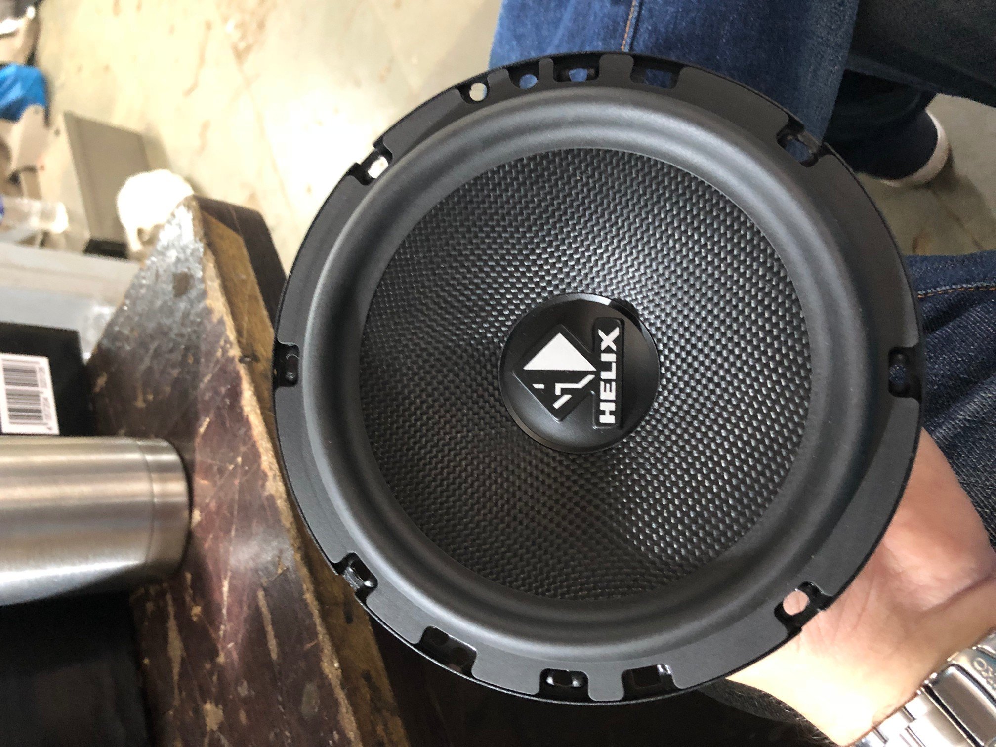

Helix E62C.2 front components & Helix E 6X.2 speakers rear coaxial with Pioneer DEQ-S1000A DSP which fits to the stock head unit with a coupler that can be sourced locally. The DSP was tuned using a MIC and software and then adjusted via a cable connected iPhone to match the frequencies and create a nice neutral curve. RTA was also done and this has made the car like a mini theatre.
The outcome was brilliant sound and a total change of the overall acoustics of this car. There is a slight lack of bass which can be added later via a mono block and a subwoofer but for now it sounds miles and miles ahead of what the stock sound used to be. The Pioneer DSP is made for Factory Head Units and works brilliantly. The set up is just a day old and will be observing the tone quality after breaking them in for a few weeks on end..
Some images of the install. Took almost 14 hours to get it installed at a Professional Installer in Mumbai, India.  No amplifiers used for this set up and the sound is brilliant for the set up.

The difference is way beyond night and day hahah. The DSP has made all the difference. Controlling each individual frequency and getting a neutral tone has been the challenge which was only possible due to the mic and the tuning software to configure the frequencies as close to the specific values. The installation took a good 14 hours out of which 8 - 10 hours went only in dampening. All the wiring looms and door motors were removed and put back in such a way that each component has been fitted with the outline cut out so that it does not create a gap and grind the motor or cause any issues in the stock fitment. Even the connectors were not stripped, only soldered onto with quality spade connectors. The speaker cables used also were quality.. This set up for what its worth is much much cheaper than what a full blown set up would be and the sound stage is phenomenal when you are driving the car. Focussed on me and it feels like the artist is sitting in front of me.. Only thing lacking is slight bass which I might end up putting a small mono block and a 10 inch woofer and send all the frequencies to the sub. Whats good about this DSP is that you can save presets and load them if you ever screw up the master file and if another car has the same set up, you can share the files on whatsapp and them can load it on to their DSP and experience a totally different sound stage. The possibilities are endless and can be tuned to whatever your mood is.. all this in barely a few mins of sitting with it with your phone and tuning it in real time.
Breaking in the speakers and will update on the sound quality after a few 100 hours of listening.

The Pioneer DSP is just a new launch and specifically made for factory head units. You get a direct plug and play adapter which you need to match with the car specific one. This particular DSP is Made in Tokyo and I think this is their initial test one to see the response. It’s available freely in India and is doing really well. You can read more about it on the Pioneer India website https://pioneer-india.in/buy/car-entertainment-car-amplifiers-sound-processor/deq-s1000a/

Could be but I wasn’t putting an amplifier and from what I believe many of these dsp require powered amplifiers to run well. The advantage of this dsp is the MOFSET 50x4 inbuilt power amp.
