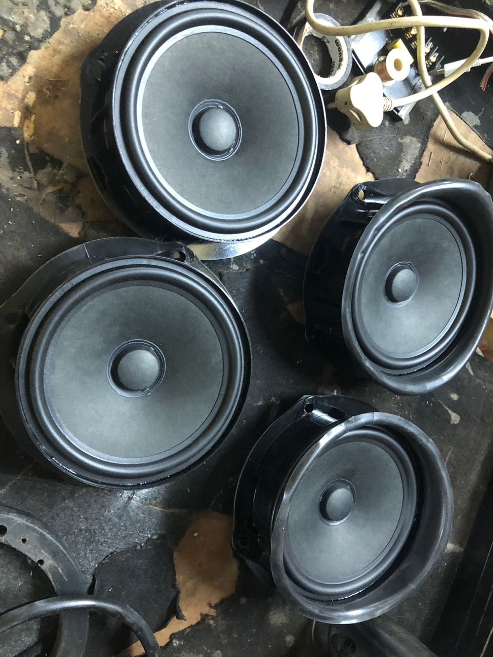

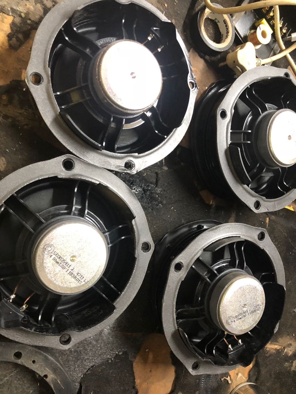

@z klassewhat size are the front factory speakers?
I think just shy of 6 inches.
im going to say 5.25 then? did you mount adapters for your door speakers?
Yes.

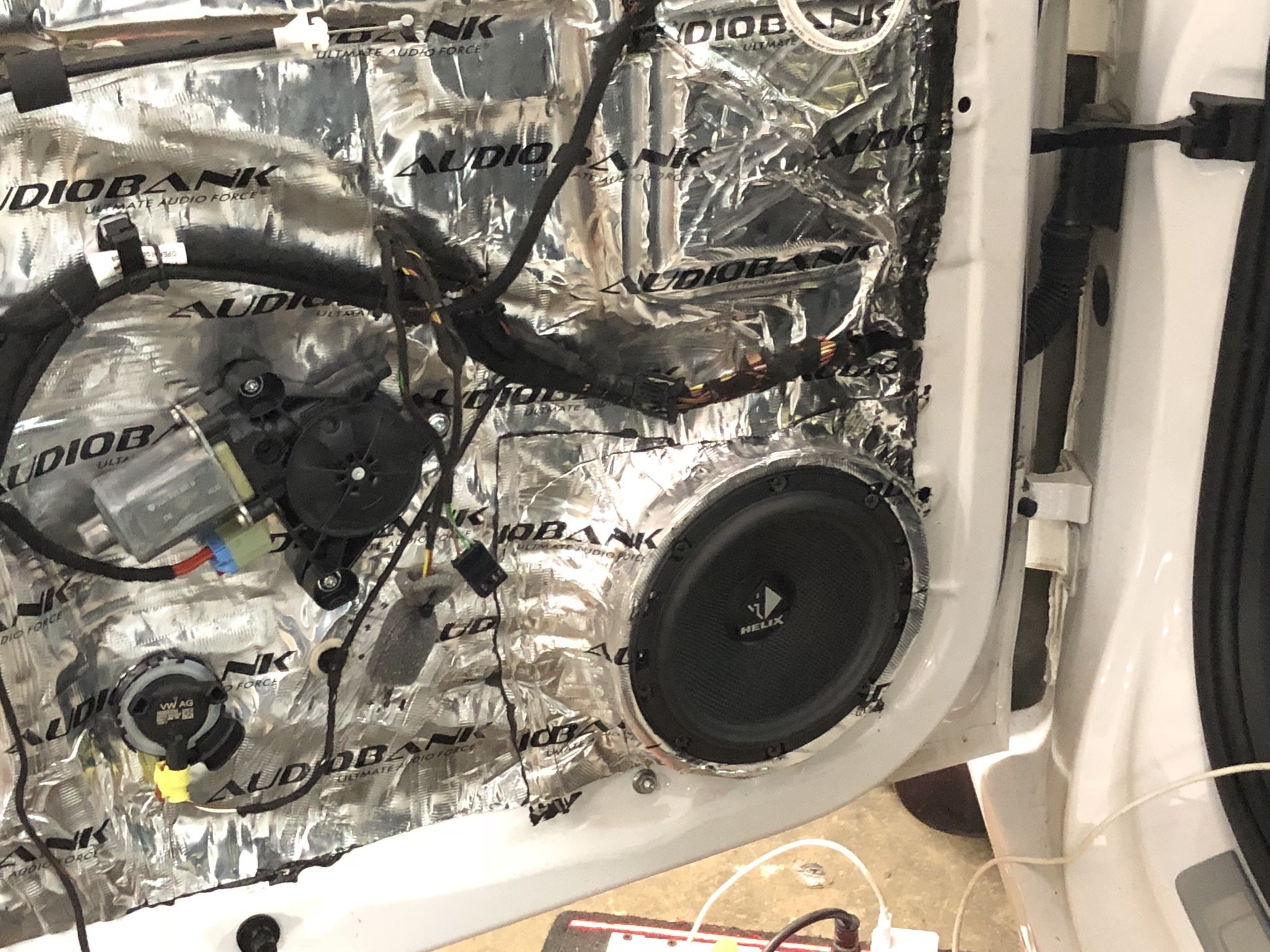

They can be seen here below the dampening.
The stock speakers are sonovox.
Edited by z klasse
have you got a link to the new ones so i check the size? if they are 6s or 5.25s
front and rear are the same size? looks like they are 5.25? from the spec. I have some really nice Type-R 5.25 components and type-x tweeters but ill shift them on for a full sundown component setup.
I was under the impression that the front & rear speakers are 6.5”
no idea would be great if someone could confirm?

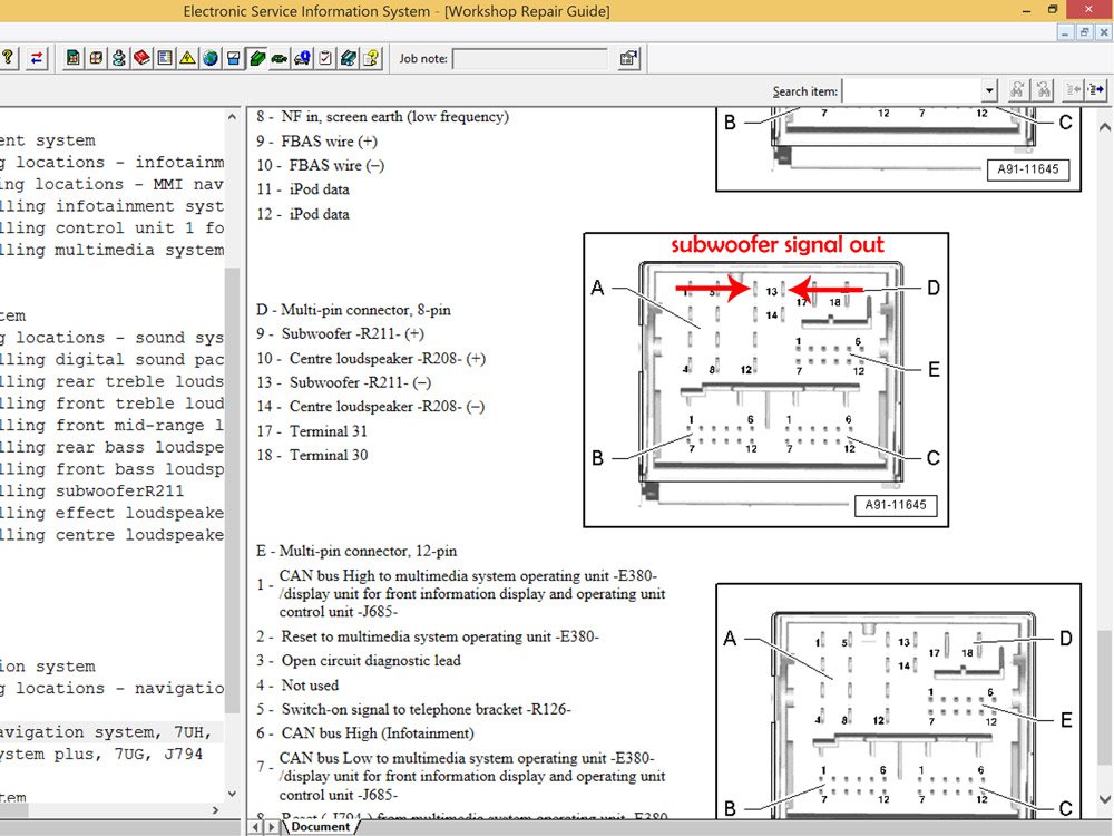

I think this is correct its the same for the seat MIB so there are two speaker outputs 9/13 and 10/14 are for a centre speaker (after some research i found this over on the seat cupra forum.... success just have to test it now.
Edited by JohnnyType2
Hi.. I will measure this from the stock speakers that I have and let you know with a pic.
Looks like this is seat only, hopes dashed, so if you want an after market sub you will need a 7C2i to feed the sub and split the front and rear signals if you want to retain fade control on the head unit
so confirming with Pawel the canton sub is fed via the optical out on the back of the headunit. these pins are dead on the skoda (which dumb if you ask me)  going to search for a DSP with optical in.
