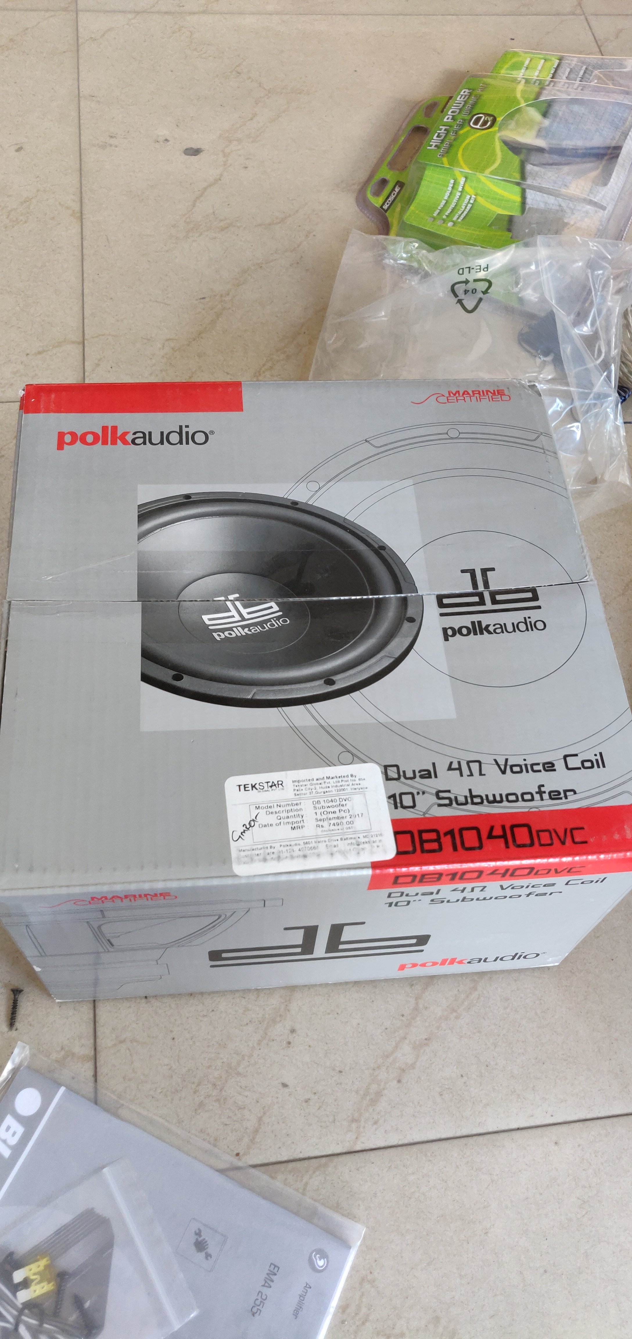

I am really excited and happy to report my final install of subwoofer and sub amplifier is completed yday(yup got a holiday) as well as final tuning done. And WOW what a great improvements and results overall in tonal quality, balance, separation and clarity. Got a premade MDF box and installed in boot. Installer suggested a 10" Polk audio sub with brazo amp(from Polk audio), and it was tuned very nicely. Stock speakers are signing very well and he recommends no need to change  and i agree
Please suggest me songs or send me any songs which are further helpful to listen to check setup. I did with many songs  including hotel California, and i am mostly listening my Hindi songs, a lot of vocals, drums and bells in Hindi music. Some legendary voices from Indian cinema both female and male are coming thru great, almost as good as home Hifi, and perception wise better as nicely cocooned from noise inside car(hard to do in Home :-))
I totally suggest this is a good approach to improve Octavia III music quality and DSP plus Sub makes a huge difference itself.
Total cost DSP - 170 USD, Sub +box+install+wiring = 250 USD. Grand Total = 420 USD/30k INR

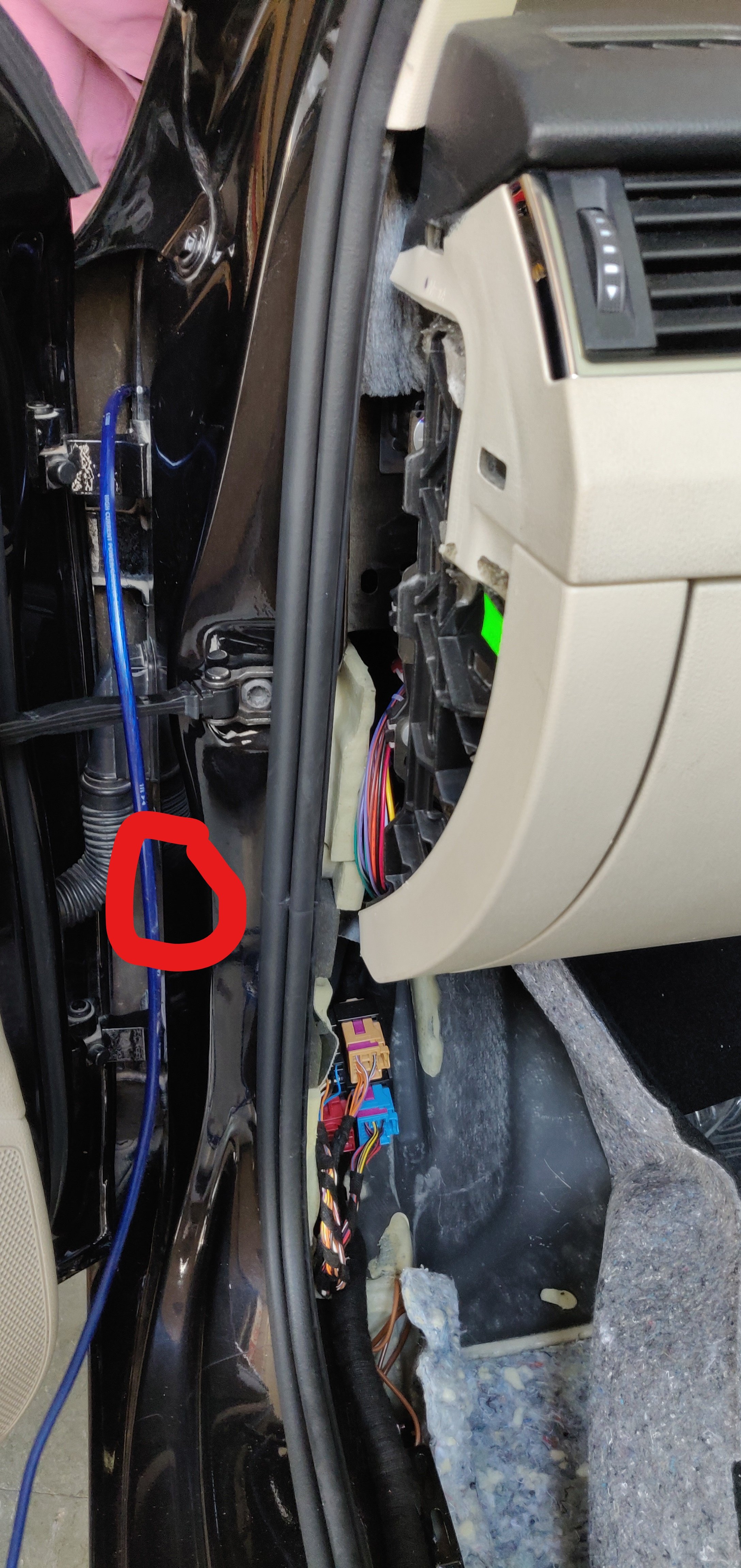

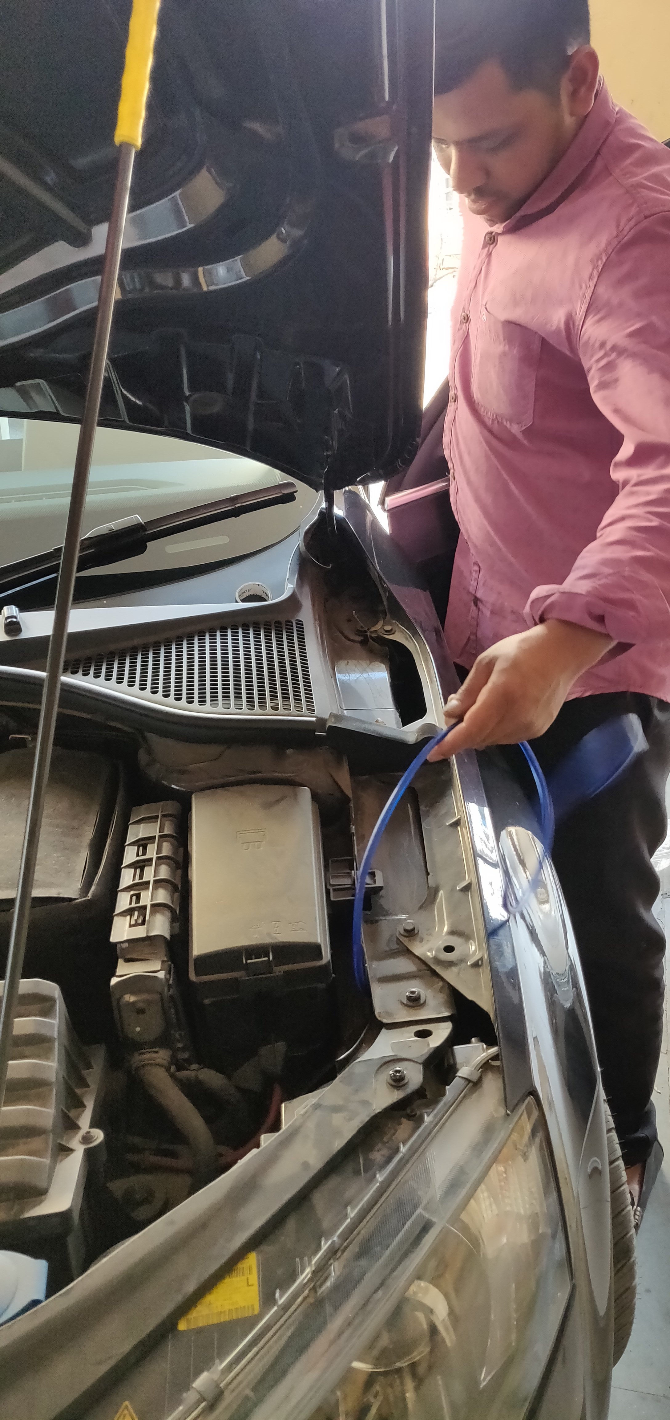

And one more thing i was impressed by how installer took the wire from battery using left side fender and body piece and not thru tunnel/firewall. He told me he has done similar installs in many VW group cars and they is space given for such things including hole to take wire inside dash. Also a nice GND point is there just below passenger seat . And all wires nicely hidden . I forgot to take final install pics as it was late in evening
where did you pull the power through the firewall at?
Nope not thru firewall but left side/passenger door and fender and then to bonnet(mine is RHS in India)

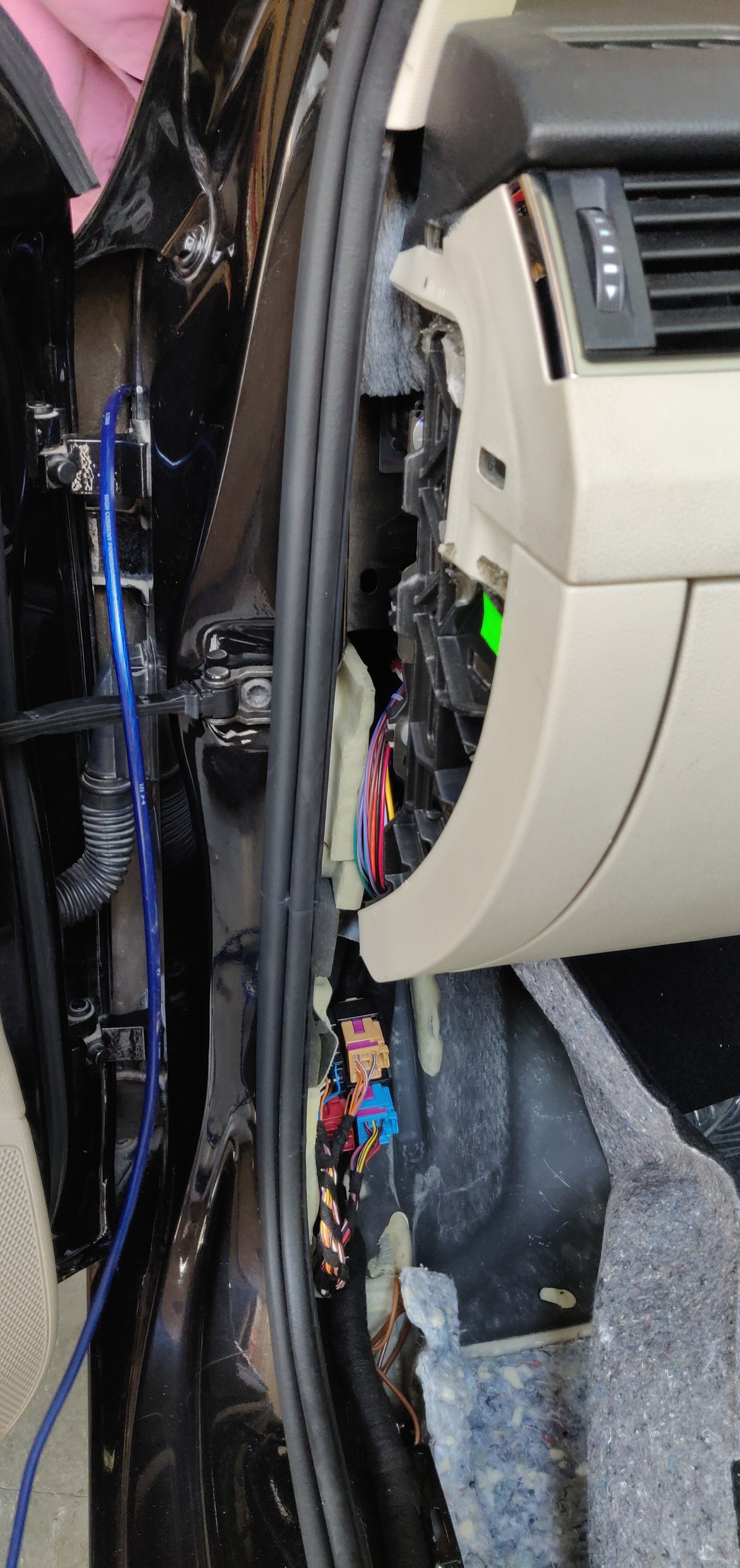

If you look at first photo with blue wire , it is power from battery
How does it get into the cabin after it comes through the fender?  Do you have any photos of this?
Somewhere on side there is a rubber hole/plastic port marked i red, i will take pics later to show if i can
So is there anything protecting the cable when the door is shut?
same plastic ring type cladding
These photos are when he really started and put first pass thru but in the end all was properly covered, tightly snugged and laid very well, i will take pics of final job around bonnet, battery and door later in evening or tomorrow
If you don't mind me saying, that looks like a poor way of routing the cable. Better make sure the grommets he uses are water tight. He's routing the cable in to an area where water drains - the cable is starting off at a high point near the battery and I guess he's routing into the car behind the kick panel? That means water will be running down your power cable and quite possibly find it's way in to your car. It's even worse if he uses a plastic cable sheath (which you should use to protect cables) because then you create a natural tunnel directly into the interior of the car. On top of that, there's no way of securing that cable so you'll have a power cable dangling (rattling?) beneath the front wing.  The cable should pass in to the car via the bulkhead - it comes over to me that your installer is taking a lazy option. Sorry if that offends anyone.
You mention above about thud when you turn on ignition? Most likely caused by a poor electrical connection. Usually get this if something you've added isn't earthed properly. If you turn the volume down on the headunit, before you turn the ignition, then the thud shouldn't sound so bad.

I will ask him again about water drainage and getting water in dash especially thru power cable, but he seems to know what he is doing and mentioned did in many cars of VW group. Y'day to take pics i opened my door and wanted to see where is cable going but i can't see myself and  i dont remember if he had opened side kick panel and anything else but i can't figure out and take a pic, and yes we wanted to avoid going thru firewall as it is painful and very tight and more wires, he made this clear but i feel he knew what he is doing, still i am gonna give your feedback and check over weekend. Not lazy kind of guy as took a lot of time to finish and seal neatly so that i can't see anything or any sign of installation. Almost took 3 hours for just install and 1 hours of tuning

Just got to talk with installer over phone, and he confirms that no chance of water coming thru as left side already has a hole and rubber cladding and typically Skoda group cars are built so well no water creeps and he doesn't see any water on fender side of things. In-fact he suggested that if i take it thru rubber on firewall, engine noise may creep in if not properly sealed etc.., I think i am good with his knowledge and expertise.
Lets hope for best and he is there to help me cover me if i fell any issues later after few weeks i can get it checked or after few months to see any traces of water close to that hole or anywhere in power cable

hes taken it though the main grommet as i did and just fed it up and to the left, its a safe spot as the grommet has a long sleeve into the engine bay its its a really snug fit. its actually around the middle of the glove box not at the door jambe as highlighted.
