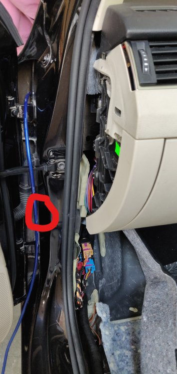

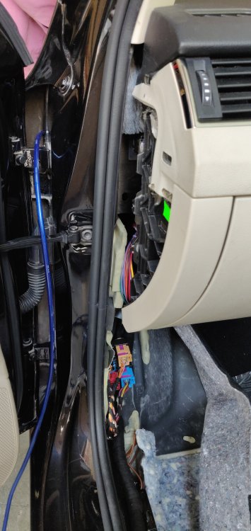

Hi there.. Would lov to know if at any point there was any interference after fitting the amp. I personally have fitted numerous amplified sound systems and had no problem wiring this in and getting the volume turned up... However! Once I put the key in the ignition and turned it I got the loudest most awful high pitched interference. I checked the ground I checked all my other connections. Nothing seems to be out of place. Tried a different amp and exactly the same. Then upon starting the engine the noise just got even worse with the noise then of the engine whirring through the amp.. Bloody awful. Any help or advice will be great. Many thanks
Change your earth point. Nine out of ten alt whine is caused by a poor earth. You've proven its not the amp.
Edited by Mallettsmallett
It can't be the earth as i have tried 4 different locations from under the bonnet to the boot. It also doesn't affect the sound through iPhone connected direct. It's only when the car stereo is connected.
Have you tried running different rca leads (if you're using them) from the head unit, outside the car, to the amp?
Any way you can try a different head unit? I'm not familiar with how you install in modern cars but where is the amp getting the remote switch on feed, is there an output from the headunit?
Route the rca leads away from the power cable.
I'm not giving up on this and have tried routing wires opposite sides and different earth points. Tried different Amps. Just not sure how I can move forward. Any help greatly appreciated.

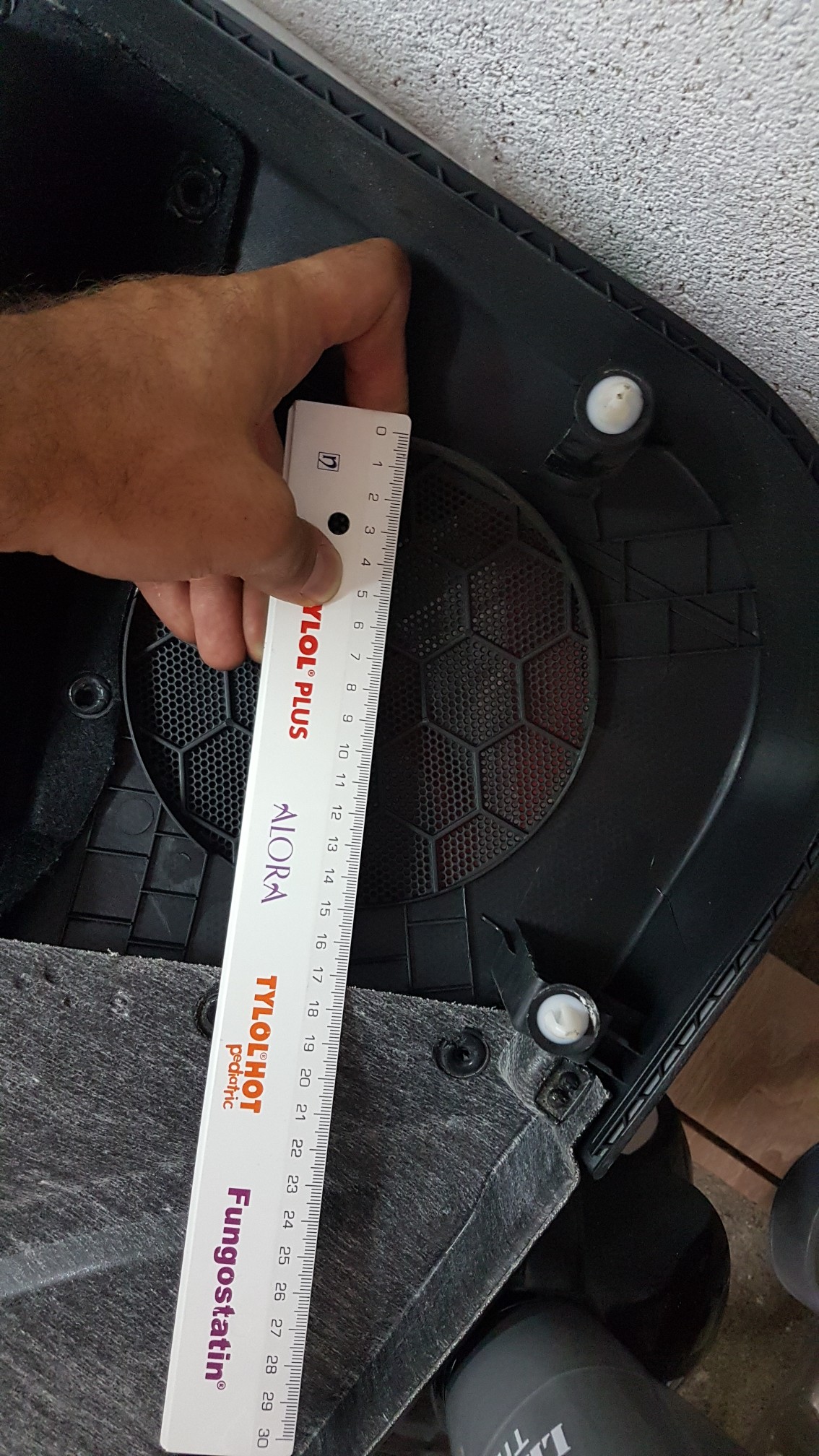

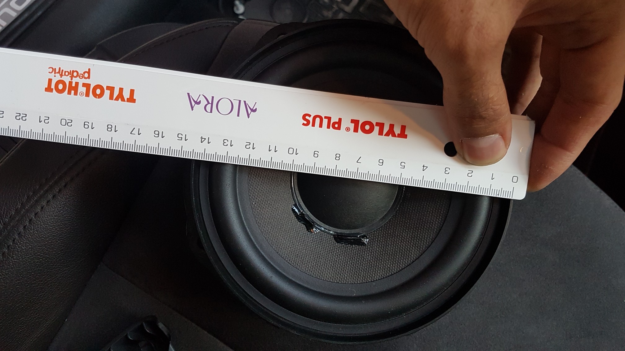

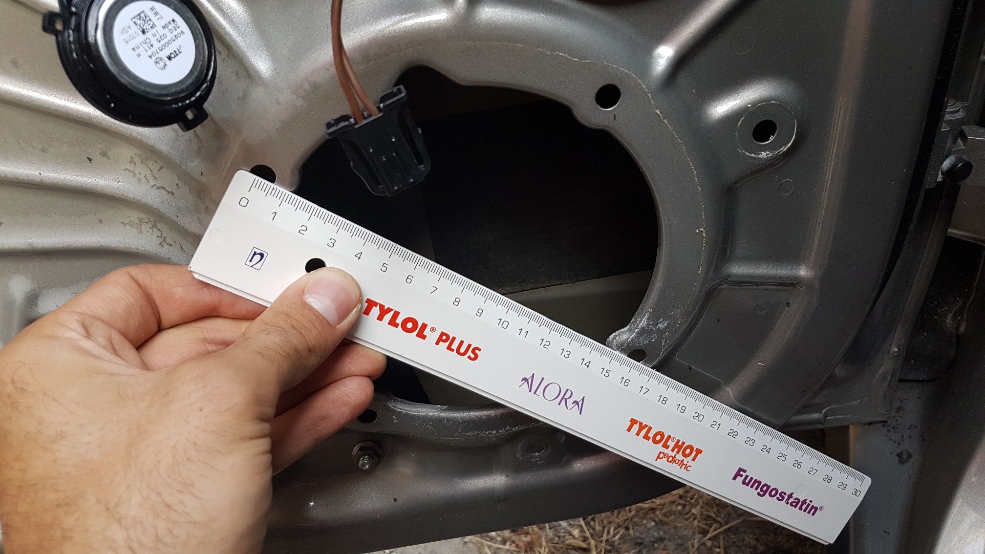

Milion of people in this threat and only bul****s written ...
Canton is just a logo. Have a thread about canton amp inside. the unit its capable of handling 1000 wats and more its just been limited duo warranty ...
Spend time for you all ( because obviously you dont have enough to spend for others ) and these are front speakers on Octavia 3. Will change rear too but not now. After I get the work done will upload more pictures.
Cheers!
You call bull**** to all the other contents of this thread and come in with all guns blazing, but...
...where are the much more essential measures about the depth for the front woofers with door windows down?
Also, if you are going to change woofers, I assume you change tweeters too - would be useful to know those sizes.
Of course that it is commendable to make efforts on behalf of the community, and for that you should be praised, but you should maybe have a more moderate language.
