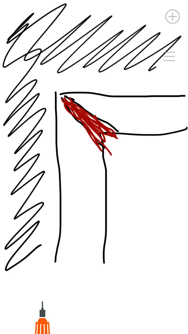

Is that for the outer corners? I'm ok with those it's the inner 90 degree corners I have trouble with.
Same idea just opposite. Make a kind of V in towards the corner, going in as close as you dare. Takes the pressure away and makes it easier, but don't cut right the way in. Like this (crappy iPhone) diagram [emoji1]post-112125-14299898208875_thumb.jpg
Get rid of the red bit.
Same idea just opposite. Make a kind of V in towards the corner, going in as close as you dare. Takes the pressure away and makes it easier, but don't cut right the way in. Like this (crappy iPhone) diagram [emoji1]attachicon.gifImageUploadedByTapatalk1429989820.422829.jpg
Love the diagram, was thinking about trying that and like you say don't go right up to the edge and watch for splits as you fold over?
That's about the size of it. And heat of course! You can go pretty close to the edge but not too close or you'll see the cut mark. I actually thought the hardest bit was the two top corners by the buttons, the combination of 90 dog corner and slight curve makes life 'interesting' haha.
Yeah they're the ones, really tricky they are, the lower ones and the ones round the climatronic aren't too bad.
With those I made some more cuts along from the corner as well, so the side you fold over only has about 1cm of solid tab at a stretch before the next cut until the curve flattens out. That helps too!
