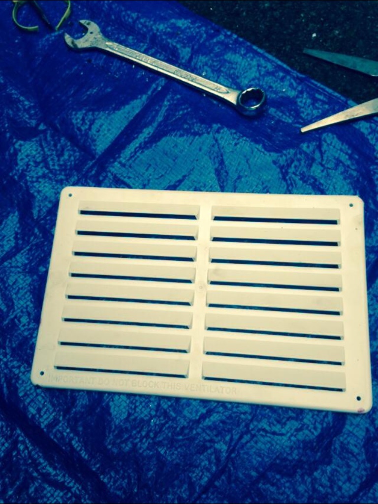

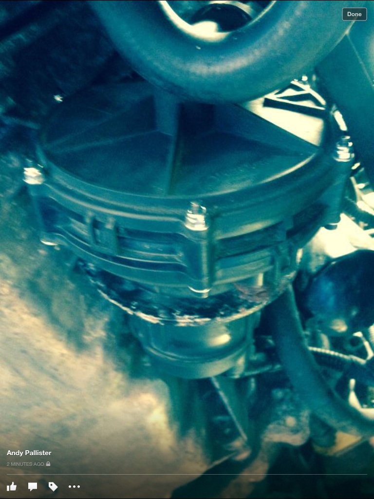

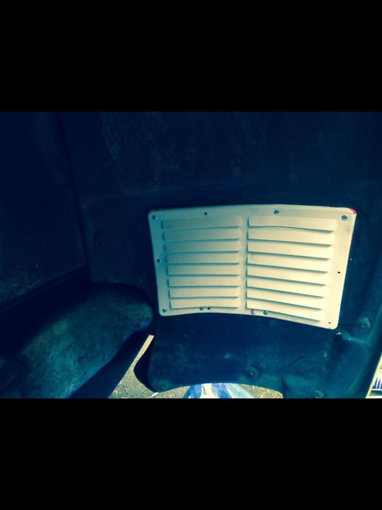

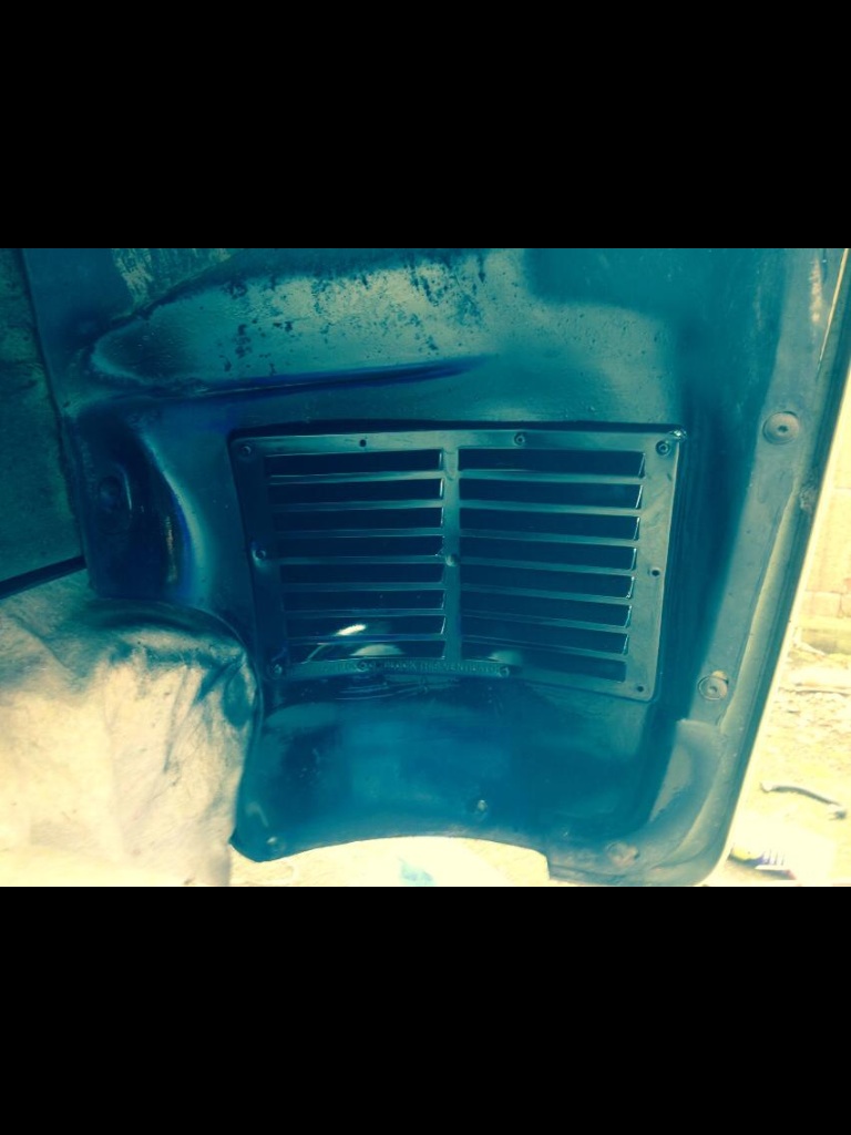

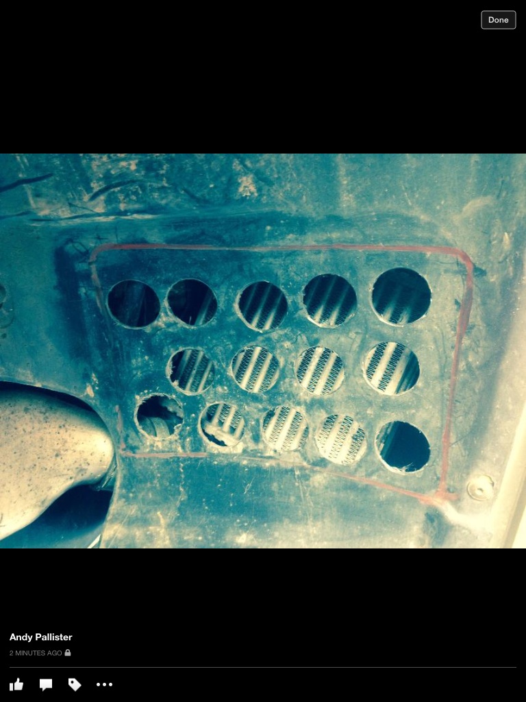

Adding to my maintenance and preventative mods I replaced the sai pump rivets with m4 40 machine bolts washers and nyloc nuts and also done the pikey arch mod with a b&q plastic vent riveted and sprayed black.
