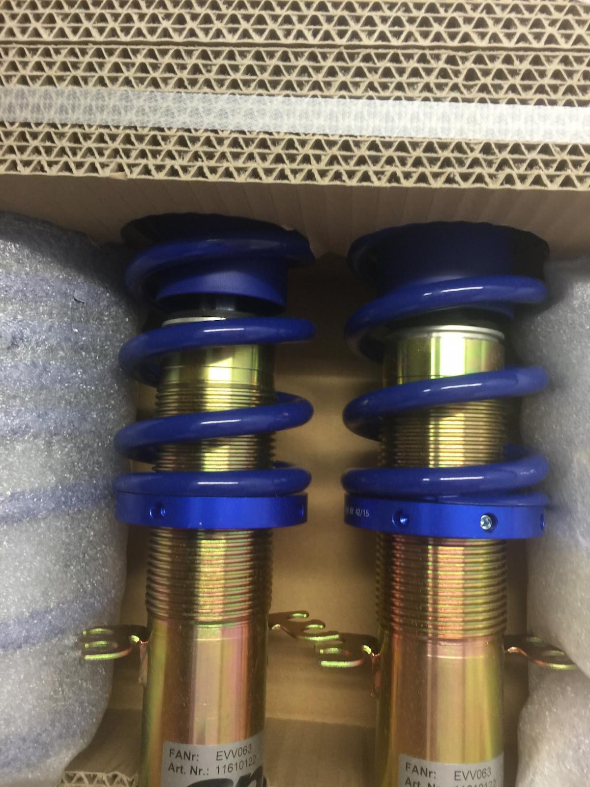

While the car is at the body shop the AP coilovers and a glass de-wiper grommet arrived at my work.

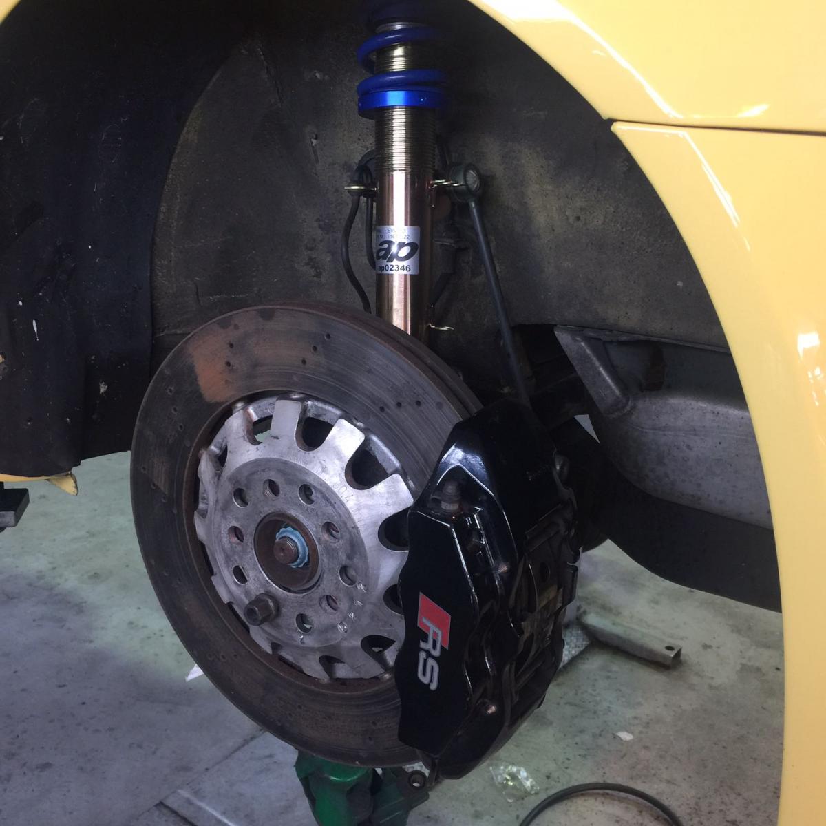

Got myself some TT RS front (370 mm) and rear (310 mm) brakes from
Germany...
Germany...
Nice. Can you feel a difference?

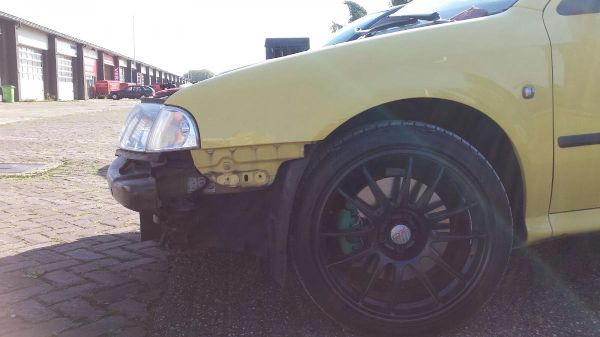

Unfortunately I don't know as the car is still at the body shop... That's near 4 weeks now! And my befriended mechanic has started his holiday today... I am also curious if the cylinder and booster are a good match to this set, which I am sure will differ in that part on the TT RS.

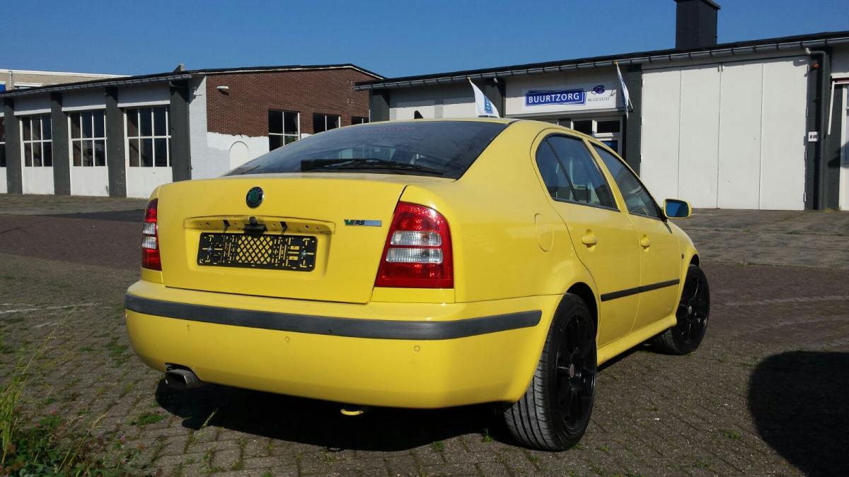

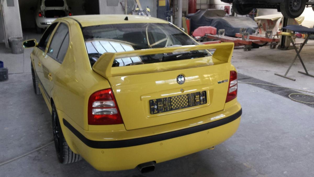

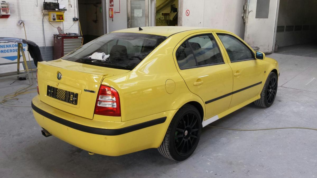

Nearly finished...
Looks good, is the sill area ok - corrosion?
Yeah it's good, I had a little spot on the surface since I bought the car 2 years ago, but i always thought it was tar or something.

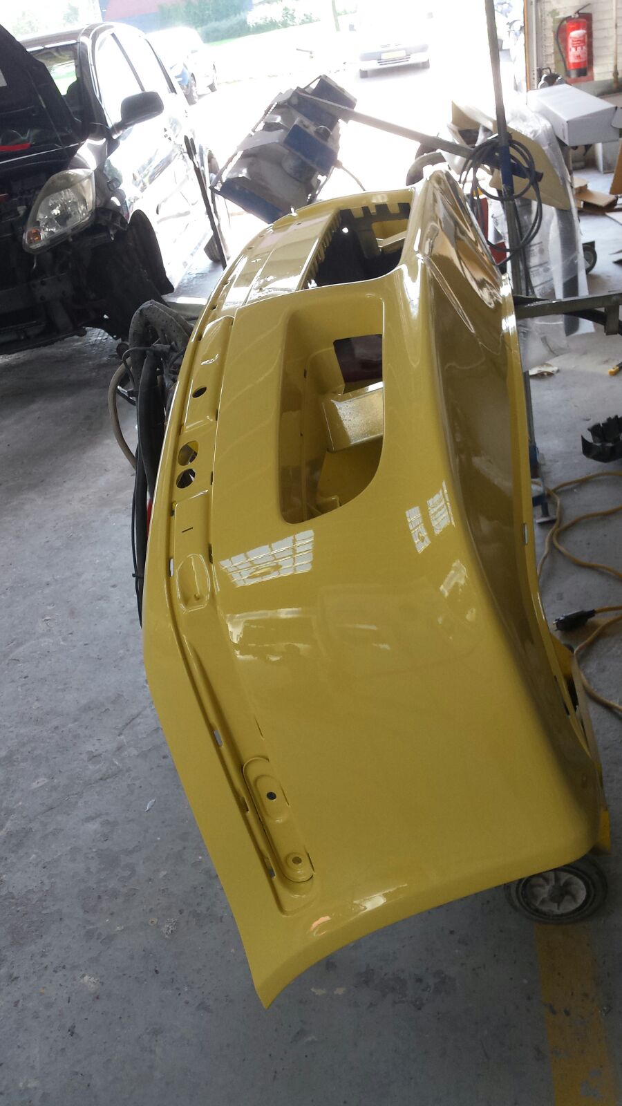

Is the spoiler going back on?
Yes! They had to fit it in 2 pieces a time. I was going to pick up the car today, but then the wipers decided to stop. It was totally jammed.
Front brakes and AP now fitted. De-wipe Kit too...
Very nice looking car, the wheels / brakes look really top notch.
Edited by Silver Bullet
Tnx! I am really glad how things worked out and so lucky I decided to skip holiday in favour of the car...
