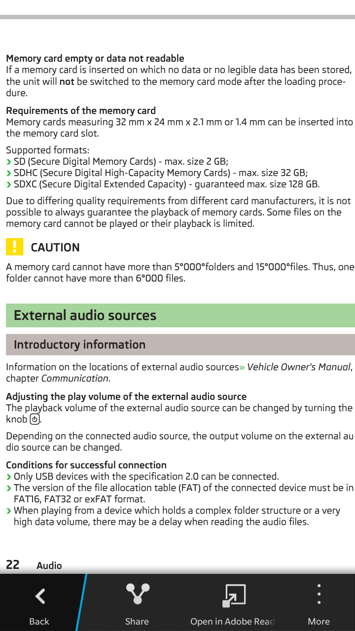

FYI.  As I said before NTFS failed - the card couldn't be read.  I have a 64gb SDXC card. Before trying to format to FAT32. I had another read of the manual:
"Supported formats:
SD (Secure Digital Memory Cards) - max. size 2 GB;
SDHC (Secure Digital High-Capacity Memory Cards) - max. size 32 GB;
SDXC (Secure Digital Extended Capacity) - guaranteed max. size 128 GB.....
.....The version of the file allocation table (FAT) of the connected device must be in
FAT16, FAT32 or exFAT format"
So after reading this I quickly formatted to exFAT and added a couple of folders. This worked! So I've added the rest of my music and everything works as it should

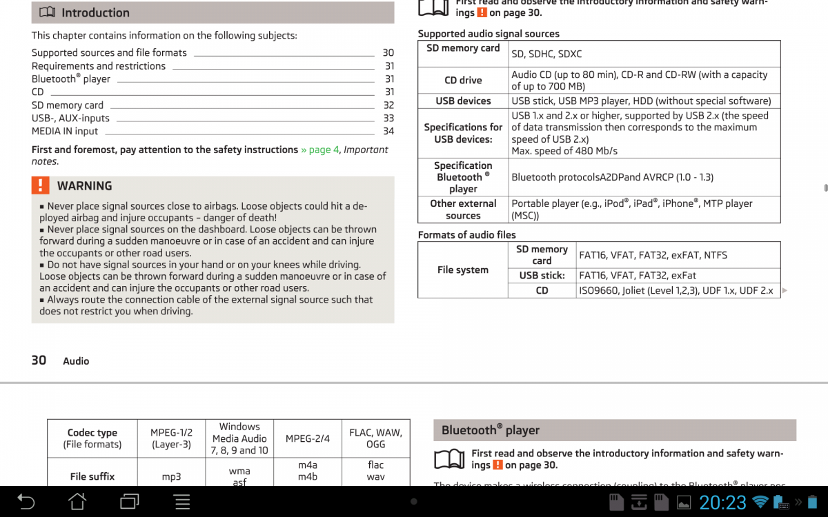

you must have a different version of the manual than me, mine is the same as the one linked on one of the pinned topics on here, from Nov 13.
Below is the Columbus and Amundsen manuals and they both say NTFS is compatable
128gb working fine with amundsen
Don't trust the manual as far as you can throw it.  My version says a lot about admundsen that it doesn't do.

Columbus appears to support all the above.
Thats why i thought 'maybe' Danmaca has got an updated manual for his Amundsen which has corrected these errors
