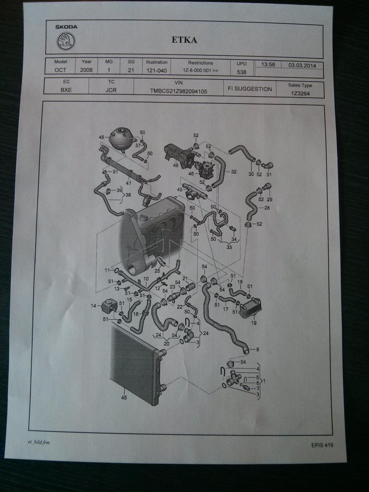

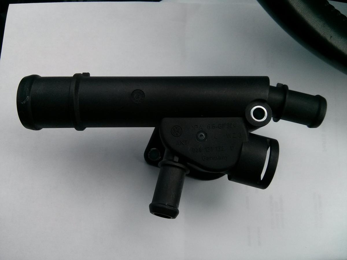

I would need to top up every 100 or so miles. this gradually got worse to around 50 miles, so I investigated myself and found the leak. Its a plastic pipe on the engine block, which deteriorates.  Between the battery and Engine block, and below the tandem pump (I think thats what its called), you have to take the air filter housing out to get to it.

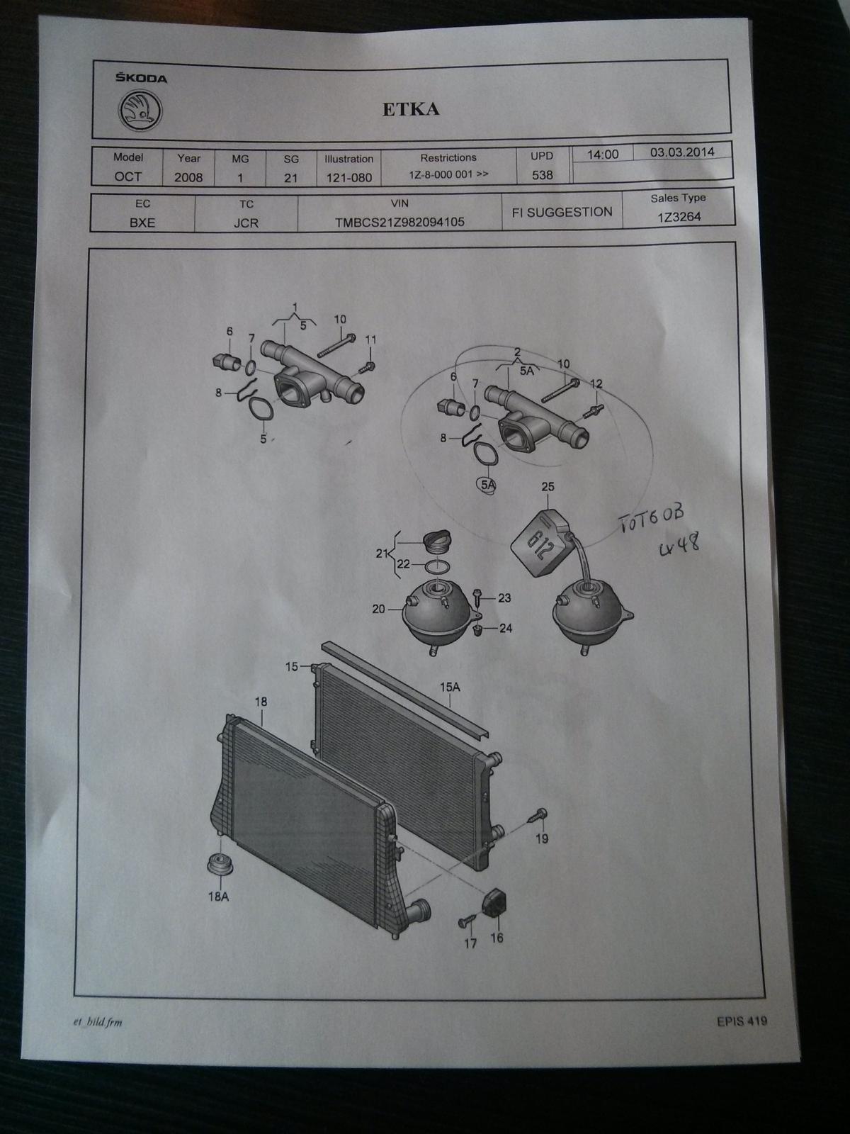

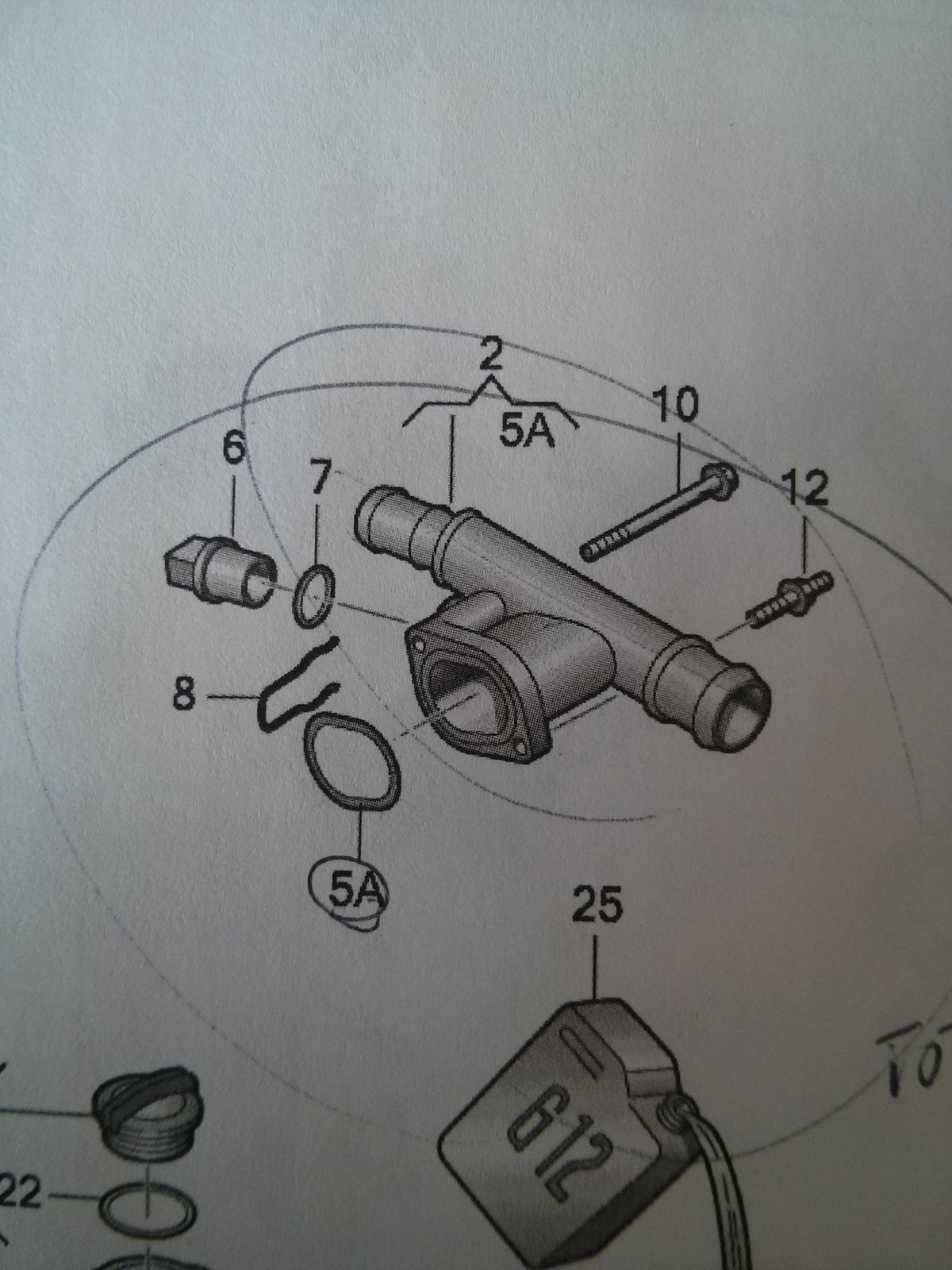

See diagrams,details, costs around £30 ish (dealer part).  The pipe come complete with its rubber washe (5A) , however I would recommend getting the rubber washer (NO.7) on blow up diagram , I didn't but may just get away with old one, otherwise will have to order it and get it fitted, more cost.   So best to get it at same time then you know its done, as it is a seperate part.
