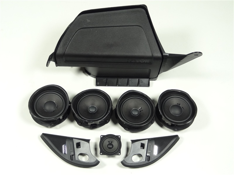

Does that mean the tweeters are the standard ones and its just the covers that differ.
One assumes the rears are 5.25" whilst the fronts are 6.5"?

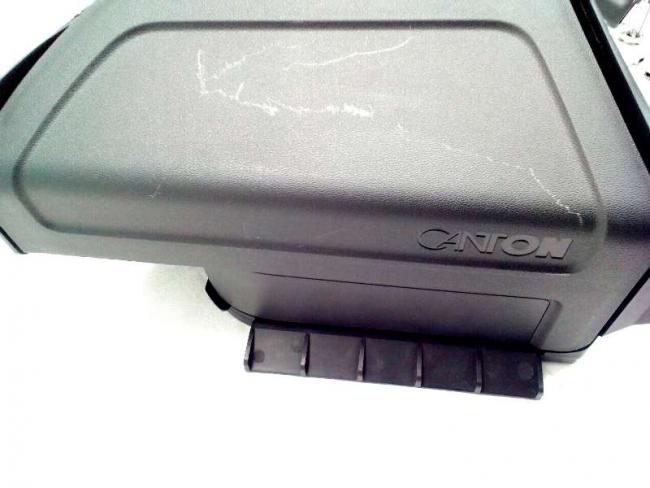

All I will say is that the drivers and sub enclosure dont look particularly expensive or high end; better than stock but probably not significantly so. Its the additional amplification and sub that make the difference.
The speakers are all manufactured by Canton, a premium German audio brand unlike the original made in China paper cone based speakers of the standard system.

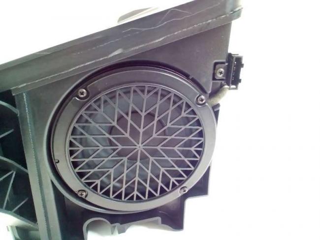

What size is the subwoofer? I thought it would be an 8" but it looks even smaller than that, maybe 6" ??

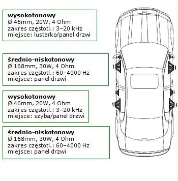

Have a look at the centre image below, it shows the speaker placement and sizes. In addition to the Sub and better quality speakers you also gain a centre channel speaker in the dash, just like I have in my A8. The car on the left shows the factory system for comparison. The car on the right option is not available in the UK.
Thanks that's extremely helpful! So the sub is only 6.5", which I guess explains why some people say it doesn't go too low.
Looking at the wattage and ohm's going to the sub I should be able to swap it for the 8" JL Audio sub I have in my current car :)
Doubt it...probably made by a VAG supplier to Canton specs. They've helped Skoda develop the solution but I doubt they manufacture it. Lets face it £400 isnt going to buy you world class quality....several K for the B&O Advanced systems in an A6/A8 perhaps but not in a Skoda.
So these are the sizes and spec of the standard speakers? Useful to know if they need to be upgraded at any point.
