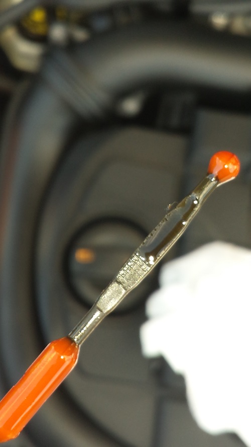

Just for visual reference, I went to check the oil level after work and this is the difference between me checking it on the day I topped it up:
After:
Mileage when topping up was 26162 miles and mileage when checking is 26582 which is a difference of 420.
Is that a sign of excessive use or am i being crazy lol  :p
Also, my manual states 1 Ltr per 2000km which is 1242 miles so if in the next 420 or less miles the light comes on then it would be below that?
After:

mine isn't supping any oil so i would think yours is excessively drinking oil if mine doesnt touch the stuff ? :) :)

How are you checking the OIl,  a Hot Check after the oil has been to 80*oC  then stopped for 4-5 minutes.
Do a Cold Check.
Stone Cold Engine in the Morning.
Oil should be above the top of the Cross Hatch when cold,  between the Top of the Cross Hatch and the Top Orange Marker.
Then when you have covered at least 10 miles, or as far as you are going try a Hot Check, that is at normal operating temperature.
Next time a Cold Check, know where the oil is before a journey.

The check I did today was stone cold after the car has been stood still since Sunday. Some weeks I don't use the car much as I don't use it for work.
So I should do a check after driving it for 10 miles then wait 5 minutes?
