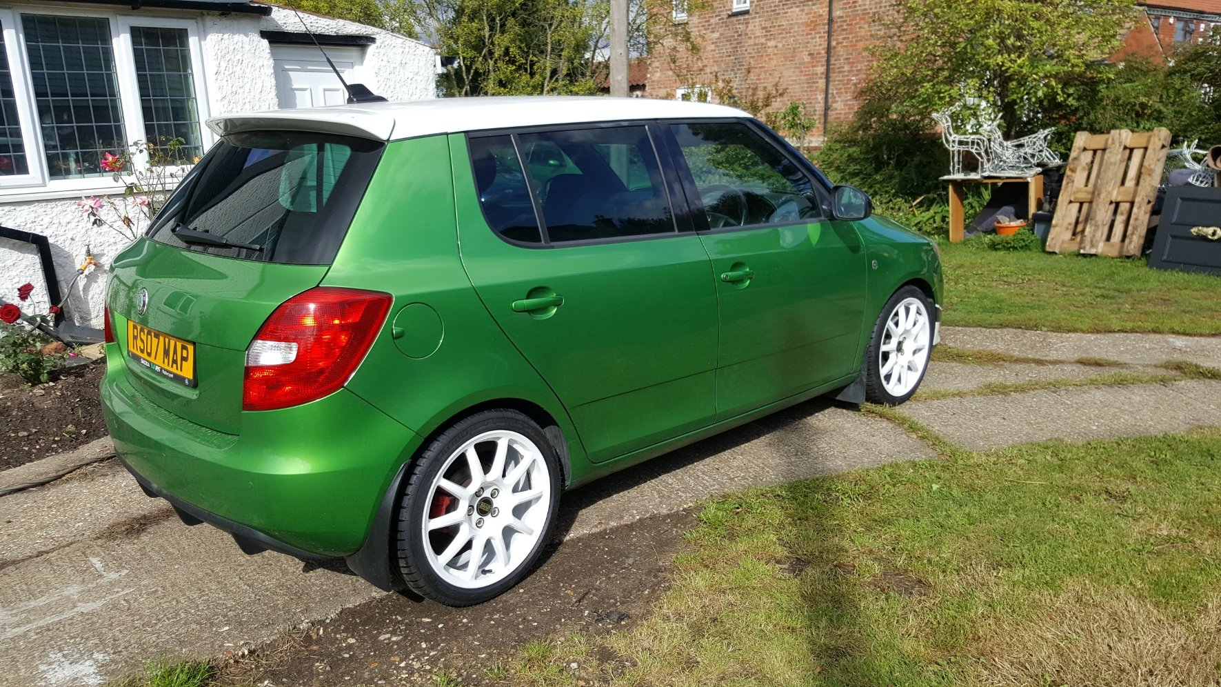

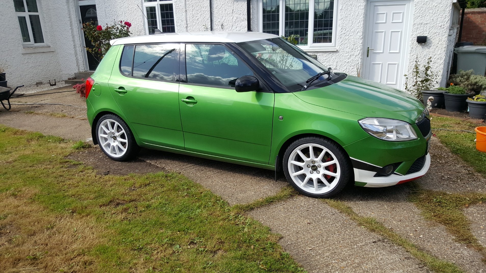

With the suspension and brake refresh happening next week, I thought I should pull my finger out and get the new wheels and tyres on. The wheels are Brimma's old Braid wheels and they have been fitted with Michelin Pilot Sport 4 tyres; I'm very happy with how they look.

I have the car back! The following work has been completed:
- New Bilstein B8 shock absorbers and Eibach lowering springs.
- New top mounts, bearings and drop links.
- During the work it was found that the front lower arm bushes needed replacing, so new Powerflex items went in.
- New brake discs and pads all round, plus brake fluid change.
- 4-wheel alignment carried out.
The drive home showed a significant improvement in ride comfort and with the Braid wheels (each sitting 5mm further out than the standard Gigaros) and Michelin Pilot Sport 4 tyres there seems to be plenty of grip available.
Overall, very happy!
