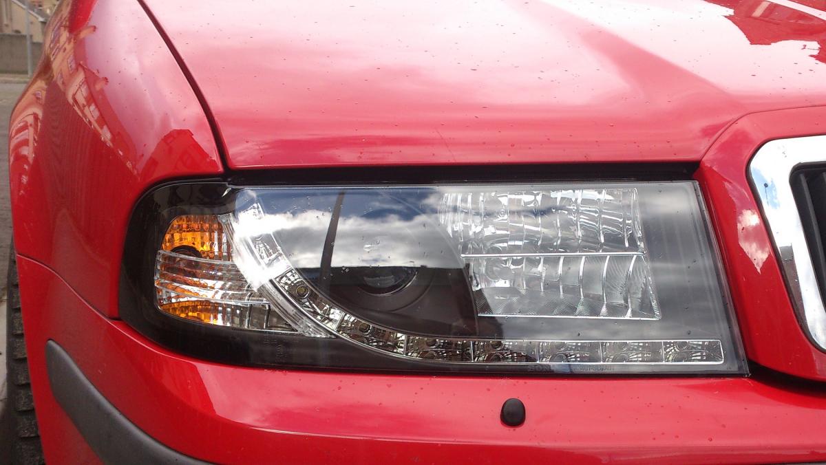

fitted, and these comes with adjusters for using in the uk or abroad

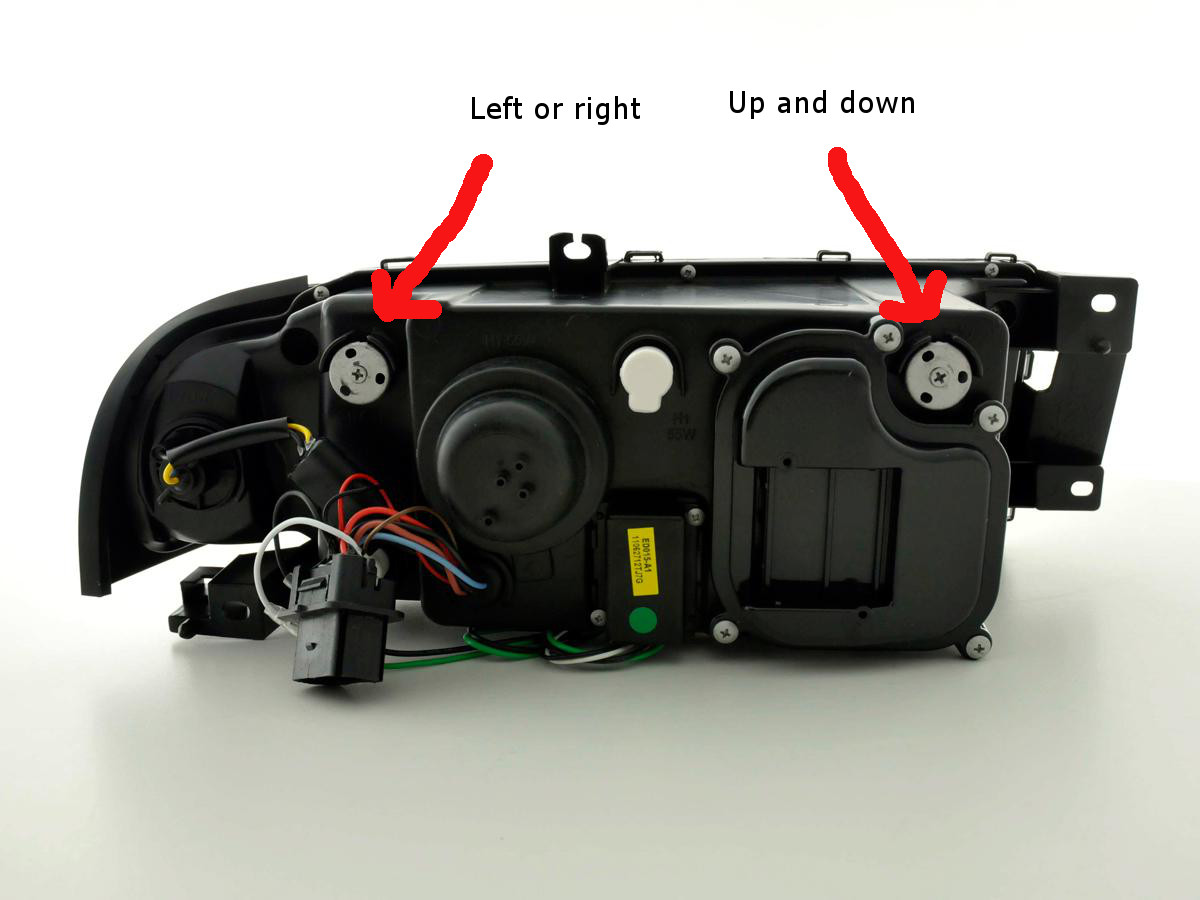

Out of interest, where are the adjusters? Mine are exactly the same as yours (right down to the embossed stamps) so seems odd you have them and I don't :S
Looking good though ;)
on the back
Those adjusters will only change the height & left/right of the beam. They will not change the kick up for right hand drive.
yea I found that out, but I am a firm believer in google and been looking into how to change the kick up, gonna have a closer look tomorrow and will let you know lol
Yeah I've got those adjusters and have tried figuring out a way to convert to RHD. However, it looks as though the reflectors are responsible for light direction, so the only way to change them would be to open the headlights up and somehow fit custom ones to convert them.
I could be wrong though... but I got bored of trying in the end :P

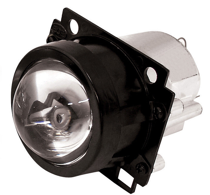

changing them is not for the light hearted lol, I heated them up in the oven to soften the seal round the glass and pulled it apart, the projector that's in it can be removed and I bought a universal projector for low beam uk from ebay and after a bit of trimming to the mount in the lights, these dropped right in..
