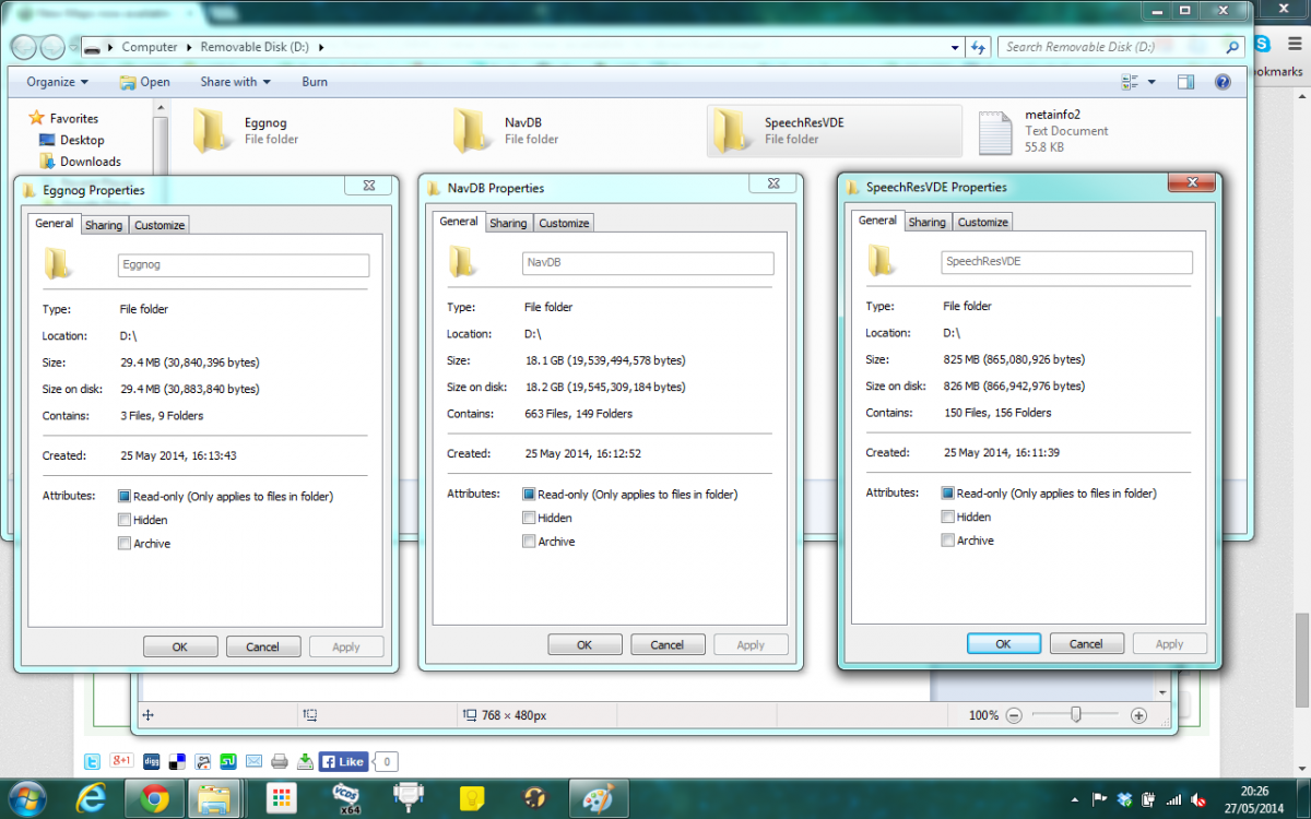

Hi, it's 2014 Columbus, i have a 32GB sony SD card (formatted originally with fat32) What i did is extract the archive to my MAC and then copy it to the card.
Pretty sure the card has to be formatted to NTFS for the Columbus upgrade? If you're using a Mac then it might have formatted to a different file type.
That will be your problem then - others have had problems when using Macs as it creates hidden files in the FAT32 file system.
You need to use 7zip on a PC to be 100% certain - I am sure there are ways round it with a mac, but don't know what they are.
For reference, your card should look like this:
