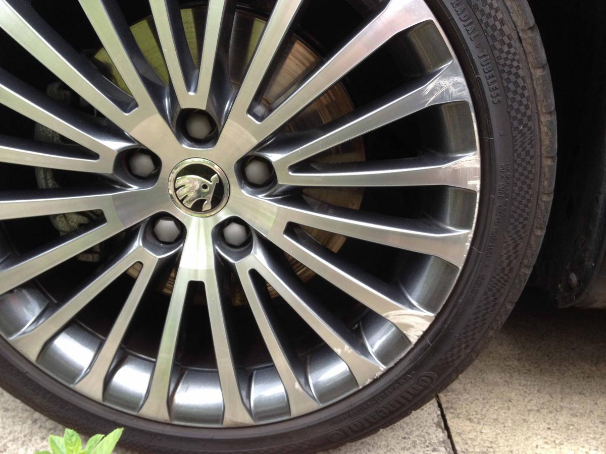

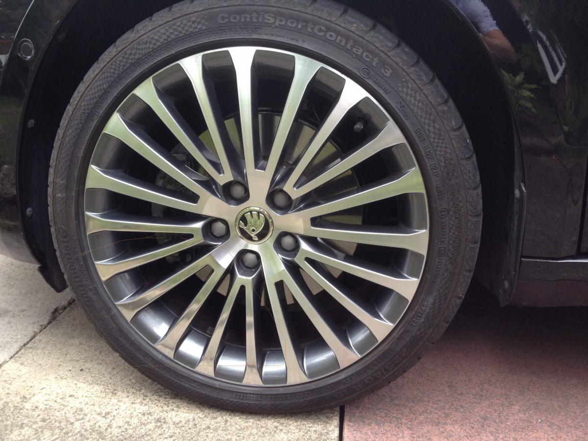

Well having kerbed my wheel, I was horrified by the potential cost of repair. Came across smart auto repairs. They had not repaired Sirius wheels before and in fairness to them they were up front about what they thought the finished product would look like, also gave me the name of another specialist repair shop who they would recommend.
We came to an agreement that they would repair a small section of the wheel and if i was not happy, there would be no charge and I could then go to the other supplier. We also agreed a very fair price to complete the job if I was satisfied.
There has been a lot of chat on the forum about alloy repair and I can honestly say I am highly delighted with the result. Have look at the photos of before and after. If you are in the NorthWest and Looking for a competent repair to your Sirius wheels do give Smartaurorepairs a chance. I found both Steve and the Guy who repaired my wheel ( Rick ) to be honest up front guys who offer a good service at a good price. Please note I think they only do a mobile service.
If you look at the Skoda logo on the hub you can orientate to where the repair has been undertaken. ( too much trouble moving the car about to line up the orientation ) :notme:
Yep, you grawnched that good and proper Raptor! Hate the sound it makes too! Anyway, it looks to be a very good refurb there. What did they charge BTW?
They've done a good job :thumbup:
Sadly for me that is a mere kiss compared to what I have done to my front passenger wheel plus my rear passenger wheel. Although I have found a company in Cardiff that do them.
Looking like new. Very impressive

The joys of polished 'diamond cut' alloys.
Manufacturers promote them as a feature. Owning a 6 year old Skoda with polished alloys I would actively avoid a car with them fitted in the future.
Great when in warranty, bloody expensive and ugly when they delaminate out of warranty.
Keep an eye on the damage on the rim directly under the 'a' in SportContiContact 3, this is exactly where water will get under the laquer and eat away at the vulnerable non-painted alloy.
Often referred to as white worm.
Good repair though, especially from a mobile fitter, most wouldn't even attempt a localised repair on a diamond cut wheel.
Is it just the angle of the photo or have they reduced the height of the rim when they have built up the wheel to cover the damage? It looks shallower around the repair than the rest of the rim...

Silver 1011 no they have not built it up I think it is the quality of my photography . I think the damage under the a was caused by having a new tyre fitted following a pot hole blow out, take your point and I will keep an eye on it thanks . Yes I agree great repair.

Get a lacquer touchup pen and paint over the nick to stop the water getting in before winter sets in and its too late.
I touched mine up with a lacquer pen, after cleaning and drying it. It will at least delay the process before something more drastic has to be done. :sweat:
Thanks lads for the ideas on a lacquer pen, is that the same as the lacquer that comes with paint touch up kit?
In my case yes.
Thanks, I have had a look at area and it is not scratched, I could remove with my thumb nail what appears to be tyre glue from the fitting.
The guy who repaired my wheel advised me to avoid wheel cleaning products as some are acidic and will remove the protective lacquer. I only use the shampoo that I use for the paint work and then finish off with car wax. Good pointer though!
