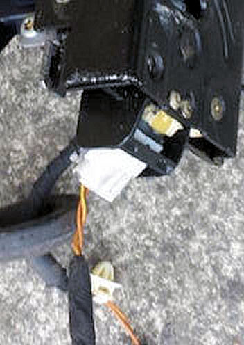

Central locking doors have more than one micro switch,and some motors inside the lock. Manual Locking doors have just one micro switch fitted inside the lock.At the bottom of the lock there is a 3 pin socket and plug ,with  two brown wires,this works the interior lights,and buzzer for lights left on signal. On Central Locking doors this socket and plug has multipins,and wires . If you look back you will see I have posted about a week ago,trying to get a replacement 3 pin plug,without success,as mine has a lug broken off. If you remove the carrier ,you will be able to put your hand up,and carefully check the plug for poor connections.The plug is locked in place with sprung lugs,so do not try pulling on the cable.I have already had this problem,on the passenger side.I have attached a photo to make it clearer for you

This is only accessible by completely stripping the door panels to get to it right?
Yes, the silver metal door carrier has to come off. Some are riveted to the door meaning you have to drill out the rivets and some early ones are just bolted on.
