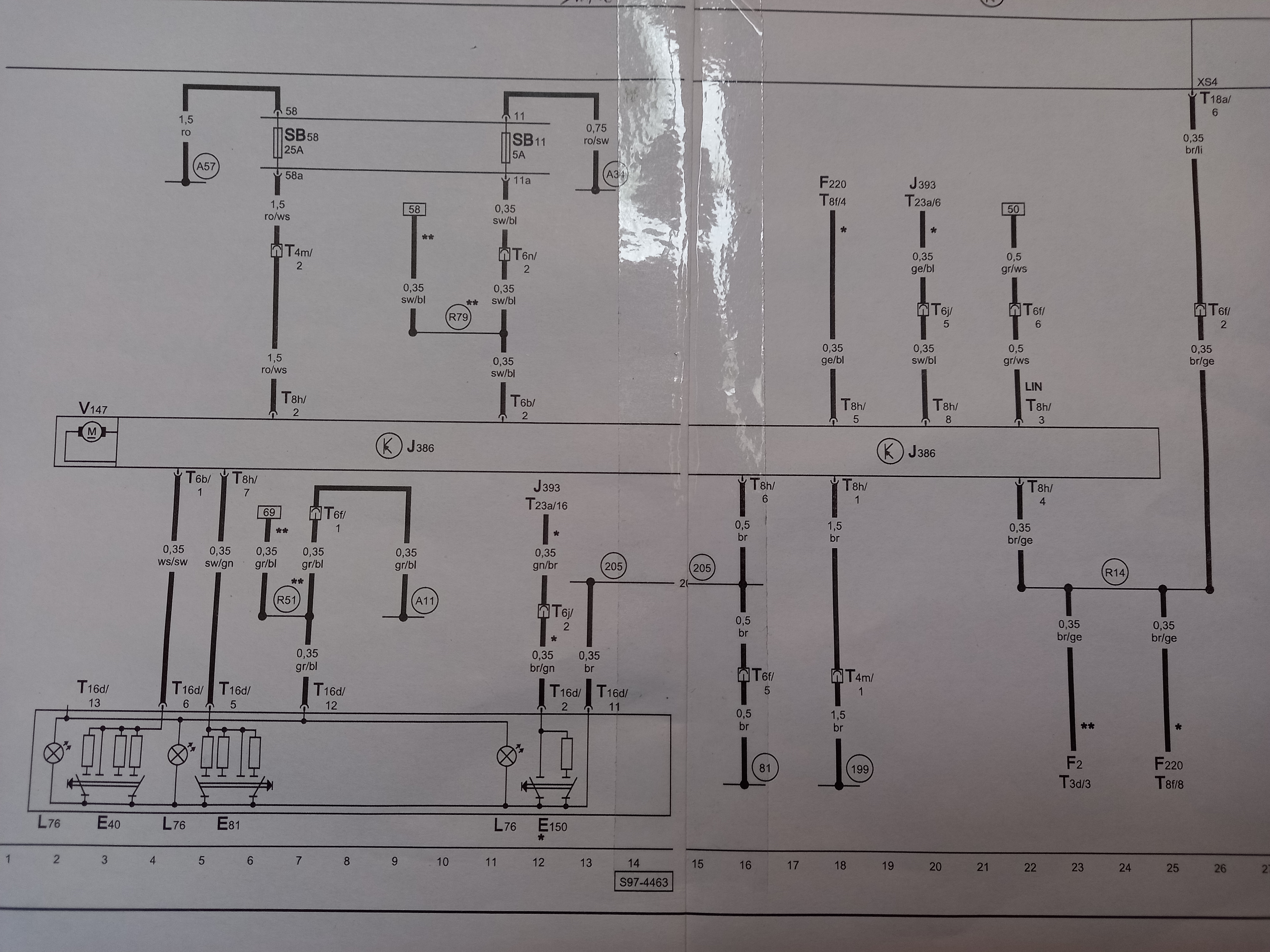

@Bazmcc to get the switches to work the right (correct) windows with the LHD motor module in place, you'd need to cross over the wires coming from switches E40 and E81 in the lower left corner of this pic to the window motor (J386) connectors. They are white/black and black/green wires.
You could also correct the direction of motion of the driver's side window by rotating the metal motor housing 180° so the label faces the other side. There are permanent magnets inside which give the field a polarisation.
The disadvantage of this is that the electronics will probably still think it is lifting the glass when it's actually lowering it, and vice-versa.  The anti-pinch function that stops you trapping fingers/limbs in the window while it's going up will likely not work (cos I can't see why it would be programmed to work on downward glass motion). Do at your own risk, and ideally tell any subsequent owners about it.
If you decide to try this, you can probably do as follows, for minimum risk of damage:
1. Defeat (simultaneously) the 6 plastic clips that hold the circuitboard section in and pull that out and clear.
2. Undo the 4 torx screws that hold the motor housing to the plastic casing.
3. Gently pull the motor housing with rotor and brushpack away, wiggling/turning the beige gear in the appropriate direction will help it come out
4. Leaving the rotor where it is, pull the brushpack carefully away from the motor housing enough to be able to turn the latter relative to the former.
5. Turn the motor housing by 180°
6. Refit brushpack, easing the brushes into place on the commutator. Take the opportunity to clean things a little first if there's tons of carbon dust about.
7. Refit motor with opposite direction wiggle/turn of beige cog to help
It's best to leave the rotor shaft fully in the metal casing, rather than pull it plus brushpack out to rotate the housing. The bush/bearing at the end of the metal housing can easily be knocked round out of position as the rotor shaft is refitted, due to the magnets pulling the rotor out of alignment. If the rotor shaft doesn't go back in right this bush tends to get destroyed as the motor housing is bolted back up.
Let me know if you want me to repair a correct module instead.
