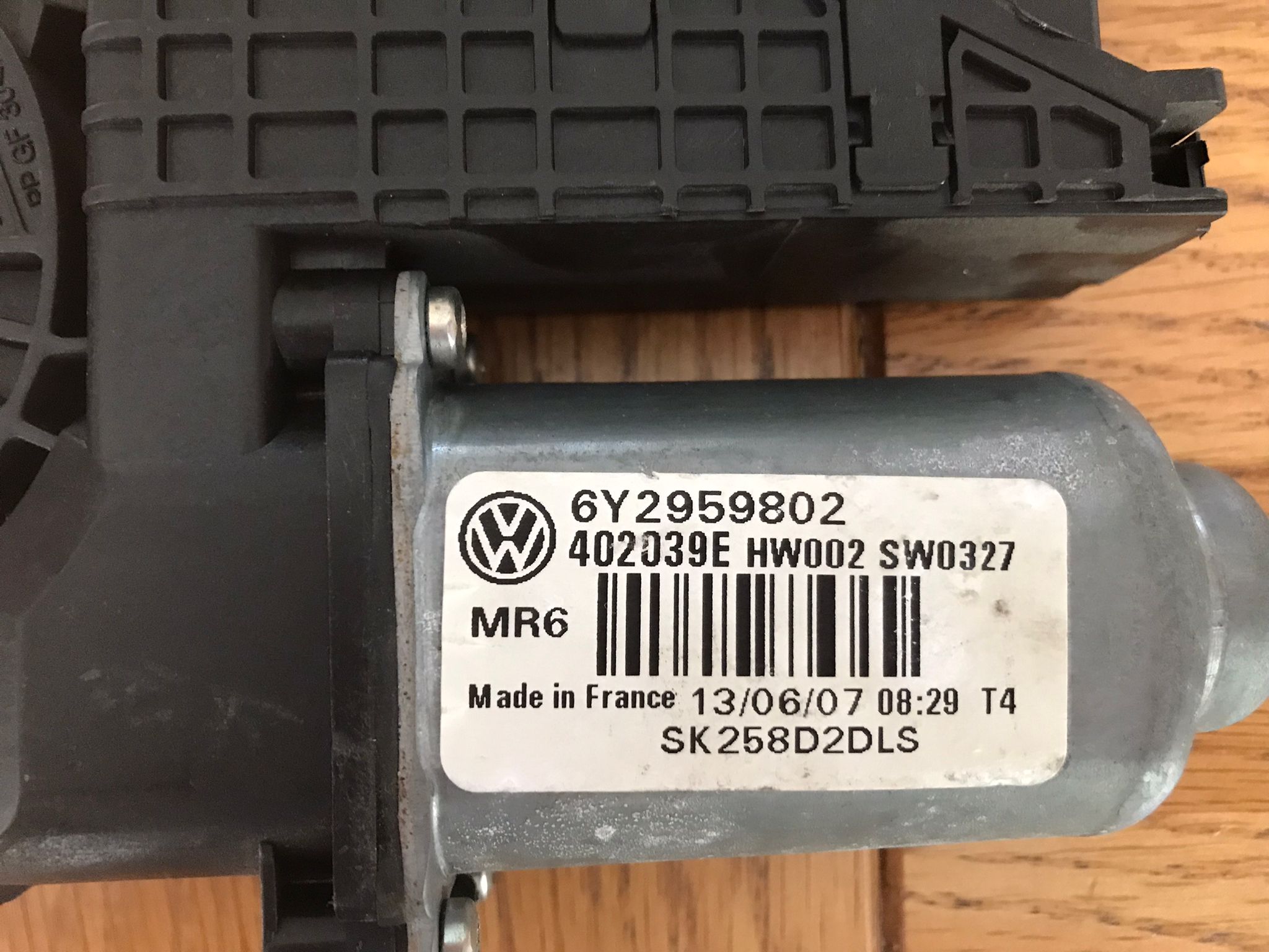

On 30/08/2021 at 13:20, Breezy_Pete said:
Hello Briskodians,
I would like to offer a repair service for some types of electric window motor module as fitted to a few Skoda models, as well as one or two VWs.
At this stage it applies only to two specific, exact part numbers fitted to the driver's side front door, as follows:
6Y2959802  Fitted to later Mk1 Fabia, from around October 2004.
6Y1959801  Fitted to Very early Mk2 Fabia and Roomster until end of October 2007; as well as 9N3 Polo and a few Transporters. (And some late 9N Polos I have learned).
Private Message me a VIN if you'd like me to check whether your car has this part number fitted.
(As described a few posts below, either of the above part numbers + suffix A on the end can also be repaired.  Also happy to try with units of the subsequent generation, with part numbers 6Q1959801F, G, H, or J.)
Note that both of these are driver's side units, the difference in part numbering is due to the orientation/positioning of the motor module on the panels they mount to.
These parts suffer a type of intermittent, progressive failure where they 'sometimes work fine, sometimes don't work at all'.  This is what I can fix for you.
I will test your faulty unit, confirm the problem, repair it to full working order and post it back to you for £50, total.
You'd post it to me (less than 1Kg so can be sent as a first class small parcel for just £3.68 at present).  I would aim to turn it round within 2 days of receipt, and send it back first class.
This is the what the part looks like:

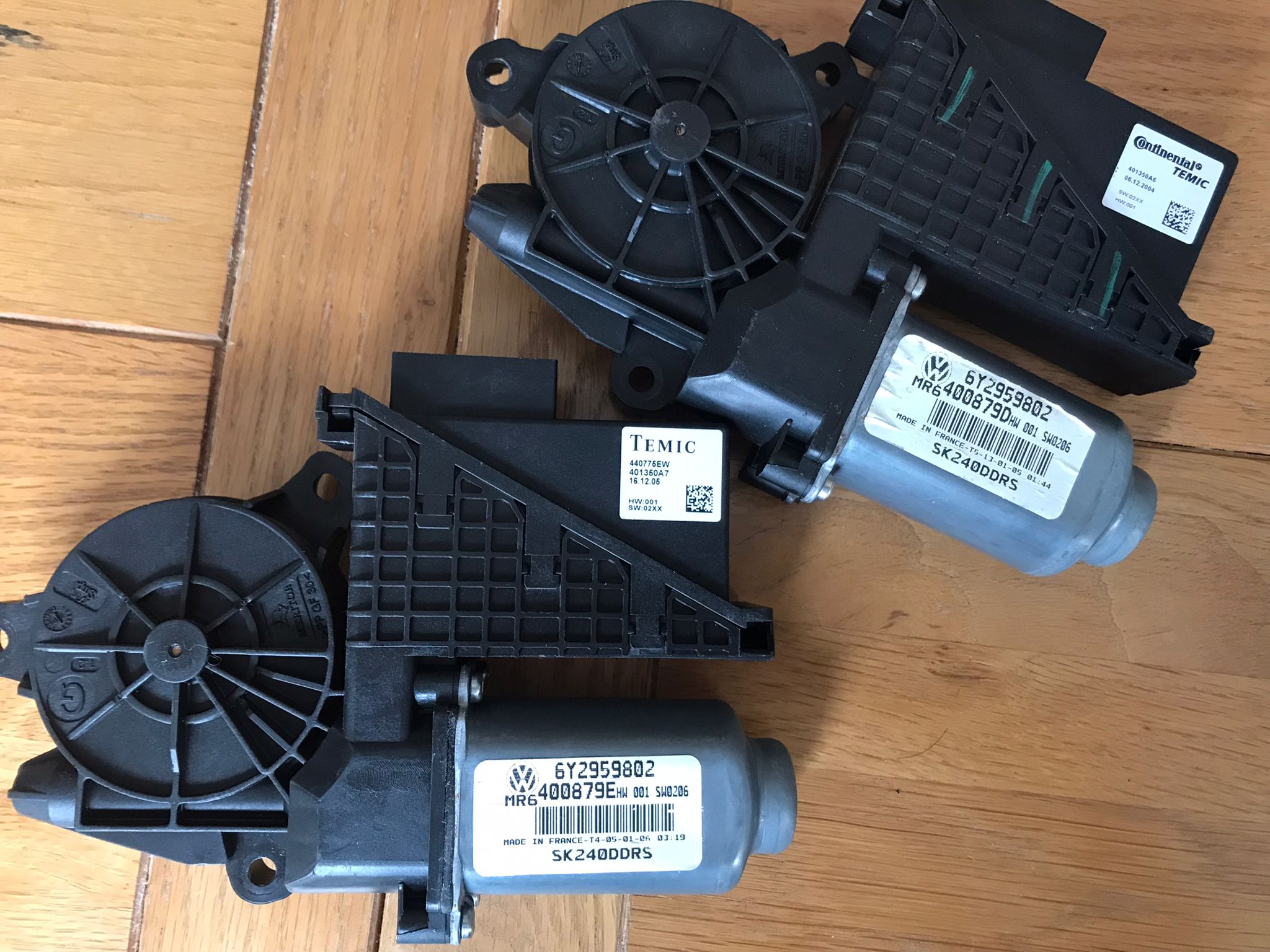

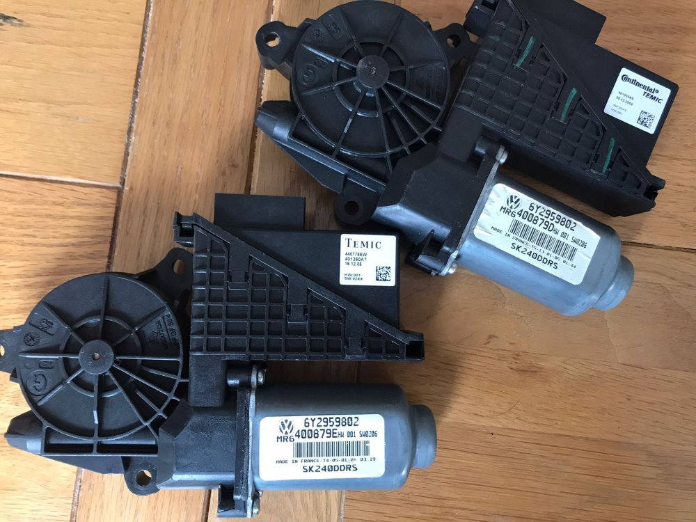

On 24/07/2023 at 10:46, Breezy_Pete said:
Yep, that figures.
Here's my current modules.  The 2 in the pic together do nothing and are faulty.  The one on the pic on it's own is the odd mismatched opposite side mix up one.
  • Sponsor
Ah, OK. The one on its own is from a LHD Roomster.
The other two are normal RHD mk1 Fabia units. Can almost certainly fix those for you.
