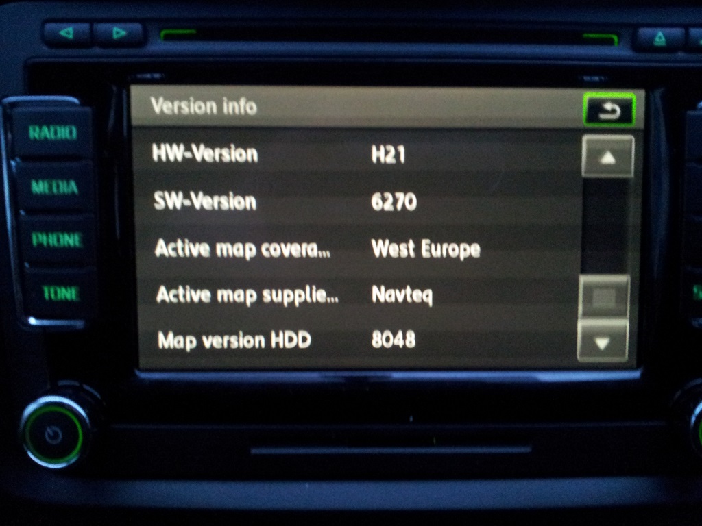

This is what my FL 2014 model came with in January as you can see both SW and map version higher than yours. But as long as you are able to start again all good and as you say get maps updated on next service under deal arranged.
