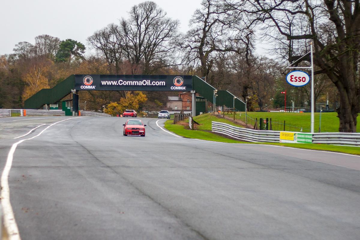

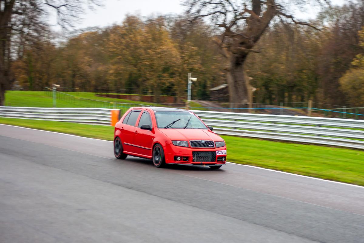

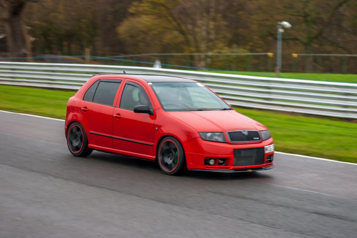

Well.... certainly had a baptism of fire at my first track day today!
On the way to the track my ABS light came on. So no ABS for the entirety of the day. Then later on in the morning the oil cooler pipe decided to rupture out of the side. Lost 1 1/2 hours whilst I temporarily fixed it by bypassing the cooler with a link pipe.
Then a couple of nice spins to boot  :notme:  :sweat:
Overall, a fantastic day though :)
Oh, and for the standard injector nozzle 'haters' out there... my EGT didn't rise above 700 degrees all day! Oil temp was also low without the cooler. As I never went over 108 degrees - although the weather will have had something to do with this I suspect.
Edited by alex_e3
