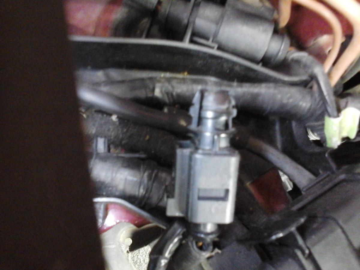

Also does anyone know what this is (see attached pics) or where it plugs in.
It is attached to the same wiring loom as the fans power supply.
I am assuming it is a temperature sender probe but is it for the dashboard instruments temperature display or for the air conditioning fan.
