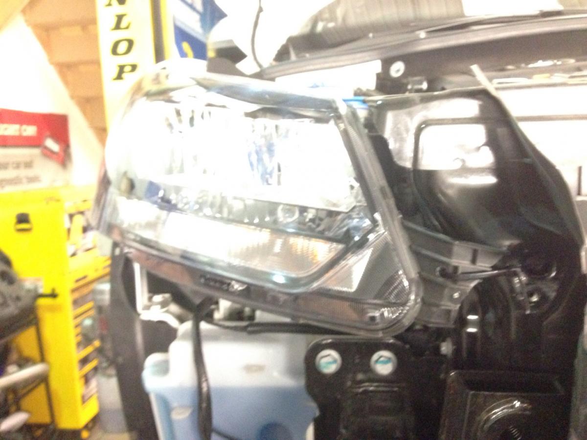

Interesting discovery, a couple of weeks ago the car was back at the dealership, I'd lost a bulb inside the headlight. It was a bumper off job to get at the headlight and left me £80 worse off, expensive mistake.
Today at Shark we discover that they have snapped the bracket and tried to cover their mistake by fastening the headlight on with tie raps!!!
I've just been on the phone to the dealership who were very apologetic, im now waiting on a call back but safe to say, I am fuming!!

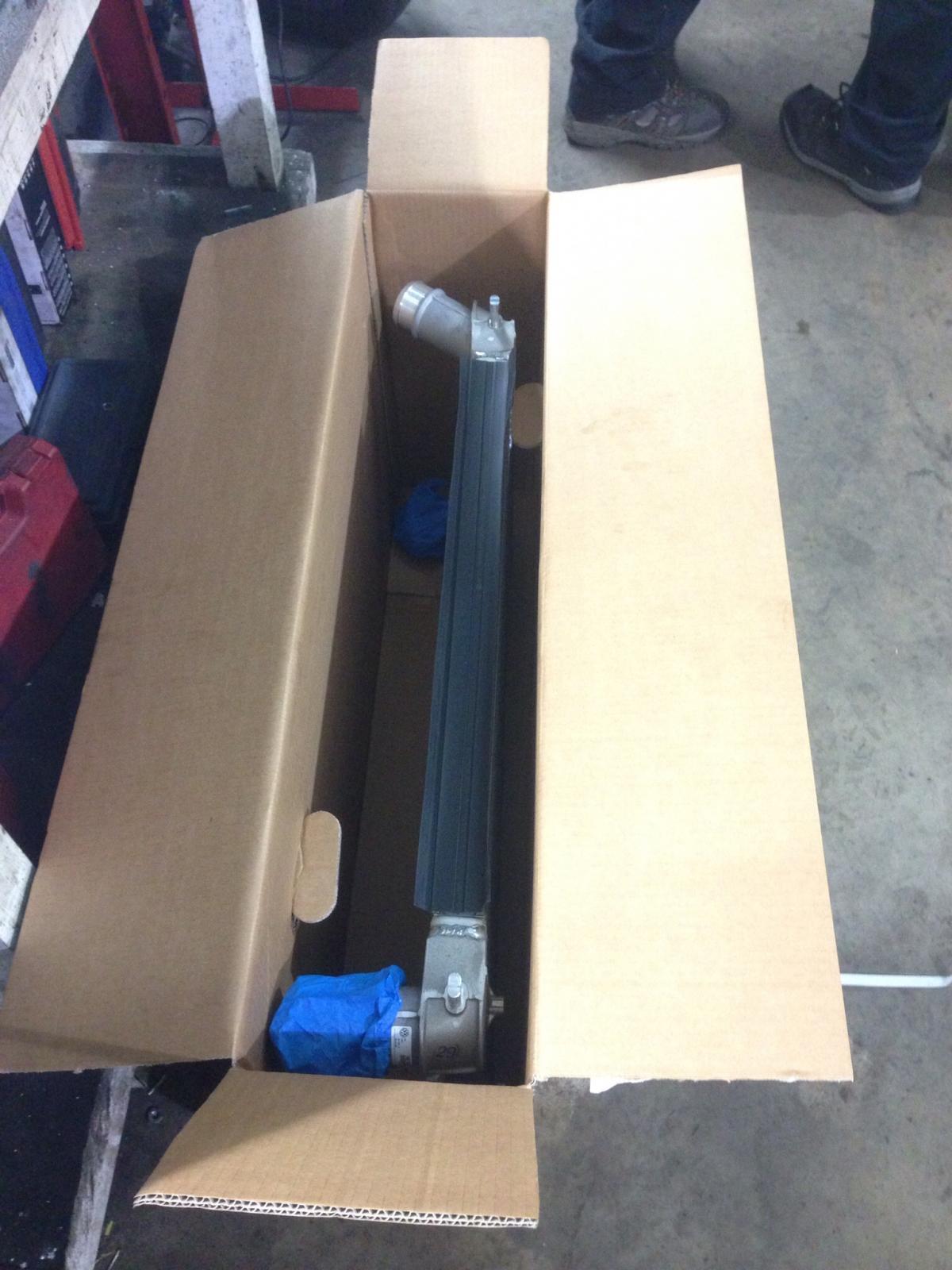

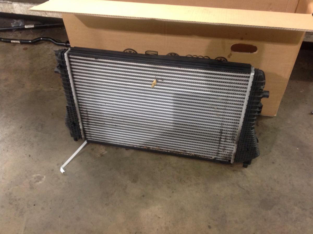

One old Intercooler
One brand new S3 Intercooler

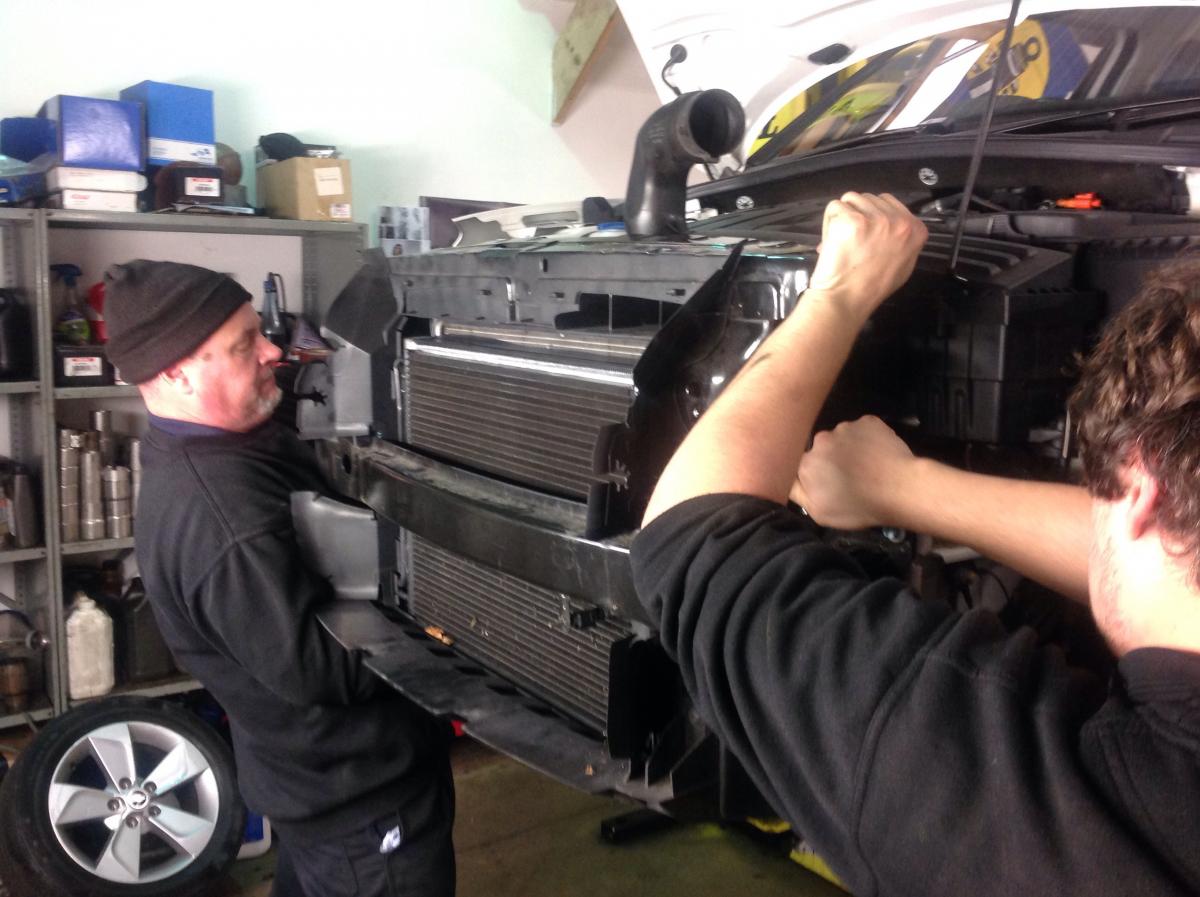

Well, back home after two and a half hours behind the wheel so i thought id give some feedback about the S3 Intercooler and Whiteline ARB's.
I wasn't expecting such a dramatic change to the car, lets start with the intercooler.
S3 Intercooler
The main reason for this was in preparation for the turbo upgrade, so although i was told you can see a 10-15% increase i certainly wasn't expecting the results we got. The rolling road was being worked on so unfortunately we couldn't get it on the rollers but the drive home has given me all i need to know beyond the figures.
The car pulls so much harder and smoother than before, overtaking, pulling out of corners and roundabouts or just straight line acceleration is fantastic. Even at speed the car pulls better than many other performance cars I've driven, i would love anyone to come and have a go as its hard to describe the transformation. The drive through Snake pass (a road I've driven many times before) was like driving a totaly different car, anyone looking at this upgrade following or with mapping, do it! :D

How much was the s3 intercooler
£300, Genuine VW part :)

Where did you get the part from a dealer
Shark ordered it for me, love how you can swop bits from the VAG parts bin :)

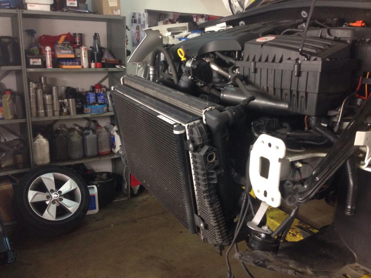

When we checked the parts numbers it was a surprise to find all the diesel variant Yeti's use the same Intercooler!
The S3 Intercooler was a straight fit and used the existing pipe work :)
That is a surprise.
So - no brackets or other work to get it to fit - just unbolt original, and fit new one ?
(Presumably after removing the crashbar etc).
I presume that's the part cost only, no labour ?
Yep, straight forward fit once crash bar is removed, I think it was £60 on top of that aswell for 2 hours labour, I'll check the invoice as it is wall lumped in with the ARB fitting.

One old Intercooler
attachicon.gifimage.jpgattachicon.gifimage.jpgattachicon.gifimage.jpgattachicon.gifimage.jpg
It's difficult to tell from the photos how much larger the S3 IC is...where would you say is the main difference - height, width or depth ?
The standard one looks a reasonable size to start with. Much better than the crappy little side-mount ones VAG used to fit on the PD engines anyway!
Hight and width they were the same, it's the density that increases, more vains = more surface area and cooling capacity, 40% more than the standard one :)
