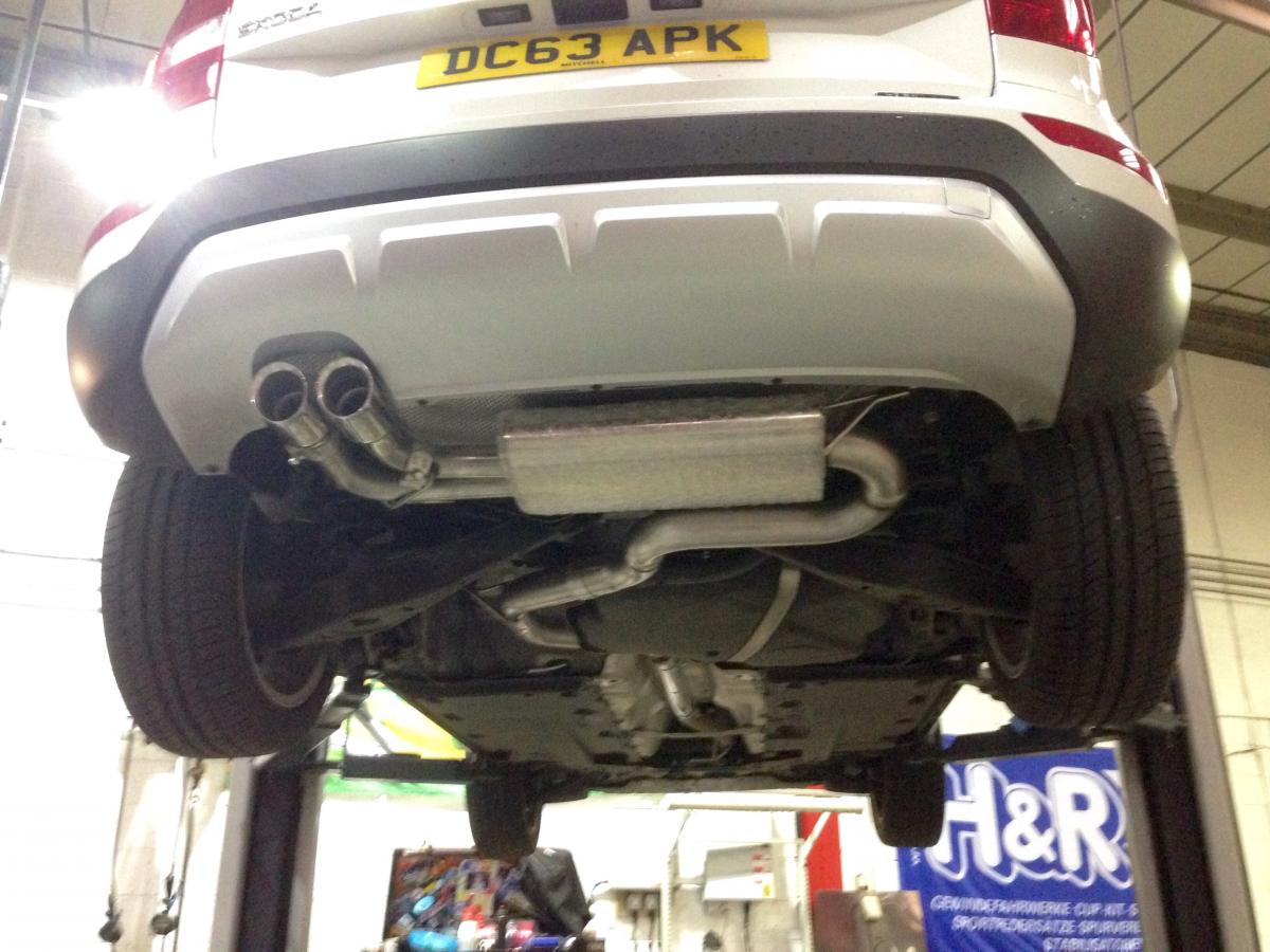

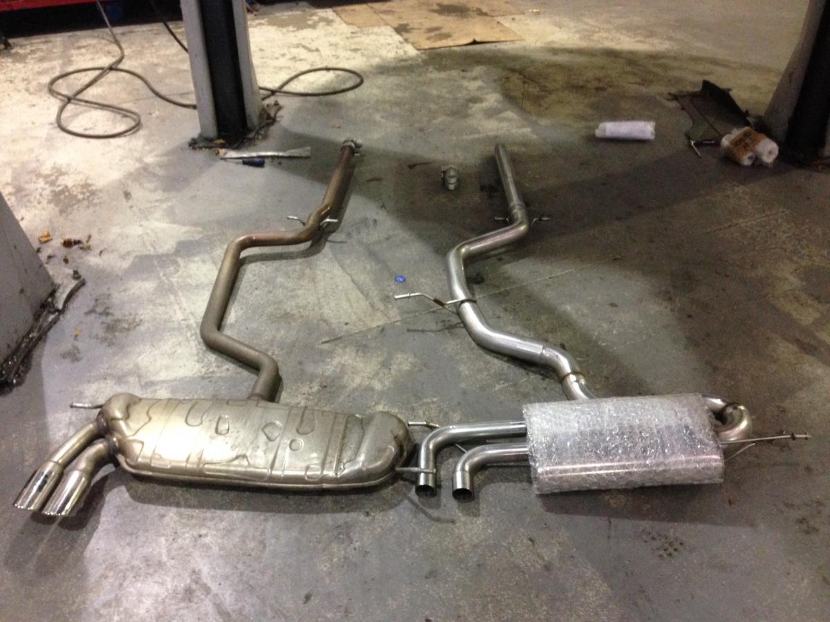

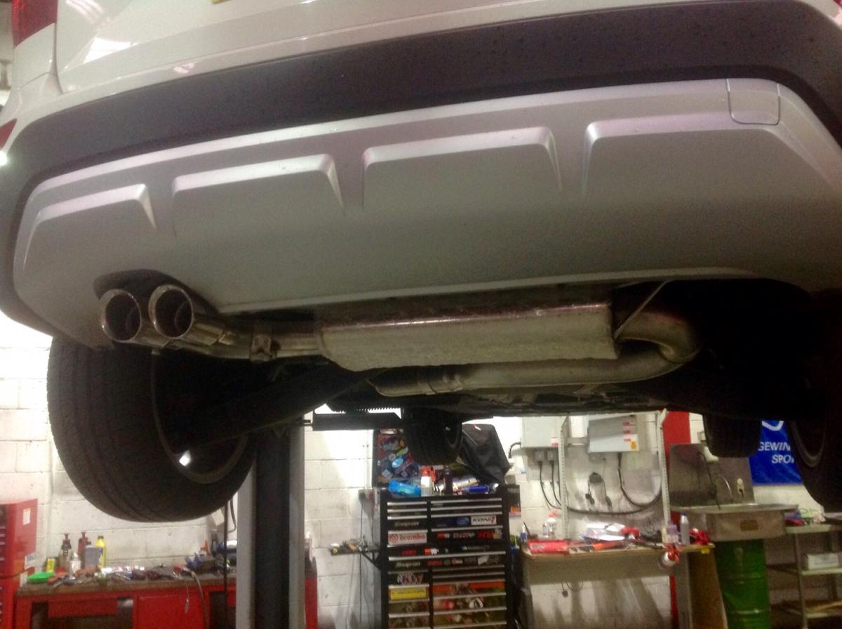

Comparison between the standard and Milltek system, we tried to looking at fitting an anti lift kit but there are non available that fit yet :(
Milltek System is in place, more or less a straight fit with just a little adaptation of a piece of the trim under the car due to the exhaust width, plus we've maintained the OEM look, can't wait to hear what she sounds like :)
Don't get your hopes up too much regarding an 'awesome' sound, I doubt it will be much different to standard

I've just had a listen and it's just what I was hoping for, a bit more of a refined sound but not loud, quieter than I was expecting to be honest. It's just going on the RR, they needed a test car after its recalibration so I get a free run :) I'll get some film of the sound under load :)

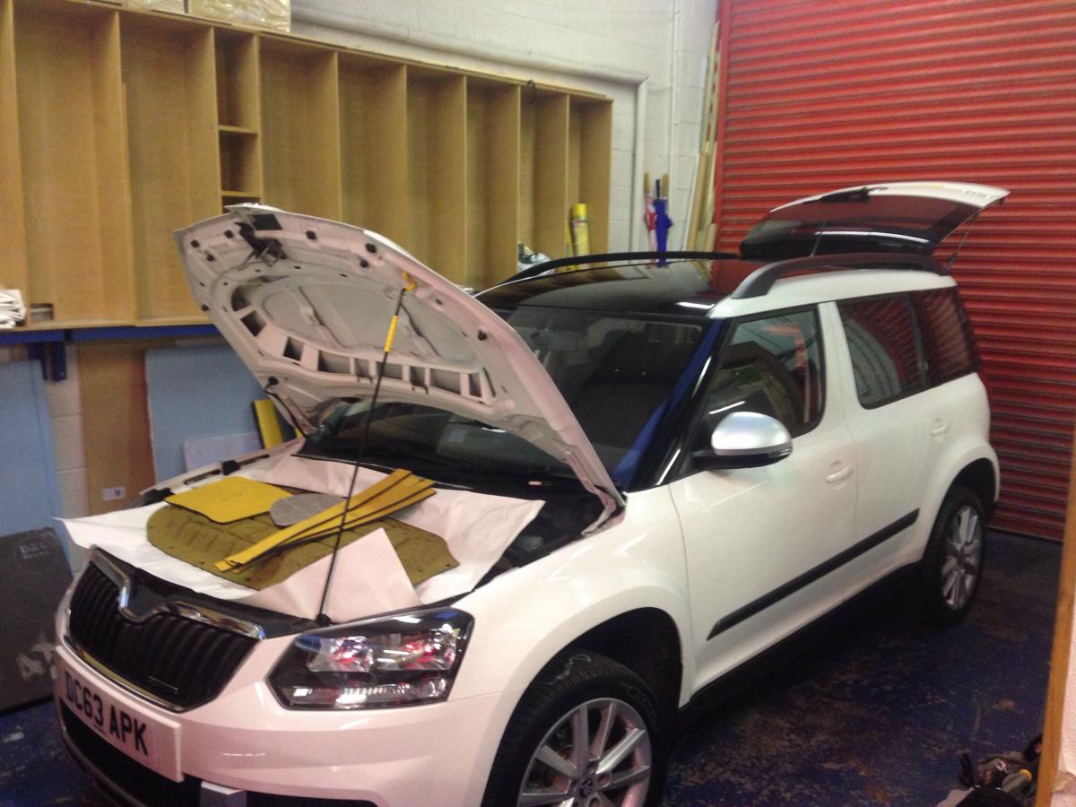

After the morning at Awesome GTI it's the next up for Sharky, an install of the Noise Killer kit. I'll let you all know the results but it should add to the quality feel of the Yeti.

Well here's the feedback after a couple of hours driving after all today's mods, first up:
Noise Killer:
What a difference, this has exceeded all my expectations, on the motorway and around town the car is sommuch quiter. Engine noise is massively minimised leaving the car sounding much smoother and refined. I would reccomend this to anyone, it's made a car I already loved even more of a joy to drive.
Milltek Cat Back - Non Resonated:
This is one I went back and forward on for a long time, mainly down there not being a system specifically for the Yeti and not knowing what the cabin noise would be.
The system for the Mk5 GT TDI fit perfectly, a small piece of plastic had to be trimmed but the exhaust itself fit perfectly. The engine note is no loader than standard either in or outside the car, but it is a much nicer refined/sporty sound. I'm over the moon with it, anyone with the same concerns I had, fear not and go for it :)

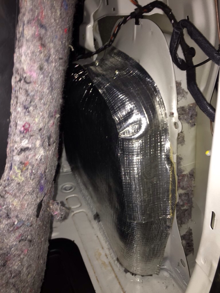

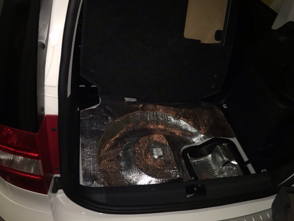

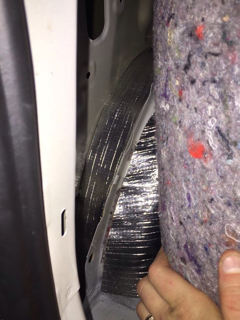

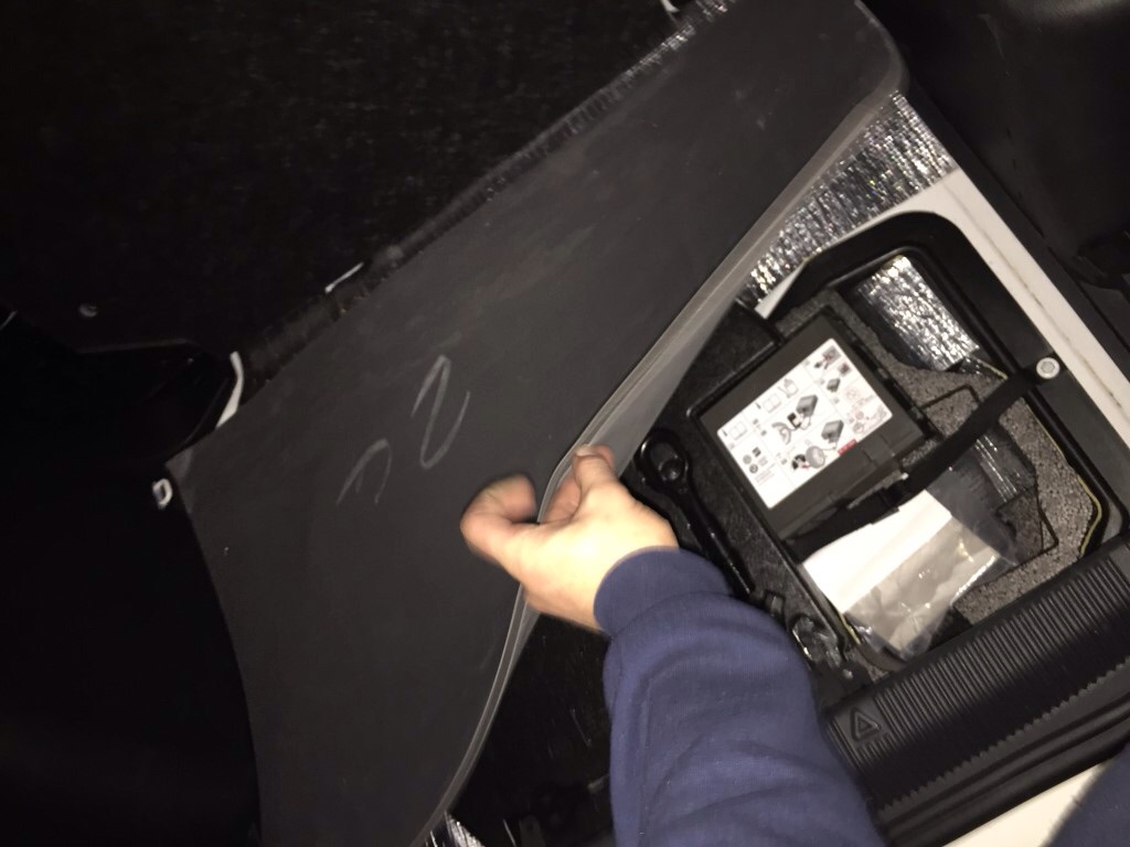

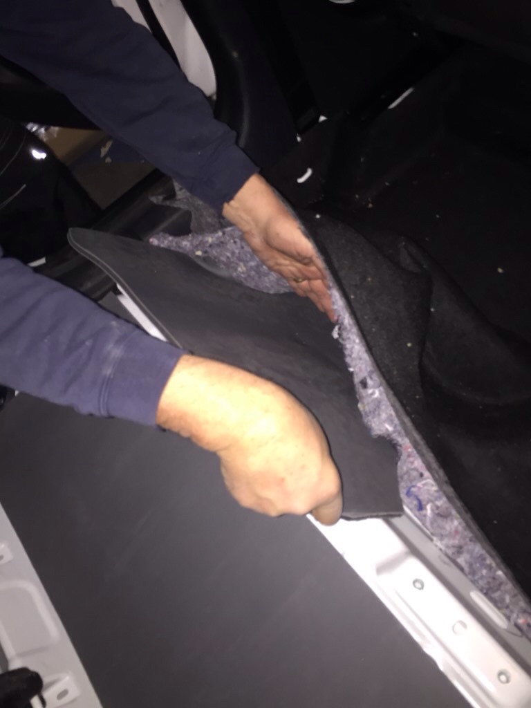

The Noise Killer kit is fantastic, its transformed the refinement of the car with engine noise almost eliminated in the cabin. I had it installed at Noise Killers offices on Oldham, it was £90 and for the amount and quality of work was worth every penny :)
The standard brakes are actually pretty good and more than adequate for road use, the Tarox pads have made them even better. The 312mm upgrade will be needed once the turbo upgrade is done and especially if i want to see any track action :)

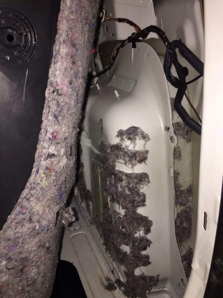

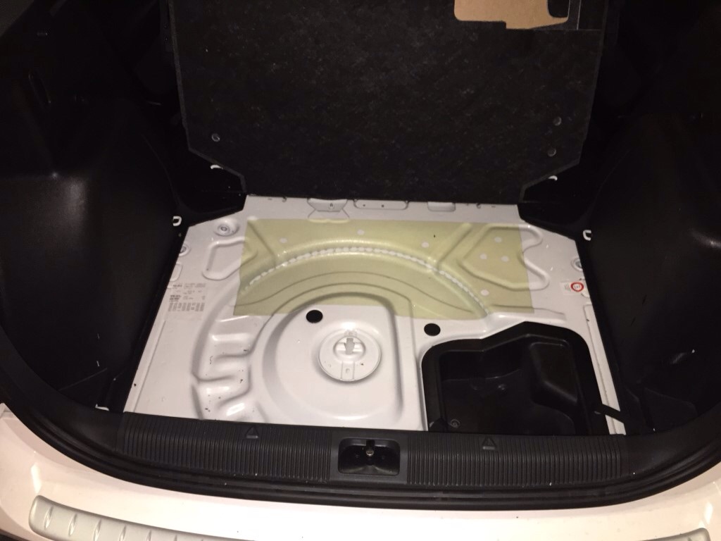

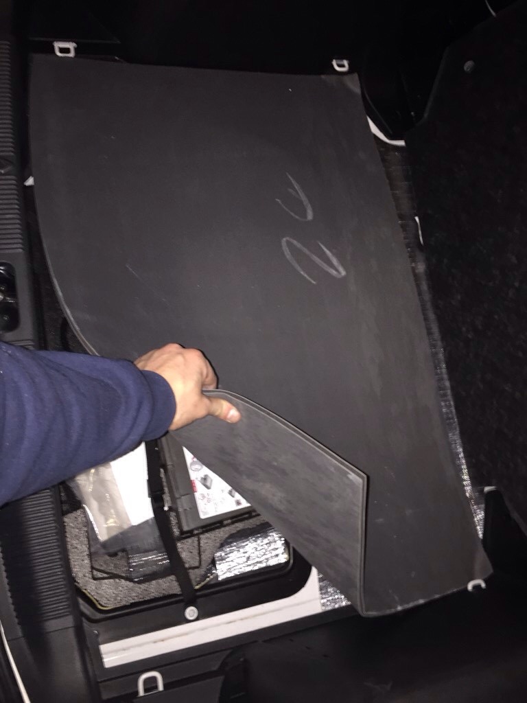

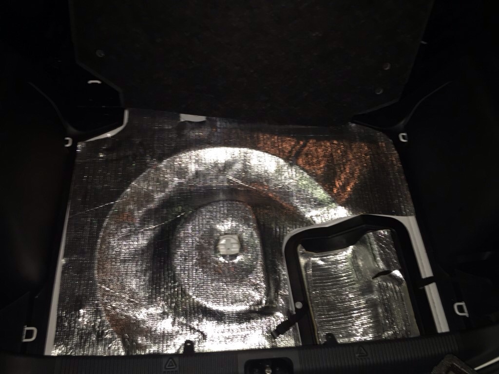

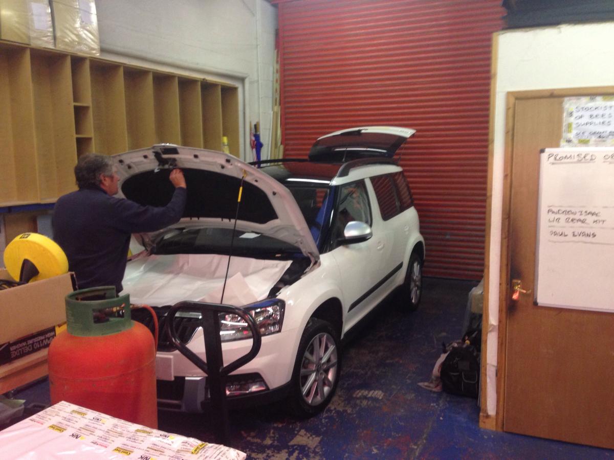

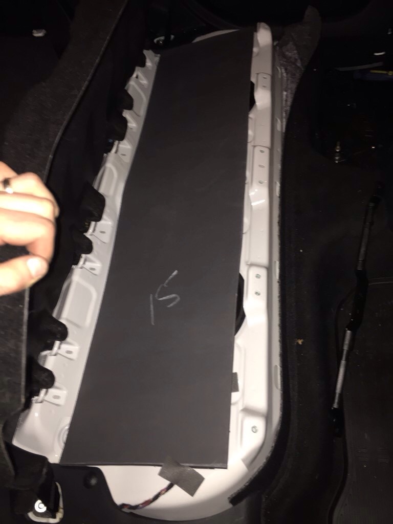

Here are some install pics of the Noise Killer kit going in, gives you a good idea of what's involved :)

You could always order the kit and have a crack at it yourself ;)
The noise killer looks like a good bit of kit :) shouldn't be difficult to fit.
How heavy is it?
How heavy is it?
The whole kit can't be more than 4kg at a guess, trickiest bit looked to be un-bolting the fixing bars for the rear seats.
