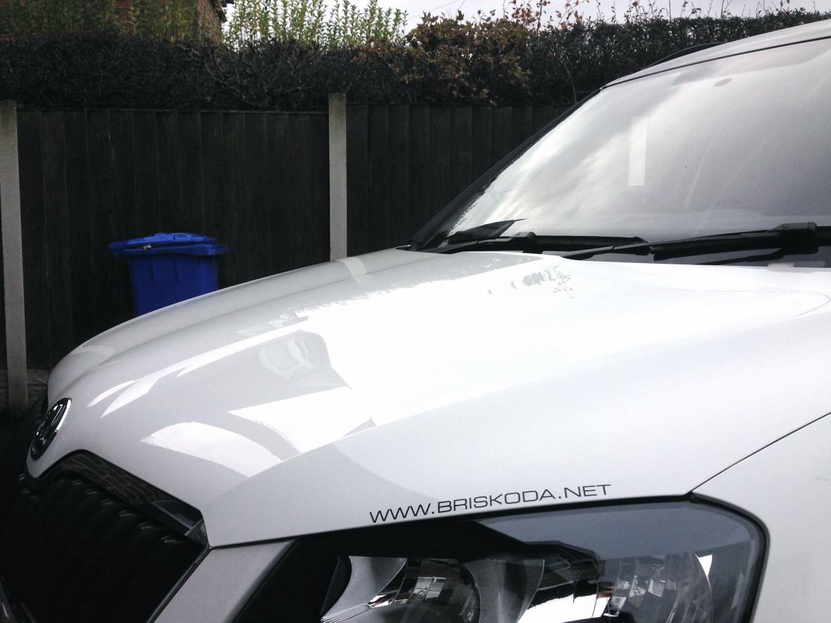

Time for Sharky to have a treat, Meguires clay bar then a polish ........ If this rain holds off!!

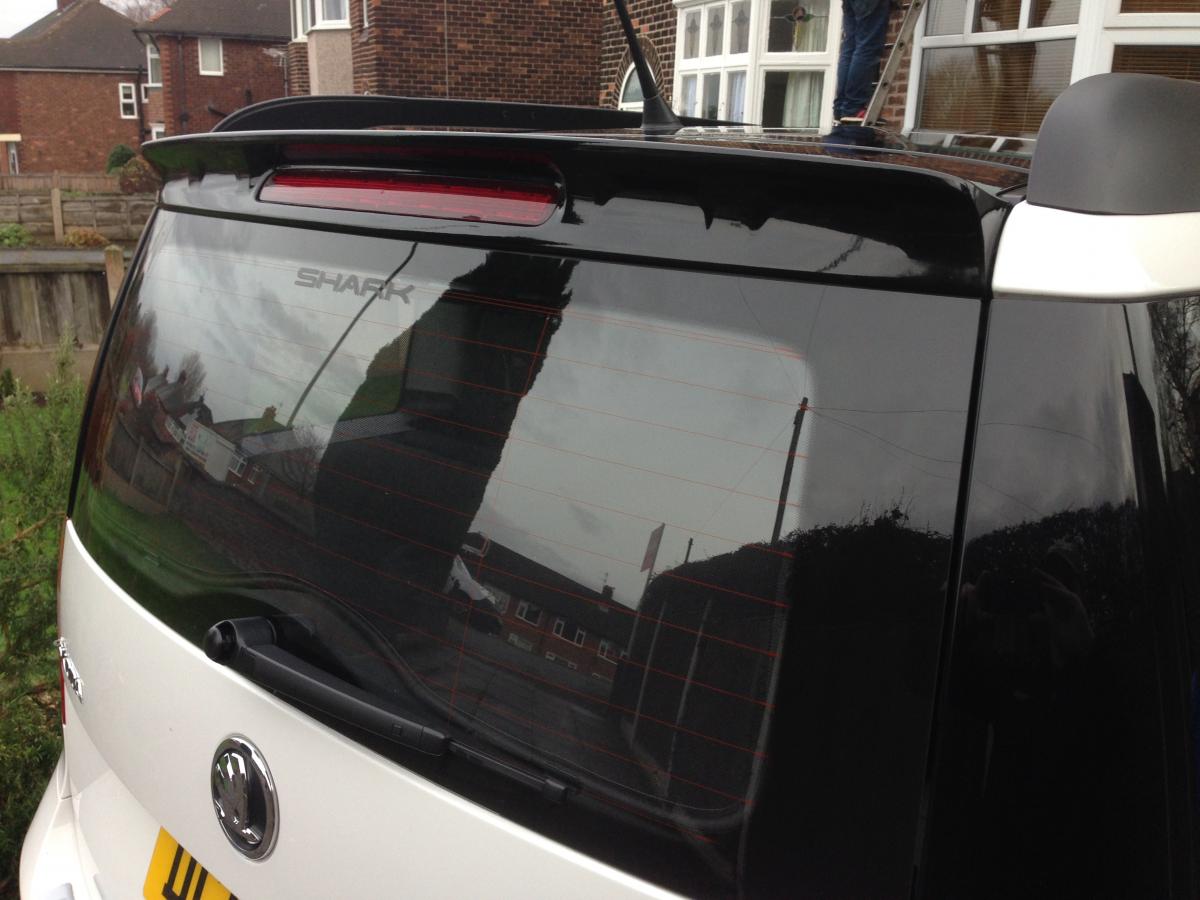

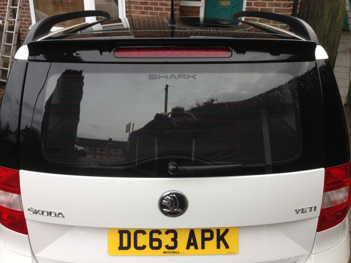

Sharkys new spoiler fitted then clayed and waxed the paint work, looking rather good, Eibach's going on tomorrow.    :clap:
post-120571-0-99490600-1418744075_thumb.jpgpost-120571-0-94267700-1418744121_thumb.jpg
post-120571-0-05739200-1418744540_thumb.pngpost-120571-0-66097500-1418744571_thumb.jpg
Looks great...!!!! I love the look of this White Yeti aka Sharky...:)
Well done..!

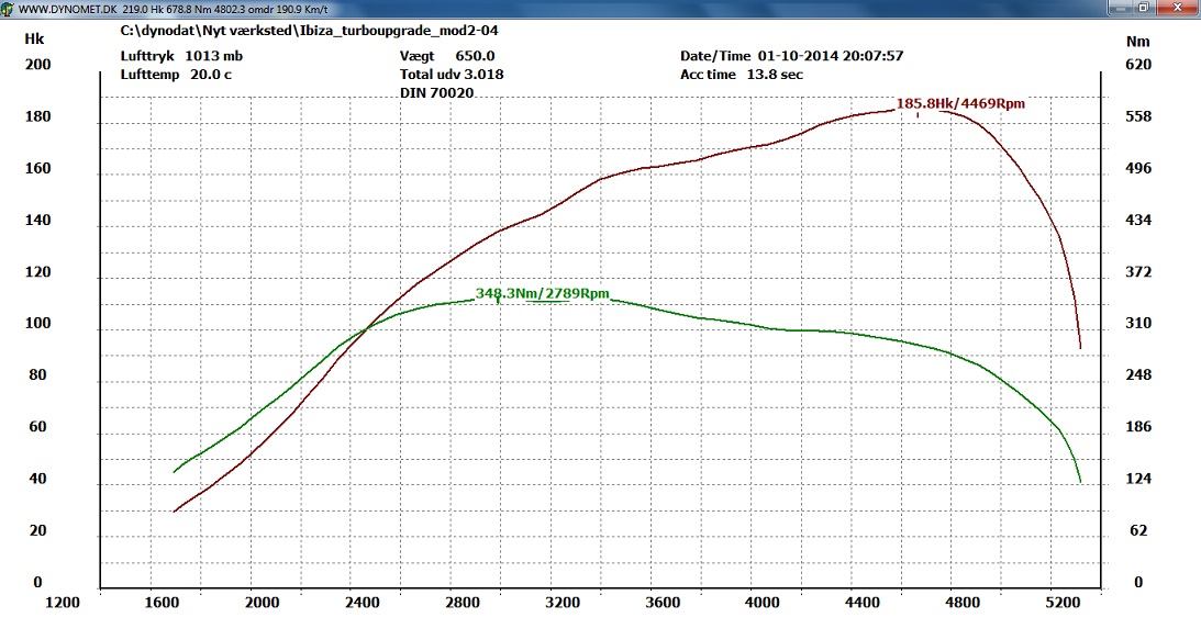

Exciting read, WD Tuning in Denmark have done a turbo upgrade on a Seat Ibiza 1.6tdi, heres the translation from their Facebook page:
Turbo Upgrade of 1.6 TDI CR
"Here we have a Seat Ibiza which has been our upgrade turbo .
The car was born with 90 hp and 240 nm.
The file we have rolled with here is a very mild tuning - there's more to download ..."
There first go at mapping produced 185bhp and 348Nm, can't wait to get mine done now :)
Heres the graph......
Looks quite a progressive plot. :)
If Shark put together a nice curve like that ill be very happy :)

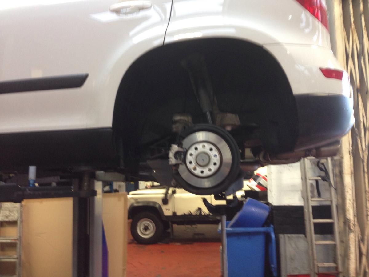

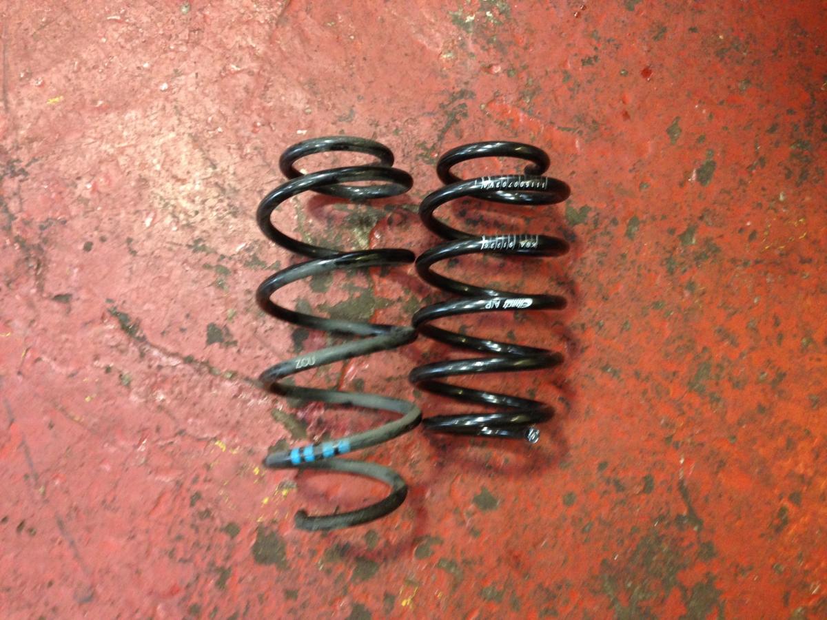

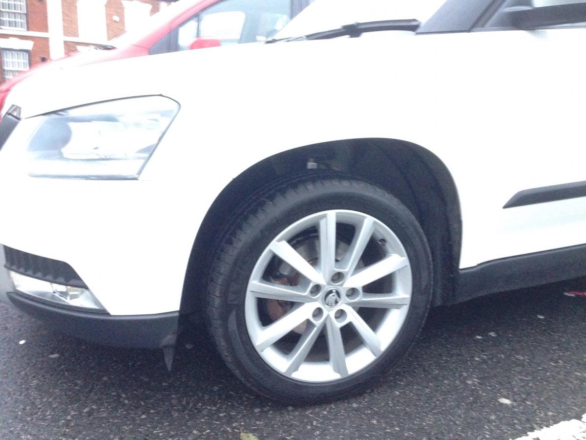

Eibach Pro Kit is fitted, took longer than expected as one of the front hubs were seized on the drive shaft!!
Even though the Yeti Greenline is lower as standard, there's still quite a difference between them and the Eibach's
And the final result :)
post-120571-0-98231000-1418831771_thumb.jpgpost-120571-0-34537300-1418831789_thumb.jpg
looking good!
Get those calipers painted black! :p
looking good!
It's on the list :)
It's on the list :)
should have done it while you fitted these :)
