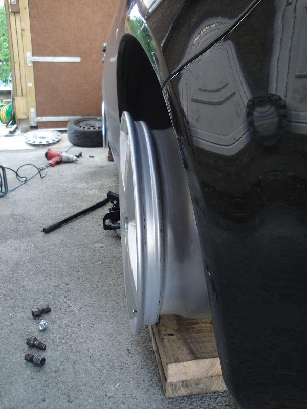

Bit of a test fit of various wheels, can't really do it on the drive due to the slope so the pictures are not much good:
Some imagination clear required... I'm leaning towards the Ronals for the summer and the Ibiza FR for winter... but I'm not sure if I will still like them if they were all silver and sparkly... the scruffy look quite suits the car :P
Ibiza wheels look good mate, did you get my pm, forgot to give you the centre caps
FR ones or Sport ones? Not a fan of the Sports.
Fr ones definitely mate not keen on other two :)
