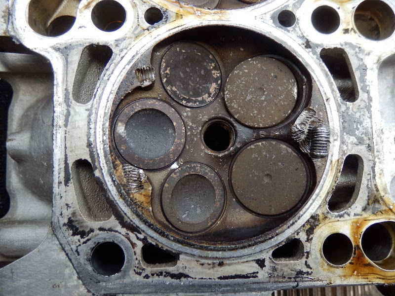

Looks like head + pistons to me.
Been following your progress.... Gutted for you :(
Ouch! What's that bolt thread that's done the damage?
Fark, what's happened there mate, similar to the combo issue I had just managed to get further down the engine. Absolutely gutted
Offcut of the bolt I used to block the hole on the BJX TB. I cut it off in the garage, but it must have stuck to my clothes (guessing hot bolt + fleece = melty sticky) and ended up in the cooler piping or intake I recon as I was working outside on the car. Its an old bolt I reused from my pot and had that green corrosion OE bolts get.
Had the bright idea of fitting the TB off the spare manifold as that has a proper connector still and is easy to block off... too late though.
Recon that piston is shot?
Oh and on the head pic the bolt offcut is still there, far right. Had to pull it off with pliers.
